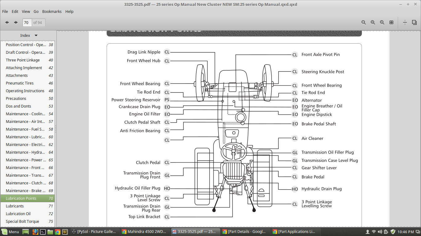

I got the same problem on my 3325. I'm going to pull the cover off when I get time and chase those linkages down. But there is no lube point mentioned in the manual.
   / Mahindra 4500 2WD #12
Theres not a lube point that exist.. over time moisture build up will start to seize the handle shaft that goes through the housing... about 95% of the time it can be handled from the outside... take a picture each step you go for reference when you put it back together... then tear down each part of that 3point and clean it up well.
