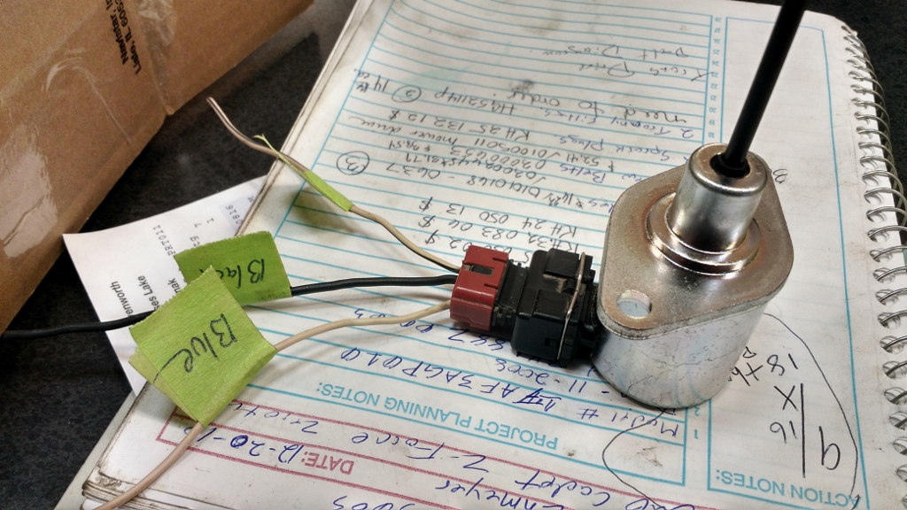

A recent exchange with a parts supplier suggests the burned and frayed wires actually go to the engine stop/kill switch...not sure if this will stop it from running but I'm guessing so.
   / Mahindra 5010 after Report -- 3 1/2 years running
#14
The offending part. Notice the burned connector.
The replacement with a Mitsubishi connector from the junk yard. Only problem I see is the Mitsu used smaller guage wires and the 10AWG wires on the tractor suggest they have more current or need more, going through them so it's possible the wires may be too small (about 18AWG) and may burn up.
Seems Mahindra doesn't sell the part so either rig something up or buy a $400 wiring harness.

That seems to be just a Solenoid Valve, if it is designed for the smaller wires then , that coil probly pulls less amps than your older one.
If the new one fits, and works, I would not worry about the smaller wire size. Just tie it into the larger good wires left from the original wires.
   / Mahindra 5010 after Report -- 3 1/2 years running #16
What burns coils up is keeping the moveable part from completing it's full travel. The coil draws a large current trying to pull this moveable part into place within the magnetic field. Once the piece is fully seated, the coil draws quite a bit less current. If there was some rust or crud keeping the fuel shut off rod from fully seating, that could cause a fire. But, one would think a fuse would have heated up and dropped the voltage to the coil. So, you could have other problems besides a few burnt parts. Sorry.... :)

Replaced the shut off, got tractor running plowed snow and now the tractor won't shut down!!!!
Cut the wiring to the shut off, no go. So now I'm going to shut off the fuel and hope that works.
#18
OK, got the fuel shut off and the tractor died after several minutes. Killed ignition and put it away. It's dark and I'm leaving in the morning so I'll have to come back another time (next week) and pull the shutoff and see if it's working and then look at the wiring to see if maybe the wiring was wrong.
Of course I also have to bleed the fuel system now too Grrrr
   / Mahindra 5010 after Report -- 3 1/2 years running #19
Again, probably crud/rust in the shut off cavity in the injection pump. ' Usually ', injection pumps have a small screen right where the fuel line hooks up to the pump. This is to make a final effort to stop anything bad from getting into the pump, but won't stop moisture. Water can accumulate in the shut off valve area and cause rust/scale to build up. You may be able to clean out the shut off valve area inside the pump. You could also install some type of valve in the fuel line going to the pump which would shut the thing off. Most diesels had mechanical shut offs in the past, the electrics are something new. You need to address your water problem someday, too. Water in your tractors fuel system is like an STD, if you are doing your job you should never find it there.
