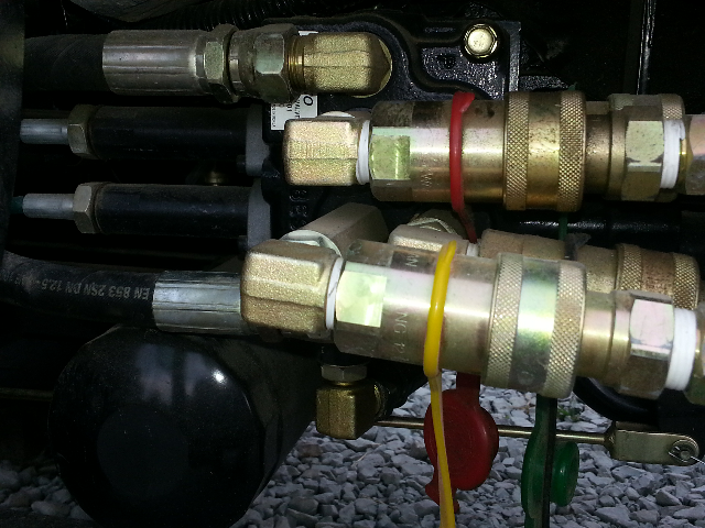

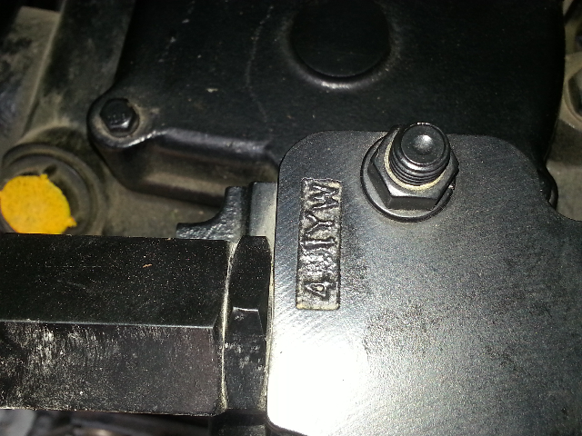

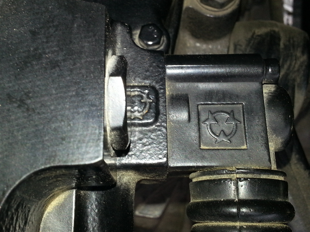

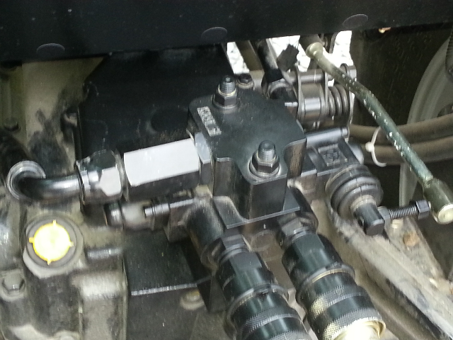

Could not find any letters on the valves. I took pics maybe that will help to know what I have. I am a visual learner. If you can guide me it would be appreciated. The solution I assume will still allow the rear remote to work normally when splitter is not connected.
Thanks
Bob
hat I have.
