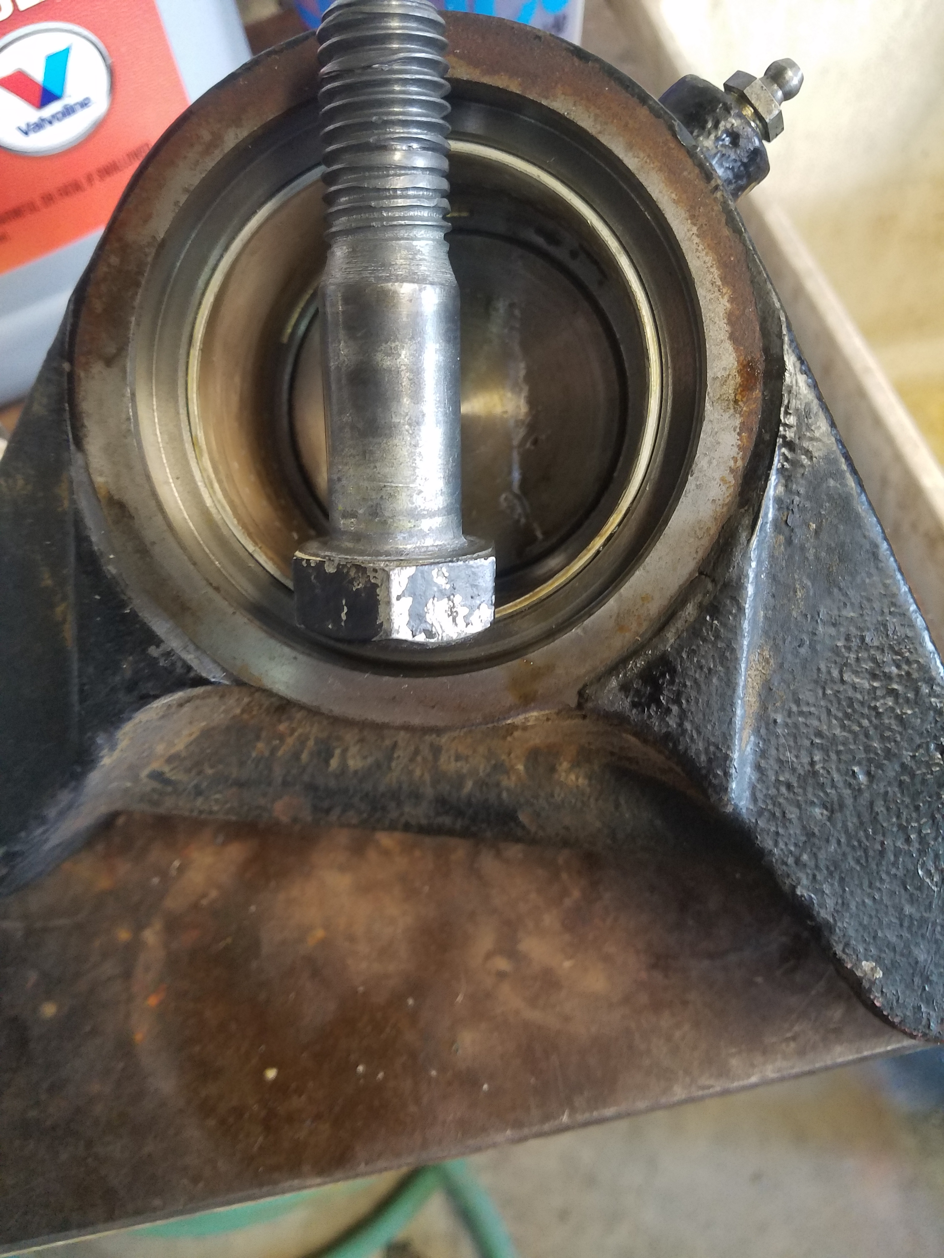

#13
The dealer came by yesterday and we got it loaded up. Once we got it up, we confirmed that the front carrier bolts were what came loose and fell out, causing the whole front axle rotate. Here is a pic, notice how this bolt has thread wear? It doesn't appear that any thread locker or loctite was ever used, and that they had been moving around for sometime. I just don't get how this is something that you would have to normally check, as it's not the easiest thing to even get to. Obviously this is something Mahindra must of noticed as newer models have lock tab washers, that prevent them from backing out. I also spoke with a lady at the corporate office to ask if any service bulletins or recalls have been issued for this. She said she couldn't find any, not surprising. Not insight is appreciated. 20180831_104531.jpg

The dealer came by yesterday and we got it loaded up. Once we got it up, we confirmed that the front carrier bolts were what came loose and fell out, causing the whole front axle rotate. Here is a pic, notice how this bolt has thread wear? It doesn't appear that any thread locker or loctite was ever used, and that they had been moving around for sometime. I just don't get how this is something that you would have to normally check, as it's not the easiest thing to even get to. Obviously this is something Mahindra must of noticed as newer models have lock tab washers, that prevent them from backing out. I also spoke with a lady at the corporate office to ask if any service bulletins or recalls have been issued for this. She said she couldn't find any, not surprising. Not insight is appreciated.View attachment 569157
Hard to believe the operator didn't feel that looseness long before it fell out. There are 4 bolts, two for each pillow block, that hold the axle on. I check mine when I grease them for bolt tightness.

Holy Moly. Looks like the Spiral Bevel Pinion dropped away from the chassis too.
