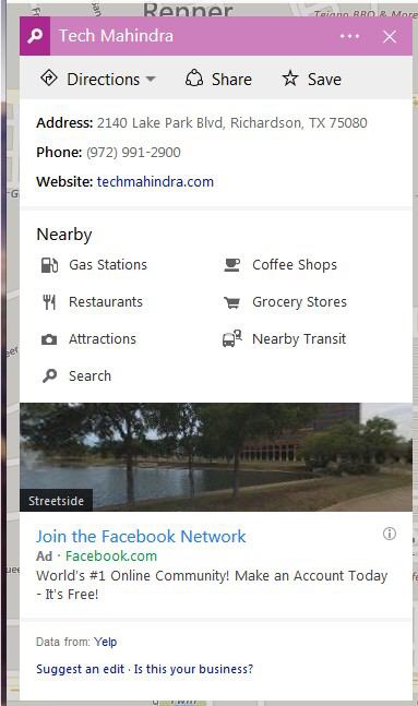

I haven't used this number but it may be worth a shot.
