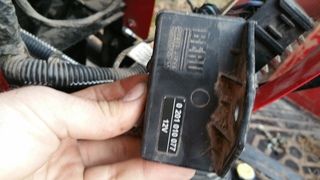

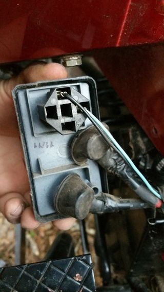

It looks like this
I'm not sure if this is the timer and relay or what. When I turn the key on the blue wire has 12v but it says powered on so I'm guessing the timer has to be inside the box. The dealer says there's an actual plug in replaceable timer but I don't know where it would be.
   / Mahindra 6500 Intake Manifold Heater #19
Right that's bolted on the frame that the side panels pin too I believe. The timer relay sits on the left side of the block were the fuse panel and starter relay also sits. believe they are usually blue
   / Mahindra 6500 Intake Manifold Heater #20
if your getttin 12vs to that is it leaving it? or coming on at all? or are you saying the power never stops going to the plugs? sorry I jumped in half way through the thread
