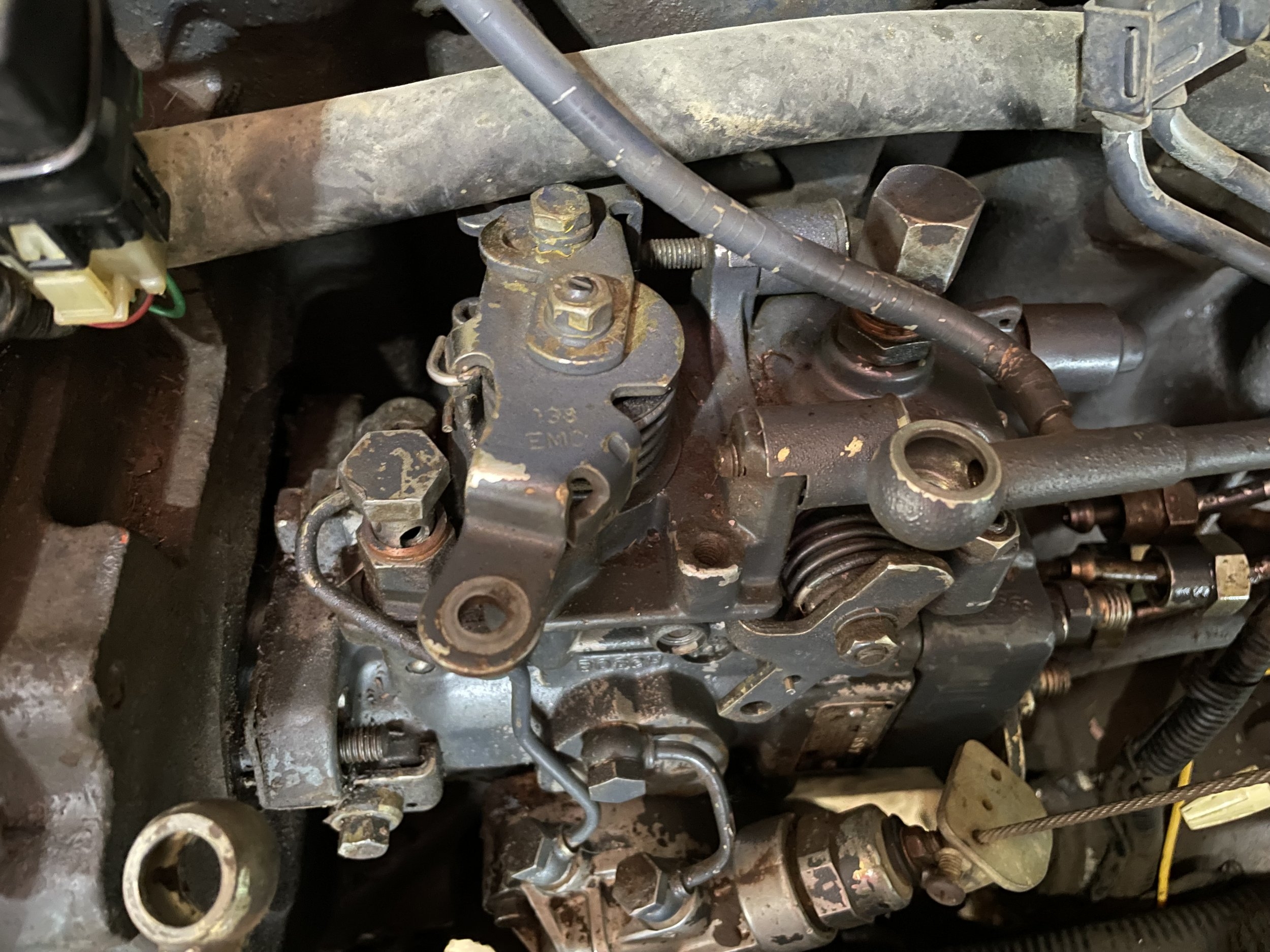

I have a Mahindra 7010 and I need to pull the injection pump off to have it rebuilt. Does anyone know were the timing hole/pin/bolt (to make sure it's at TDC) is located on this model?
   / Mahindra 7010 Injection pump issues #2
I’m not familiar with that mdl.. but.. most of them are directly underneath the inj pump itself..
I found it. TDC hole is located behind the starter.

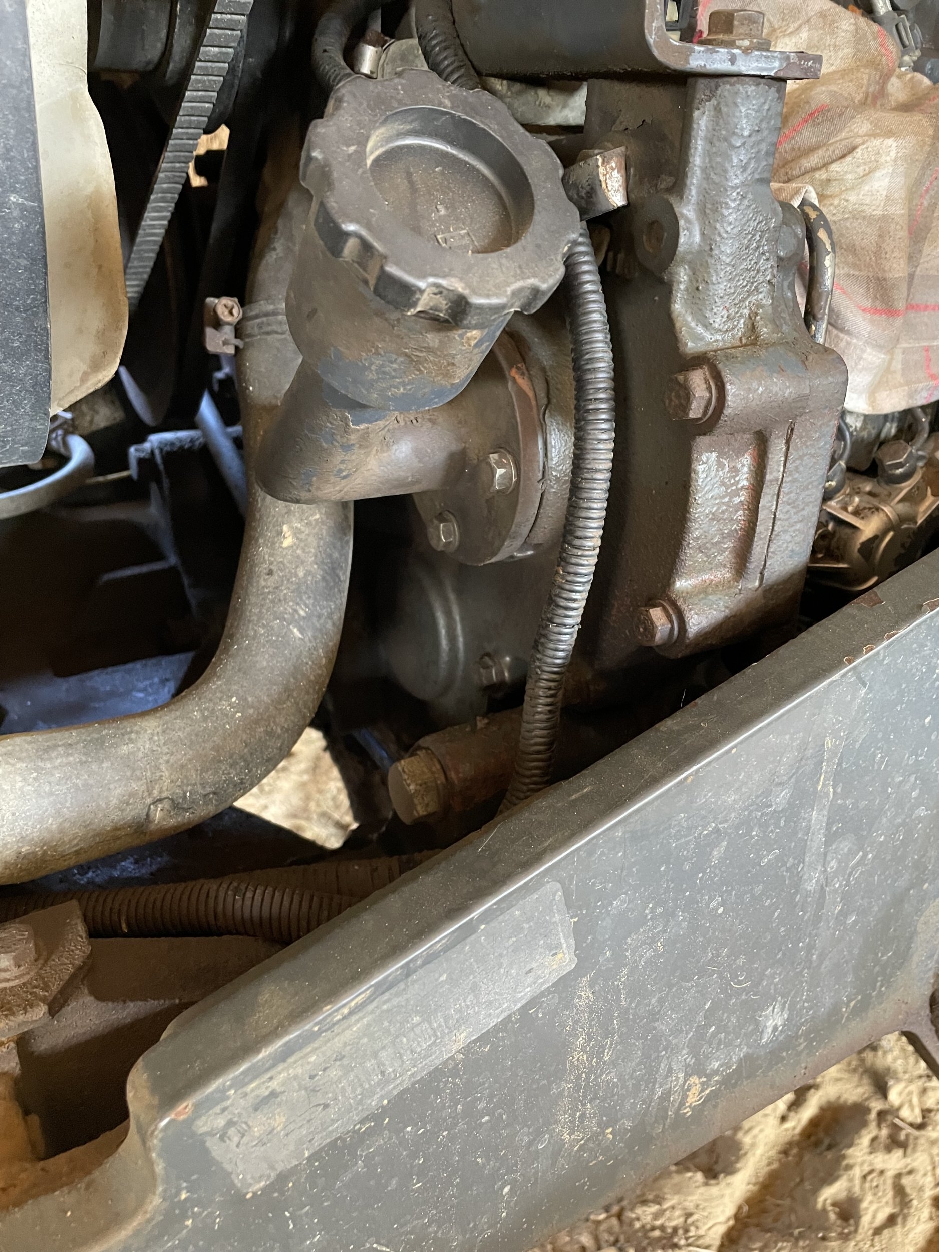

Hello hamiltonchuck. I too need to pull the pump off my mahindra 7010 as it has a leak on the inside next to the engine. I have never done anything with timing before. I don't know how to get the engine into tdc. I was hoping you would be willing to give me some guidance on it as well as how much of the front of the engine i need to dismantle to get the gear off the pump. Thanks!
   / Mahindra 7010 Injection pump issues #5
Look directly in front of the pump.. (radiator side) there “should be” a separate plate that can be removed to access the gear side of the inj. pump..
If there’s not a cover plate, the whole timing cover would have to be removed..
It’s not out of the question..
That’s how we have to do the New Holland inj pumps..
   / Mahindra 7010 Injection pump issues #6
Hello! Thanks for the reply. There is this oil inlet plate that I can remove to expose the nut on the pump. Just not sure if that is enough room to get the gear off
   / Mahindra 7010 Injection pump issues #7
U don’t take the gear OUT..
As a safety precaution, degrease the face of the gear and run a magic marker to the other gear or somewhere YOU KNOW how the gear goes incase it falls out of place..

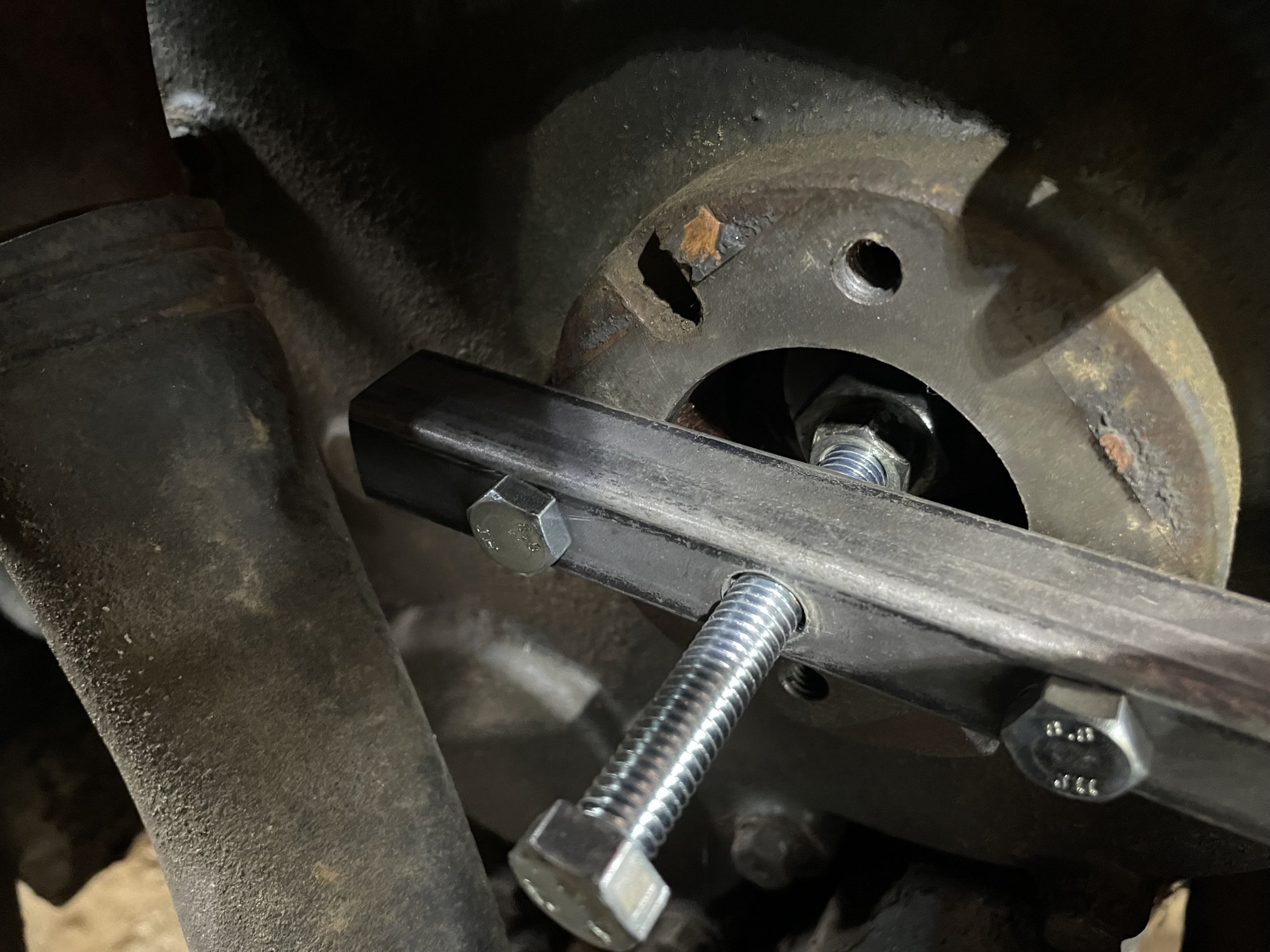

Here is where I am at. I have assumed the timing marks are on the pump side which I can’t see yet and not on the nut side where the access is very limited. The shaft looks keyed so I decided to try and push the pump out. My local mahindra dealer service guy said I should just be able to tap it out. Not so.
I made this device to really put some pressure on it but it doesn’t budge. It is a lighter weight device so I can only crank so much before the bolt strips out. Do I just need to beef up my plan or am I missing something?
   / Mahindra 7010 Injection pump issues #10

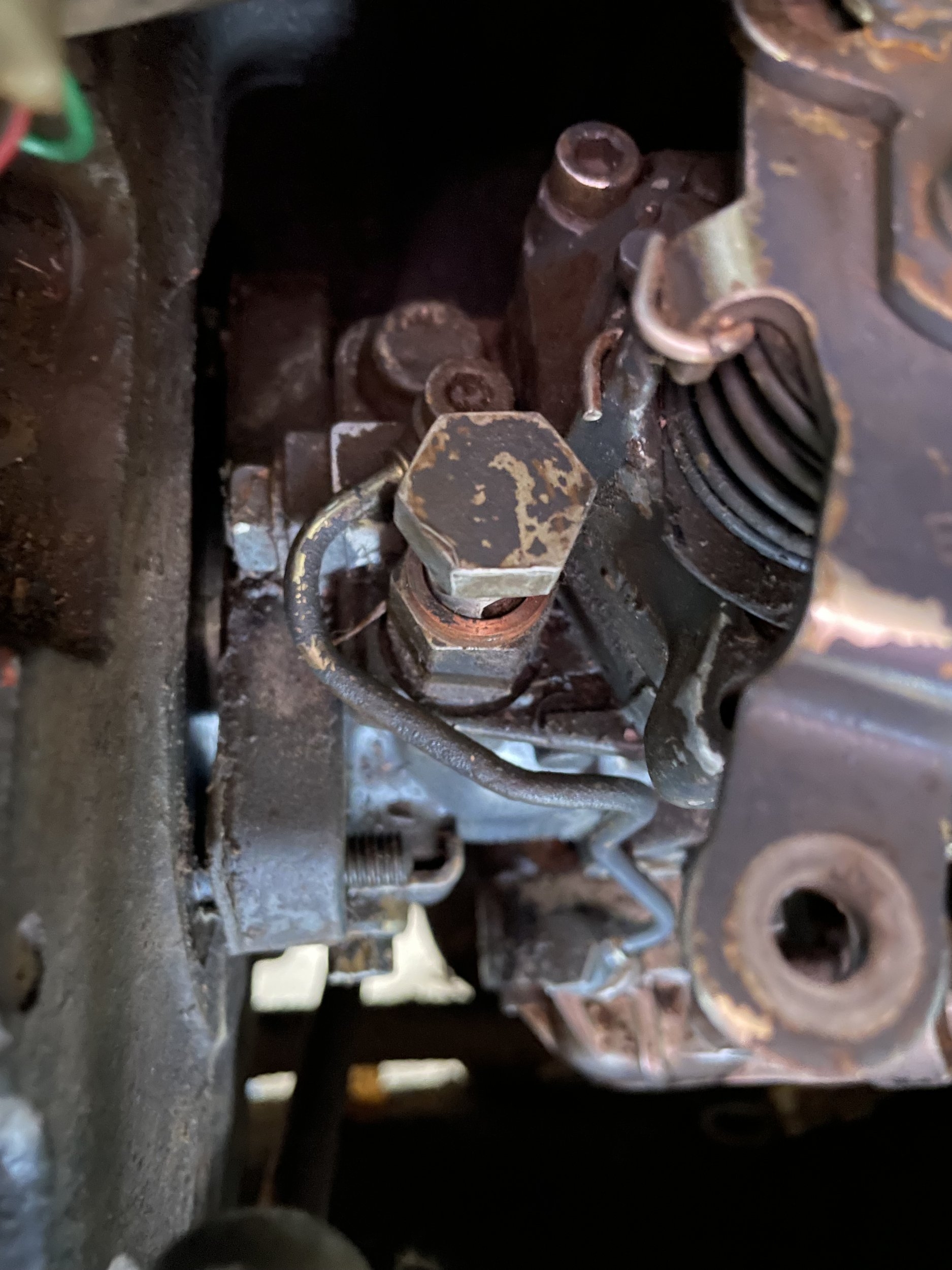

It’s very possible that the shaft IS NOT KEYED..
Whatcha gotta do it find TDC and lock the pump drive shaft..
U see that 10mm headed screw with the washer under it.??
Once u find TDC, loosen the 10mm screw and remove the washer..
tie the washer to the pump and tighten the screw against the drive shaft..so it won’t turn.
They sell VE pump removal tools online..
