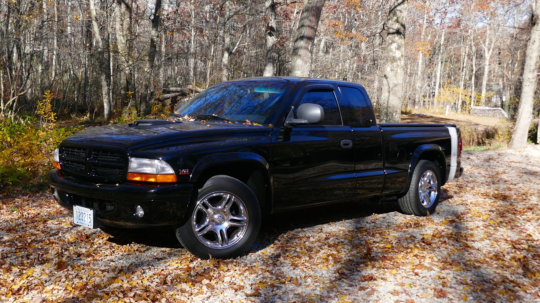

Not in my tractor...yet. RP is in the 2000 Dakota however in tranny, rear end and crank case. Picked up 2 tenths in the quarter. Changed over at 32,000 miles. Truck is now at 36K so it should last for a while.
Darn, had 1750 hrs in 28 years on the JD before I traded her in. Would have only had to change the tranny fluid twice had I used RP....hmm, had I used synthetic tranny fluid, wonder if I could have never changed it and just topped off with filter changes?
