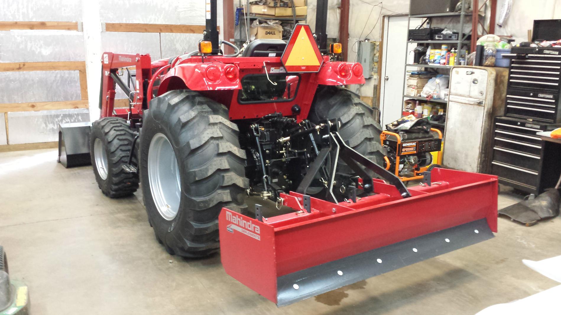

I bought the Mahindra 6' HD Box scraper when I bought my 2555 exactly one year-ago this Monday and I can tell you that it is built like a rock. When they call it Heavy-Duty, they mean it! Beefy!
Nice tractor..!!! Where did you get that ' new ' refrigerator..?? Have not seen one like that in MANY a year... :)
/ Mahindra Implements? #13
Good Eye!
That's an old International Harvester refrigerator I've had forever. Late 40's. 70+ years old and it runs perfectly. Never had to charge it or anything. It's so quiet I sometimes don't know if it's still working until I open the door. May not look like much, but I sure do love it!!!
