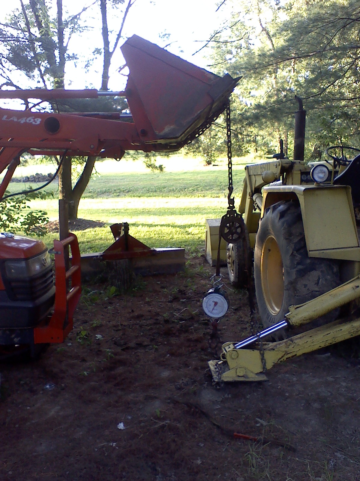

My crude setup I will describe but the pics will show it best. All I have is 2 550lb game scales. Which I believe show about 10% LESS than actual based on weighing myself on certified scales at work and then on these. But I wont use that for any excuses.
The setup is with a big pully. Since only the 2 scales give me 1100lb capacity, with a simple pully, I can double that. So basically with the setup and 2 scales, lift force is actually 4x's what is shown. All this is hooked to the outrigger on the 5500BH.

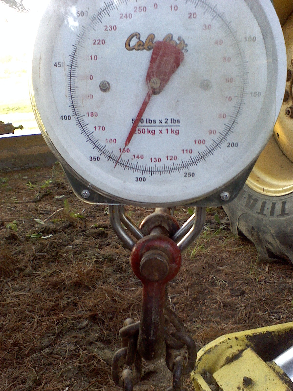

The first pic is the set-up. and then LIFT ONLY. Scale shows 330# which is actuall 1330#. (This is at the cutting edge as you can see). Not bad.

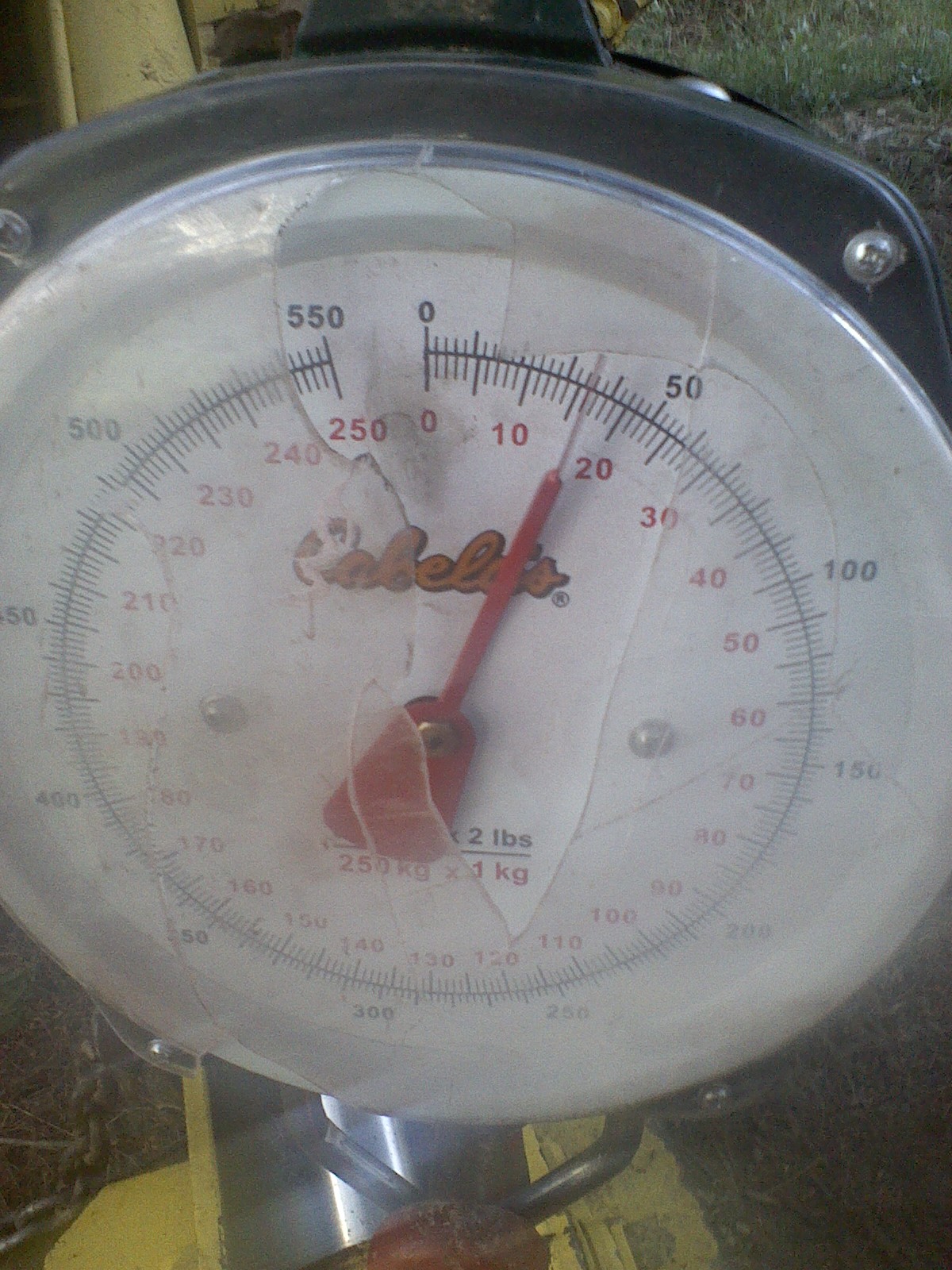

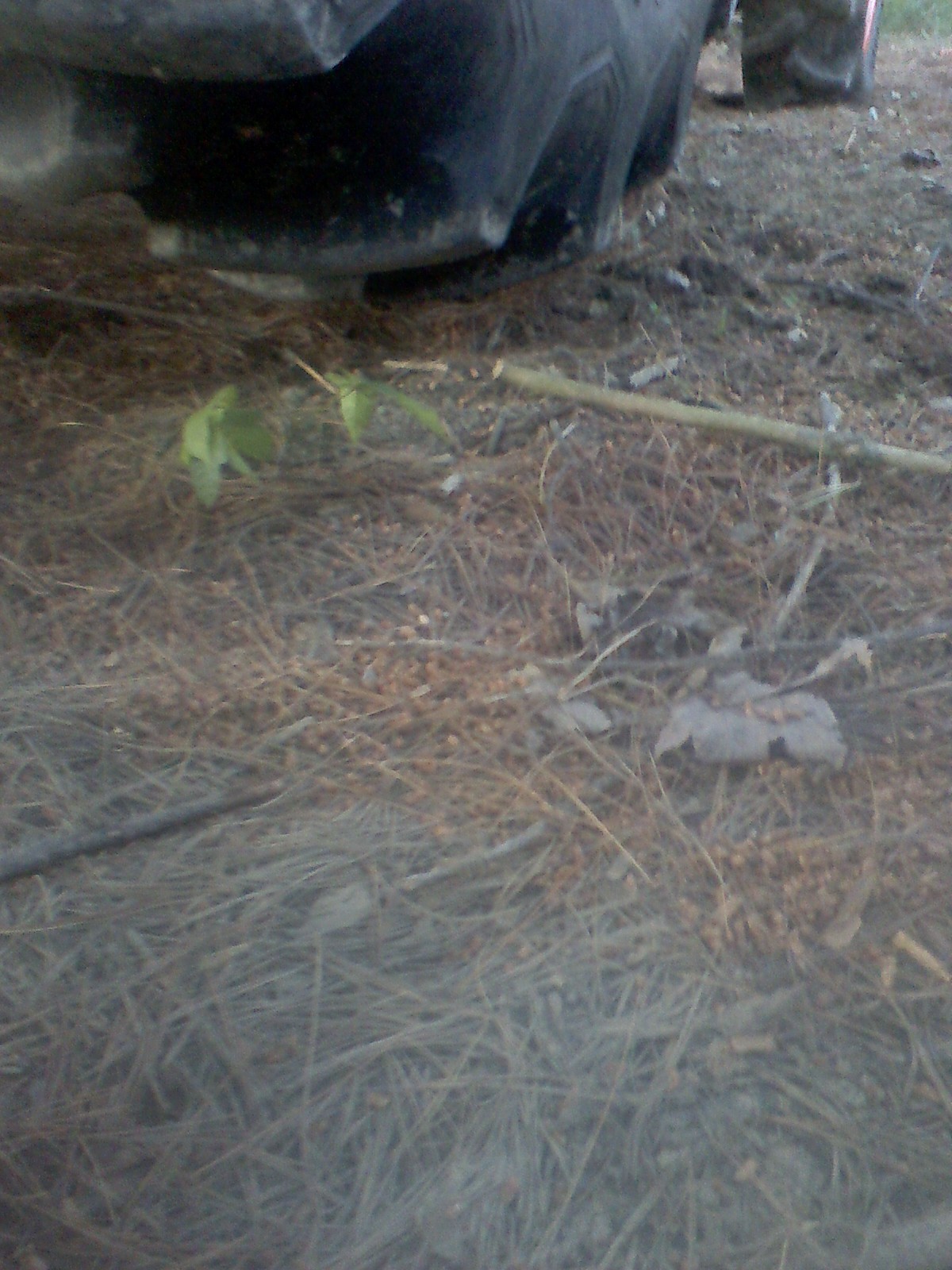

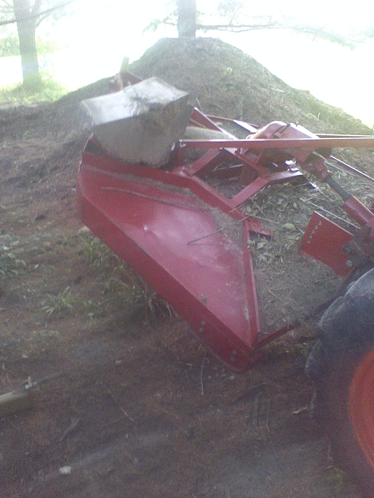

Now for curl test:confused2: I kept the lift pressure on. Gauge shows ~2700PSI and it is only a 3000PSI guage. I hit curl and the gauge pegs instantly proving that there is WAY more than relief force when using a "curl assisted lift". Anyway....Keep going. Back wheel lifts. I improvise quick and chuck a 50# rock and an hunk of wood on the back of my ~1100# cutter. Keep going....... Big game scales are 550#. Well around goes the dial and back to ~35 or so past 0:confused2: There is about a 20# void between 550 and 0, so going back to +35, we are now at about 605#. Up comes a back tire again:confused2: In all fairness, I was on an ever-so-slight grade. but at this point, I call it quits. No point in seeing what the inside of the scales look like scatterd all over:laughing: so...605 x 4 = 2420# curl force and probabally a tad more with a good way to measure.

Cool test, LD1.
