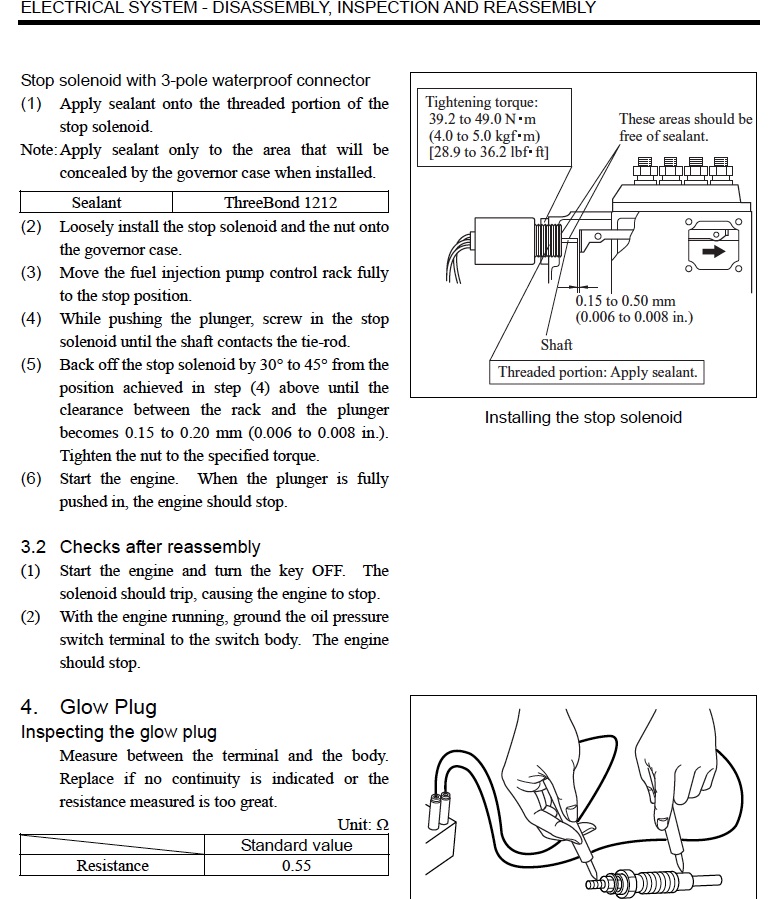

I don't know of any 28s that are under 2yrs old so most likely out of the bumper to bumper warranty... its an easy fix to do yourself though... just be sure you unplug with wires and twist with the solenoid when you spin it off and also when you put the new one on... makes life easier to unbolt the coolant reservoir

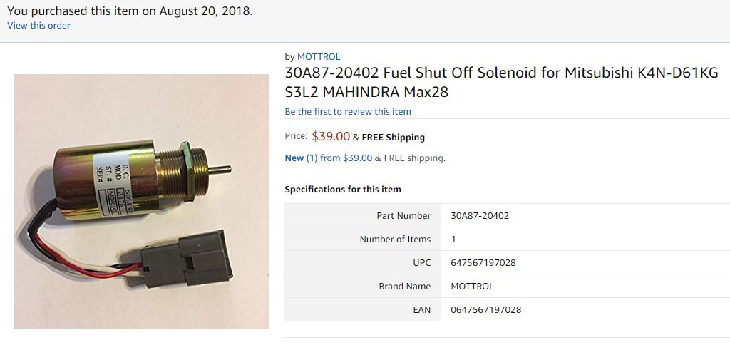

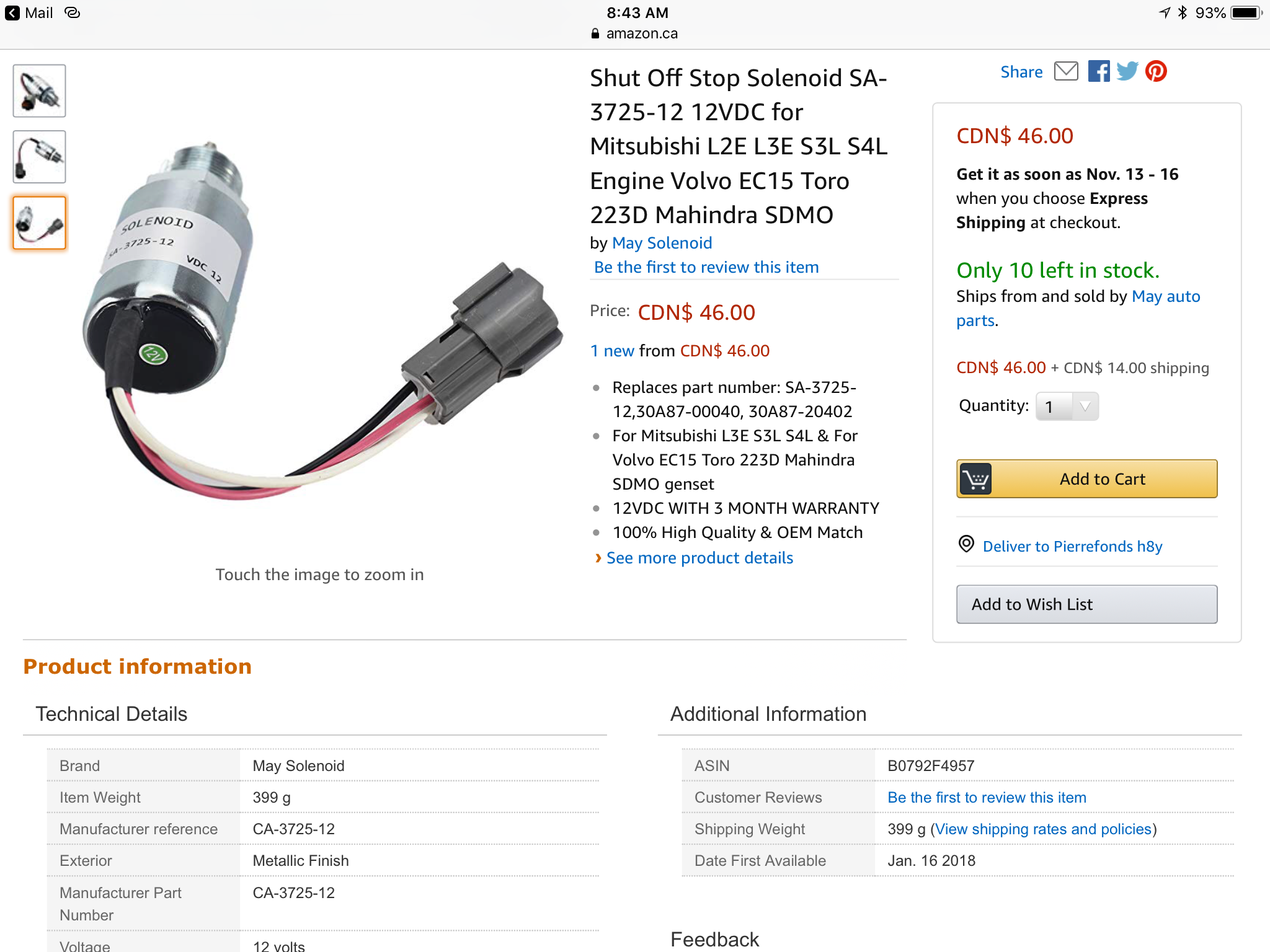

Hi everyone,
Can someone confirm that this is a good fuel shutoff solenoid for the Max28XL it痴 a far cry
Less expensive ??
   / Mahindra Max28XL Starting Problem
#17
I got this one and it worked out fine.
   / Mahindra Max28XL Starting Problem #18
Just a fair warning>> folks that are buying those off the web are experiencing that SOME of the plugs are different..
You may have to cut & solder?? But after all is said & done, the solenoid works as it should..
