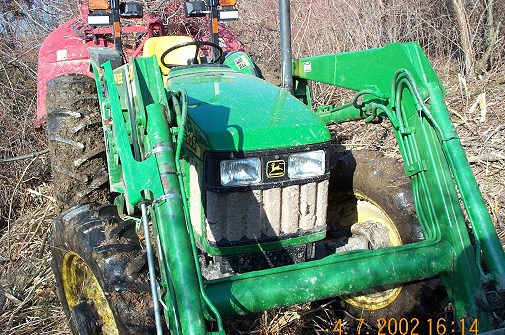

This "black" grille needs some attention while brush hogging a swamp area...
The operator of the tractor must perform periodic “cleaning maintenance” while brush hogging… That is one of the REQUIRED DUTIES and the operator’s responsibility…
Just as you are expected to check your engine oil level, radiator coolant level, and the multiple fasteners on the tractor’s wheels and undercarriage for correct torque/tightness… you are required to do certain things while using the tractor with each individual implement according to the task at hand…
Depending on what you are brush hogging… you must clean the grille and radiator areas… sometimes you have to disembark the tractor every 10 or 15 minutes while cutting through a silky cattail swamp area (as noted in my picture), other times you get off every 40 – 50 minutes…
Nothing is etched in concrete… but you must do it to prevent this potential overheating problem… that will be caused if you elect to do nothing (or wait too long)…
