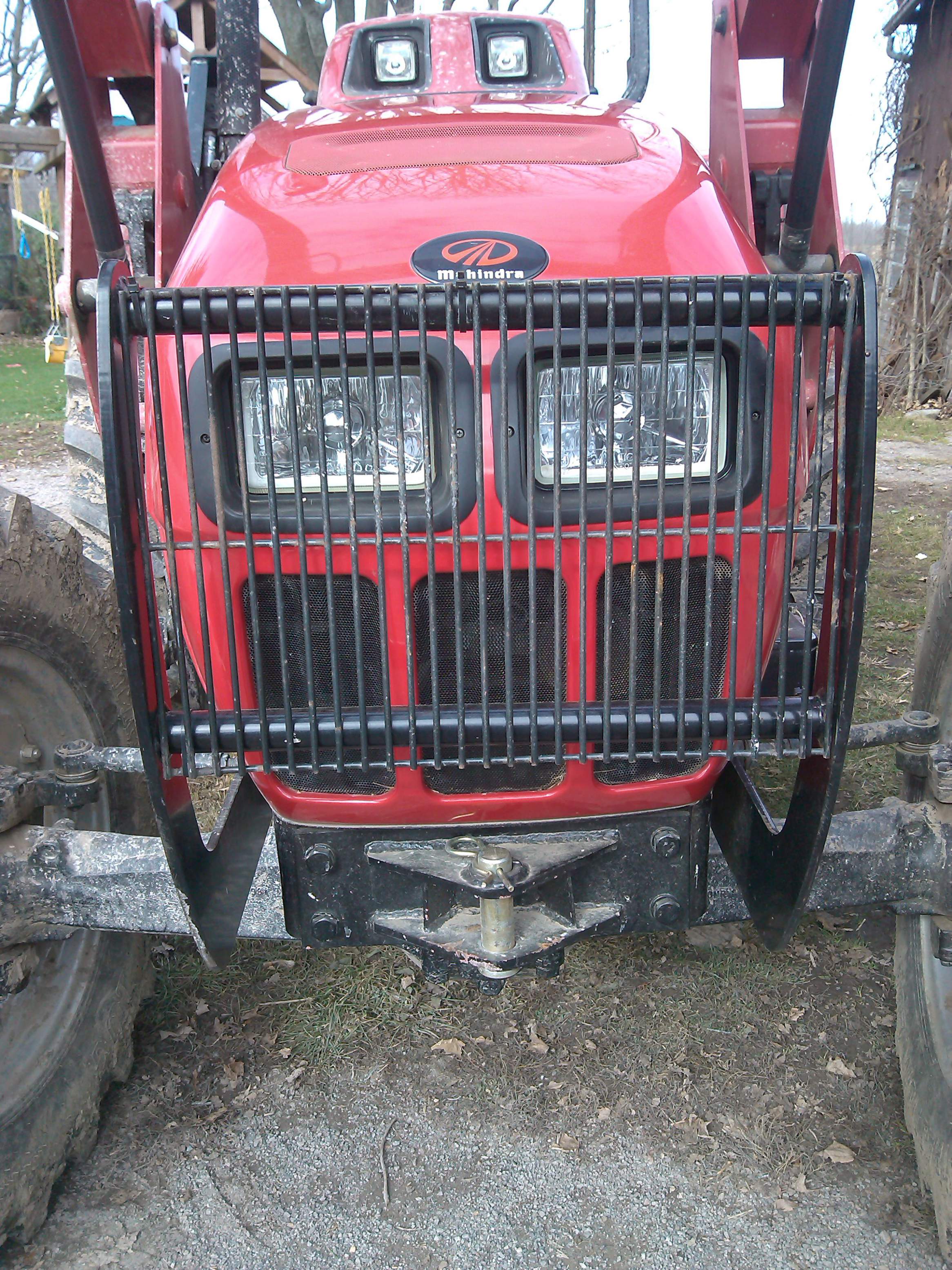

I treated myself to a new mahindra 8560 4wd. half a year ago and I am still jealous of myself ! Had a john deere 2130 , don't miss it one bit ! for half the price of a new john deere built in the same place with the same engine , you get more tractor , twice as much warranty , no plastic fenders and hood but fat , solid steel ,turns on a dime , after 250 hours I can recommend this tractor to everyone !! and my dealer , Bob Mark in Campbellford-Ontario is great..something wrong , they come right away , if they cant solve it , you get another tractor to use . So far the pto broke , seemed I was the first case ever ...just found the seat to low so raised it 3 inches , gave me better vieuw too... and I put a headlight guard on after breaking one with a stick . why buy a 4-5 year old tractor with 3-4000 hours on it and no warranty , if the same money buys you a great new mahindra ??? RECOMMENDED !!!!!! Lionplow (1).jpg
