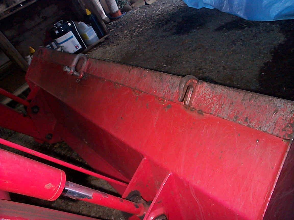

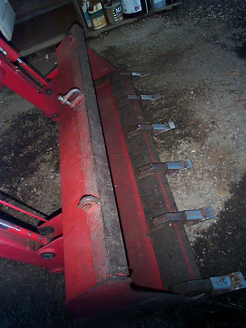

This is what I did to the loader bucket on my 2615. The center hook allows for attaching a cable or a rope. The angle iron is 3/8" thick. Before I reinforced the top edge it was starting to bow slightly. That is only because I wasn't loading with it, but attacking one of those unmentionable tasks.

AchingBack, that looks really sturdy. Have you experienced any bowing or bending since?
   / Mahindra's Bucket Strength #17
The only bending and bowing is in my aging body. The loader bucket is now as strong as could be.

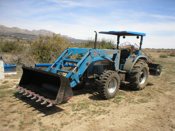

You can't see the angle that I used before I welded on my 5 hooks, but I used 2x2x3/8 thick, full bucket width. I also added 8" wide by 3/8 thick flat plate to the sides and cut to match the bucket sides. 9 weld on shanks with pin on teeth and my digging bucket is all set.:D

I don't think that looks quite strong enough, LOL. While you think about how to beef it up, thing about this:

Brian, your bucket is like the "ALPHA BUCKET"! LOL! Man that thing looks sturdy. I'm thinking about going with 3/8" instead of 1/4".
