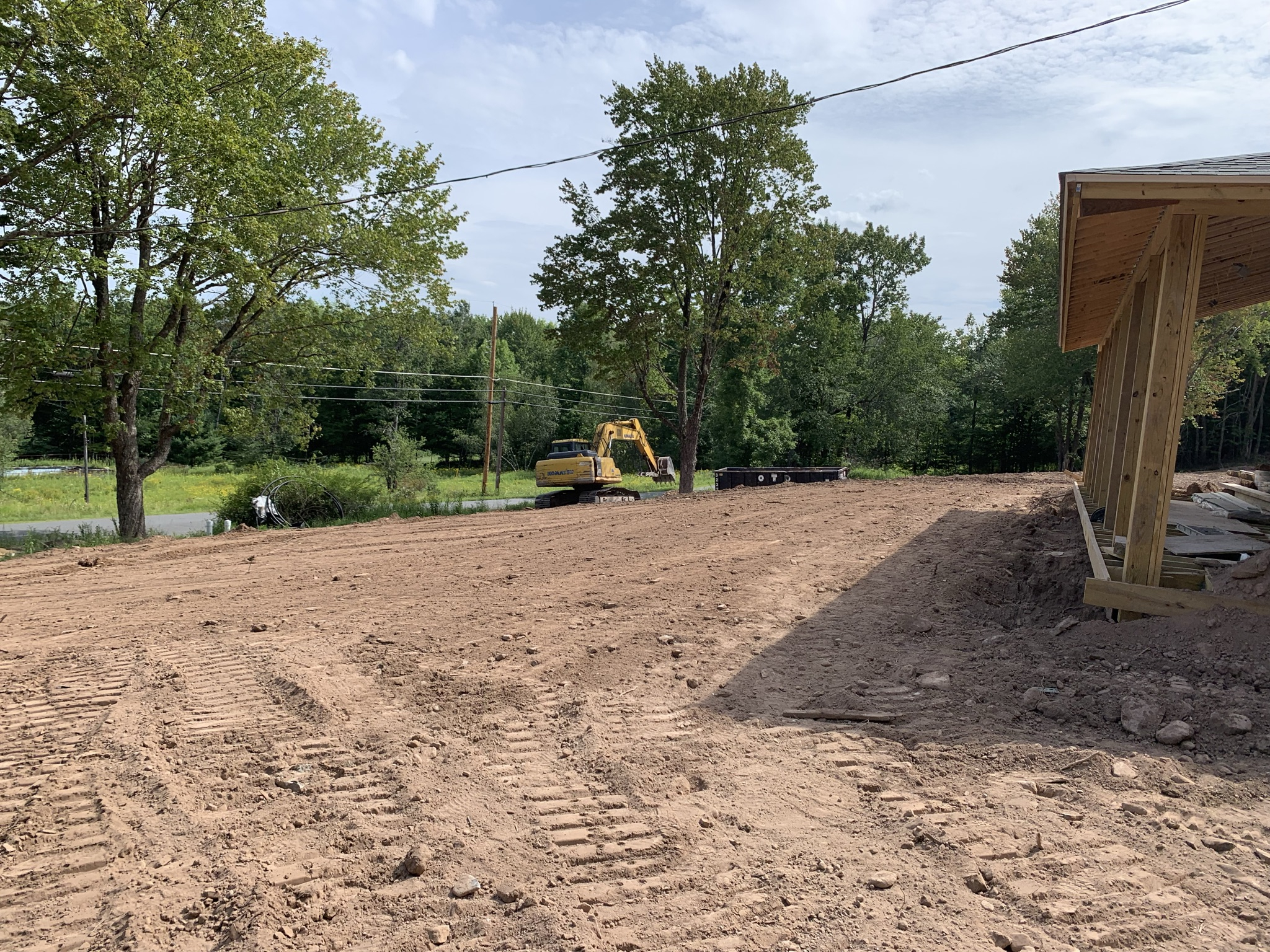

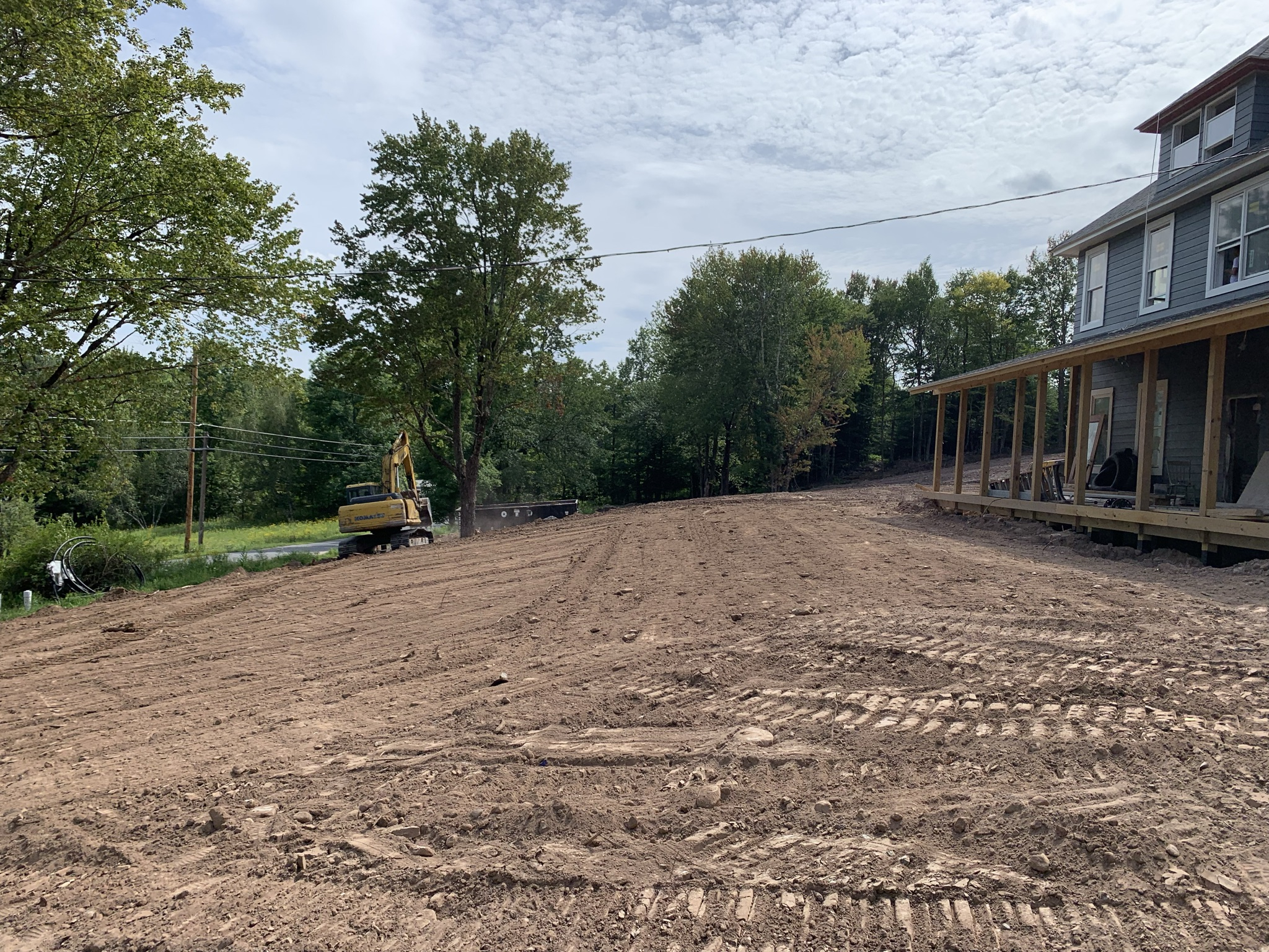

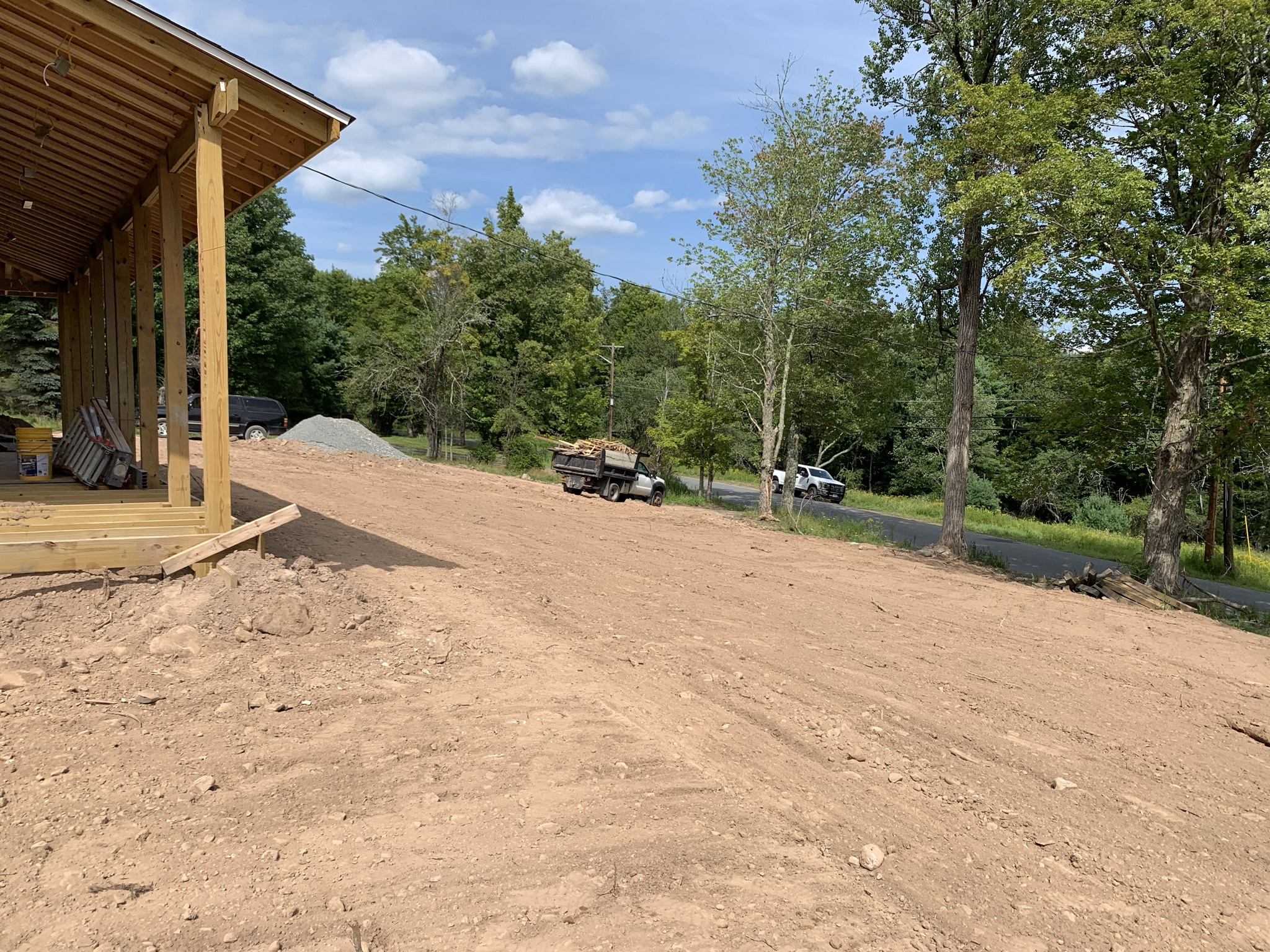

Have Tractor Will Travel: That's exactly where we are going. I'm a little concerned about having a simple slope from the house to the road.
Move another couple hundred tons of dirt yesterday.
Here's what I've got now.
View attachment 709956View attachment 709957View attachment 709958View attachment 709959View attachment 709960View attachment 709961
My 2 cents again: You mentioned the french drains around the house. I would be a little weary of routing the gutters into them myself depending on how you built them. I had an issue at my house although not the ground slope you have. I ended up using 4" pvc to drain water a ways from the house - separate line for each gutter.
Recall that for every 1000 sq/ft of roof, with a 1" rain, that is about 620 gallons.... a lot of water for only an inch of rainfall. In my opinion, again depending on your french drain construction, it could overwhelm the system. In my case, initially, before I had all the pipes routed out away from the house, it did. This caused the gutters to overflow, which caused some damage. Good luck to you !
