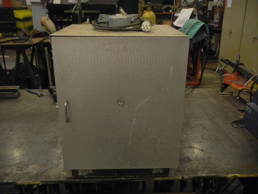

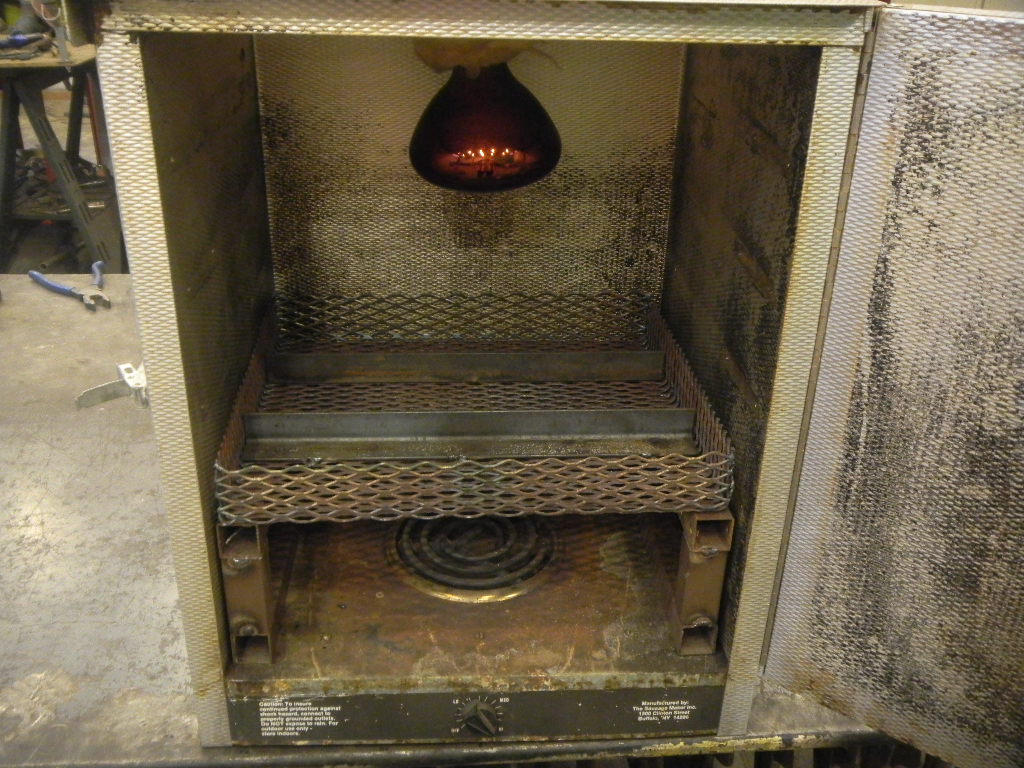

   / make-shift electrode oven #2

good question...not sure. I have a small portable oven i got 3-4 years ago for about $200 at my supply house. it gets very warm..not hot to the touch on the outside, but i cant handle the rods inside without gloves....verrrry hot.
The 3/4" of insulation does wonders to keep the heat in. I dont see how an exposed pipe can insulate it. You might have to place this setup inside another larger pipe and seal the ends. ... wait, homeland security might think your making bombs LOL
