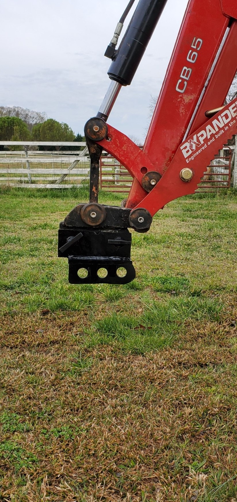

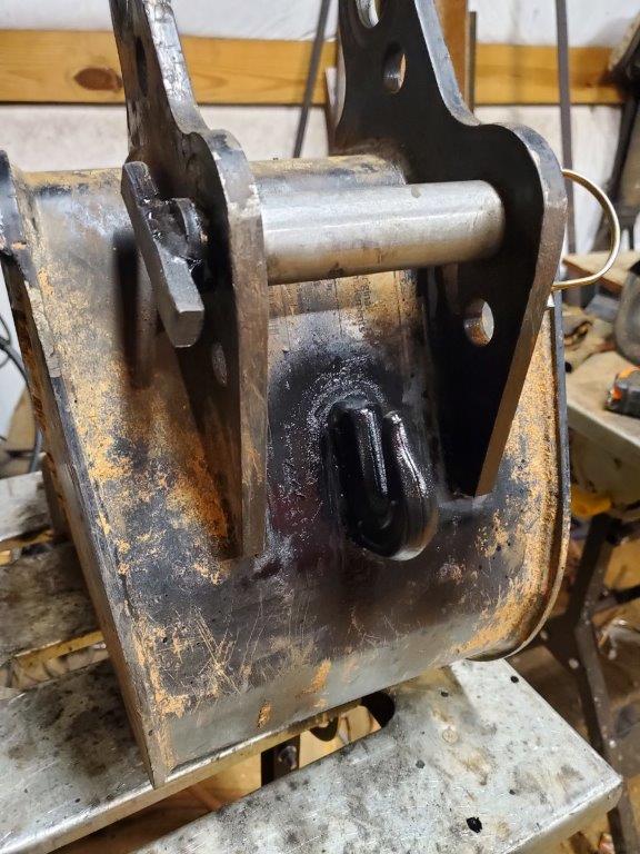

I got sidetracked and welded a bucket hook on my OEM bucket.
Then I built a backhoe lift attachment. This was made with 1/2" plate and top attachment was 3/8"
If I did not have a QC I would not make something like this. It is so quick change it out I think it will come in handily for some jobs.

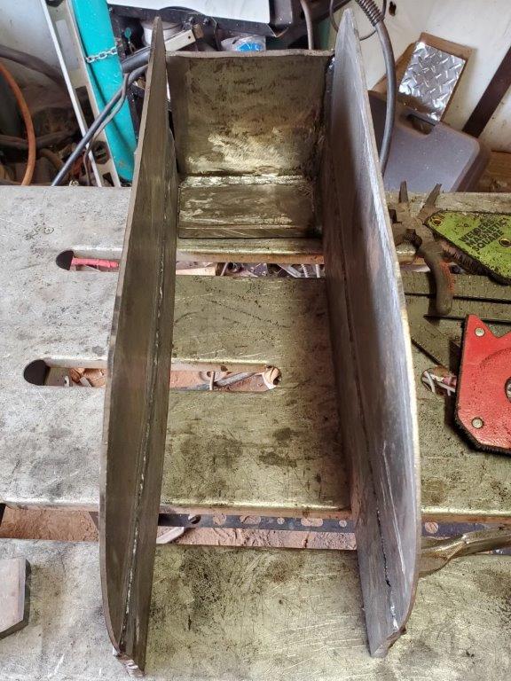

#14

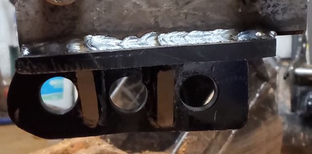

I made a cardboard template of the side of my 16" bucket and marked and cut it out.
Added 6" width and fabricated mounting flanges.
Have dug 2 drainfields, many water and electric runs.
If it is too narrow the dirt might get stuck.
I changed the bucket style I making. I am making a bucket similar to your 6" bucket. It is long and only 6" wide.
I am making it longer because it really only digs the length of the bucket and a little more.
The backhoe is wider than the bucket where the thumb connects.
I made few of those. Tooth is not a good idea, it will cause dirt to accumulate in the bucket. Works much better without a tooth. I just put a Hardox cutting edge on it. Size depends on the size of our backhoe and required digging depth
I thinking about making a Bxpanded style teeth for this bucket but weld them on. Taking BFreaky advice.

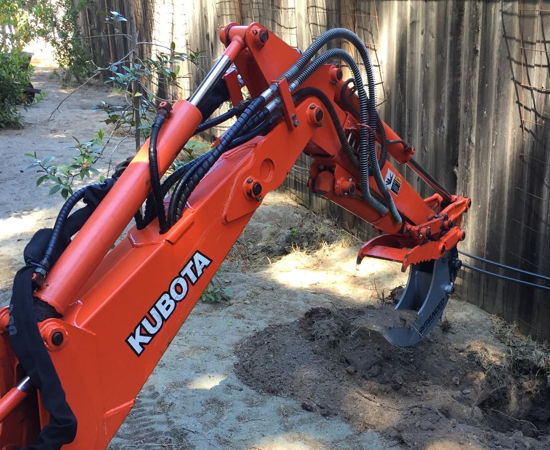

What's the advantage of the banana style vs the more typical bucket shape?
I think it's a long narrow bucket which is intended primarily for trenching; it's longer to reach further into the ground without the pins etc hitting the sides of the trench.

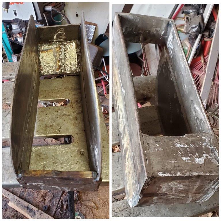

@downsizingnow48 Thanks posting your experience with BXpanded bucket.
I made some progress.
I just need to put in the bottom some Bxpanded style teeth.
Then brackets for the pins.

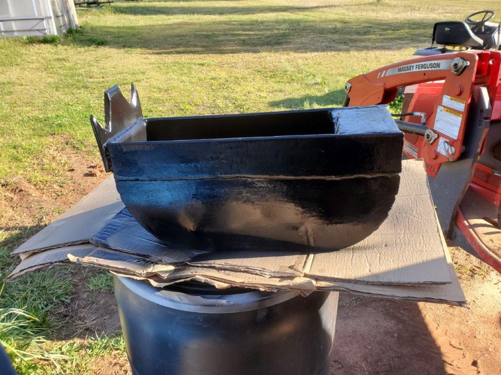

#18
All I need now is the back brackets. It is finally looking like a bucket.
I broke a small ratchet strap making the curved bottom.
The larger 2" 10K pounds ratchet strap was able to do the job.
I hope it digs well.
