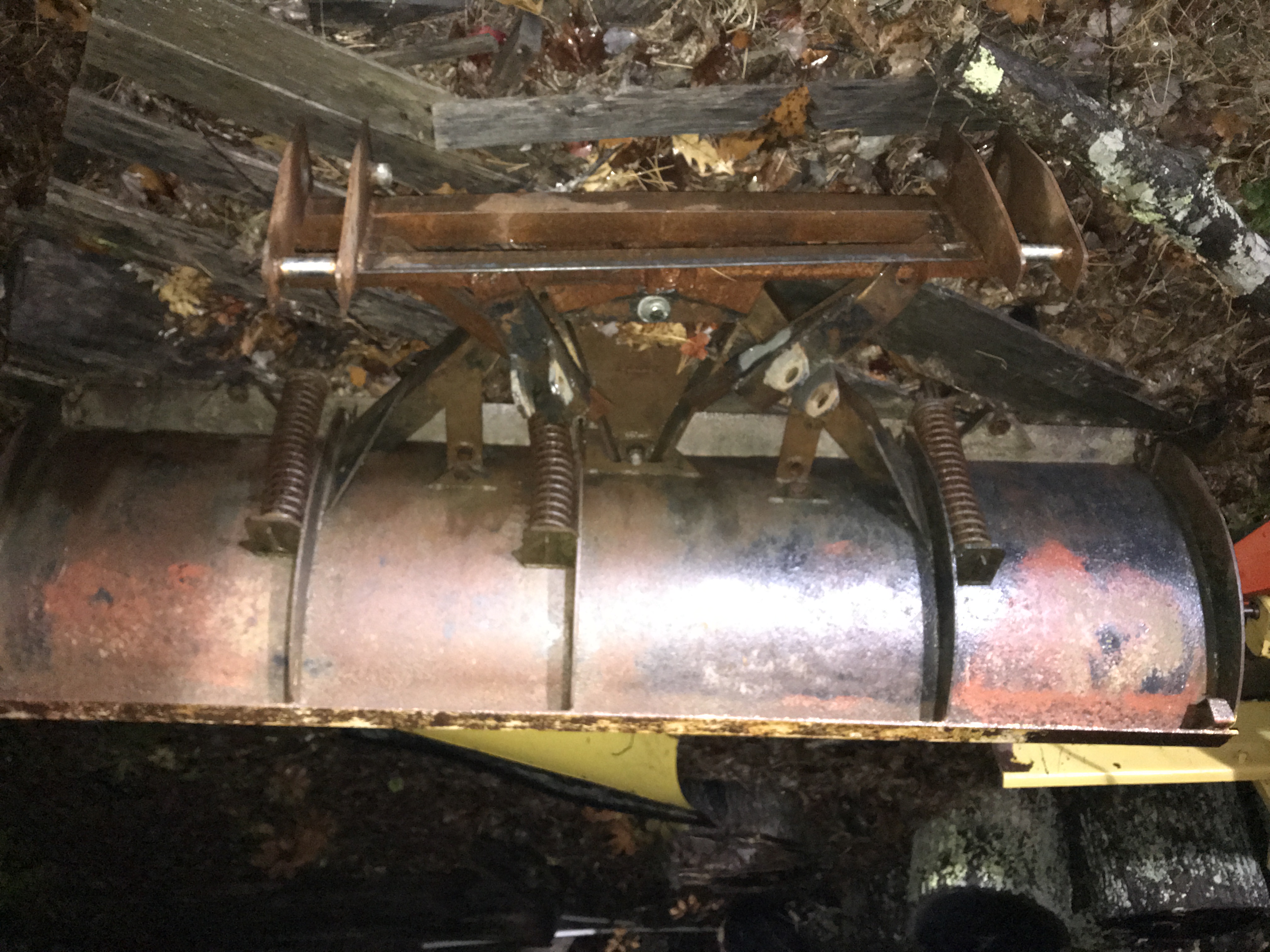

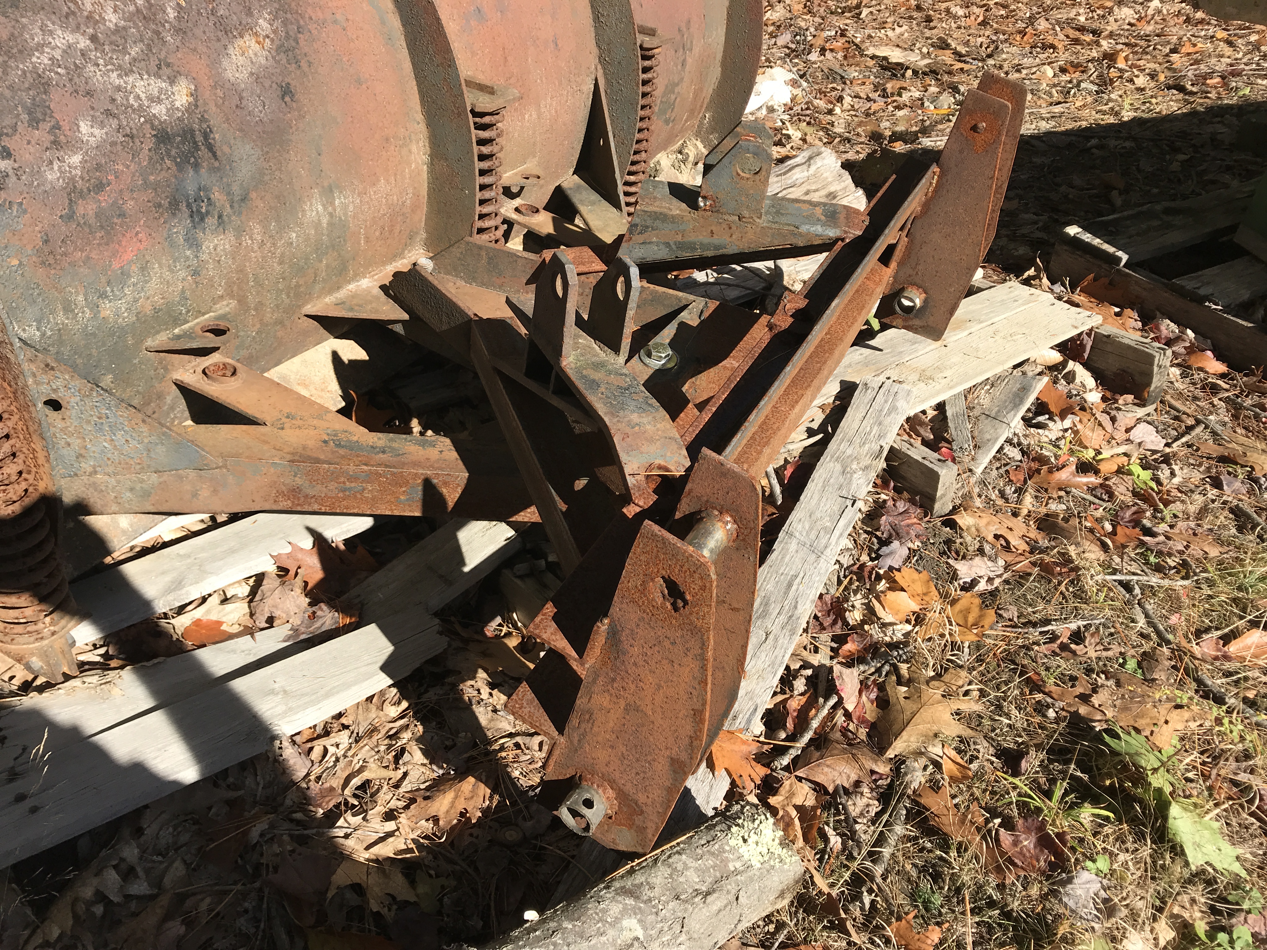

I'll snap some and upload them when I get home from work today.
It was dark when I got home today. Got to love this time of year lol. I'll put more pics up tomorrow when it's not so dark. Also, excuse the rust. I haven't gotten around to painting it yet.

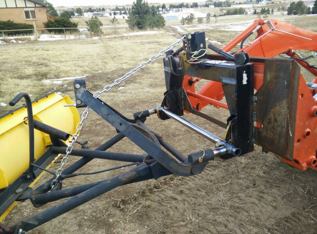

In my application, I installed a cheap Harbor freight 3PT QA to the loader bucket. Two bolts and a top linkage make a quick installation. I did it primarily for a blade but you can actually attach any 3PT implements.

My Massey has its own version of the quick attach for swapping out attachments on the FEL which is why i welded those pins in. Certainly isn't going to win a beauty award, but it cost me less than 200 bucks and moved 100+" of snow over last winter!
I welded a QH to a SSQA plate. Was my plow mount. Made movng & working on impliments dam handy too.IMG_20150117_153817.jpgIMG_20150117_153836.jpg20161025_152850.jpg

Thank You everyone. I have some ideas and I think the first thing I will do is try to find an old snow plow blade and then make up something like I see in the pics. Thanks again.
