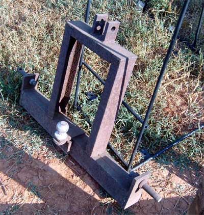

Hello All,
new to farm life and new to group but have been reading a lot of post here. Very cool and informative website! I've got a question, we bought a farm and have been finding some interesting things on it. One is this 3pt hitch thingamajig. We also have found some galvenized pipe laying around. I was wondering if I could make (I have a flux core welder) a boom pole out of these two items?
thanks!
Steve

Do you have a hydraulic cylinder, also?
That type of three-point hitch would lend itself to building a boom pole modeled after a engine hoist.
How heavy are the pipes? Will one slip inside the other, to make the boom stronger? You could also attach a triangular truss to the top of the boom, for reinforcement. My experience is that you will always try to pick up just a little more weight than the boom will take, so stronger is better. (until the front end of the tractor comes off the ground... /forums/images/graemlins/grin.gif)

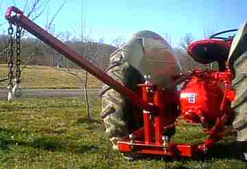

   / making a boom pole?.... #6
And here is another. And I don't remember who posted this one either. Ain't CRS a terrible thing? /forums/images/graemlins/frown.gif I suspect one of these was the inspiration for the other. Very similar except for color.
