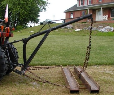

Hello All,
new to farm life and new to group but have been reading a lot of post here. Very cool and informative website! I've got a question, we bought a farm and have been finding some interesting things on it. One is this 3pt hitch thingamajig. We also have found some galvenized pipe laying around. I was wondering if I could make (I have a flux core welder) a boom pole out of these two items?
thanks!
Steve
/ making a boom pole?.... #2
Do you have a hydraulic cylinder, also?
That type of three-point hitch would lend itself to building a boom pole modeled after a engine hoist.
How heavy are the pipes? Will one slip inside the other, to make the boom stronger? You could also attach a triangular truss to the top of the boom, for reinforcement. My experience is that you will always try to pick up just a little more weight than the boom will take, so stronger is better. (until the front end of the tractor comes off the ground... /forums/images/graemlins/grin.gif)

I think you may be further ahead if you go to a metal salvage yard and get some heavier gage steel. I am like one of the other posters on this thread said, "always trying to lift things heavier than the boom was designed to lift". The end of my boom pole is much closer to the ground than it once was. I have used galvanized steel pipe for many things and found that it is great for some things but it is quite soft and bends much easier than the heavier gage steel tubing. I also like the stick welder for the heavier welding projects.
I like the 3pt hitch thingamajig you found. It is simple in design but looks like it can do many things for you.
Farwell
/ making a boom pole?.... #12
Here's one I made from some scrap schedule 40 galvanized pipe and pieces of 1/2" square steel. I used a stick welder on this one. Pipe was bent on a hydraulic bender I rescued at a company garage sale (real cheap). With the rig you found, I'd make it detachable so you could cobble up some other "attachments". Looks like it could be fun.............chim
