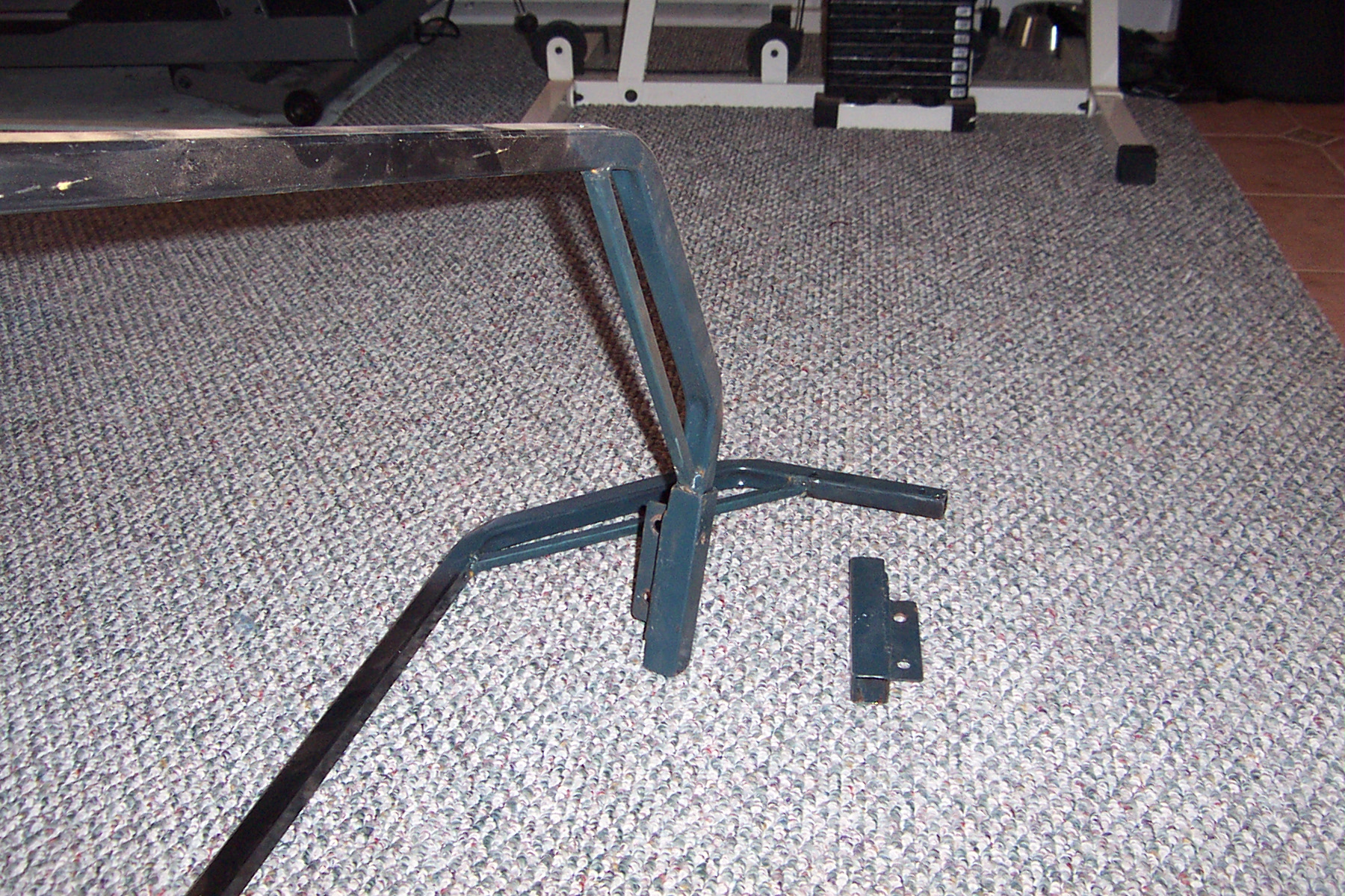

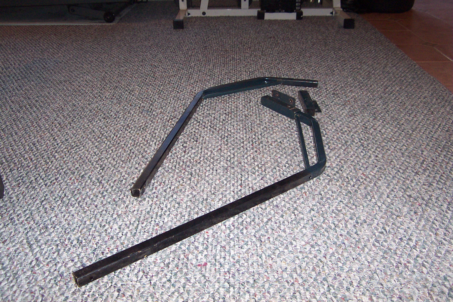

I made this set up for my canopy. The little bracket mounts to my rops. Then I take the canopy with the large brackets and drop them into the small ones and insert a holding pin. $20 plus shipping if you want them.
You can postion the canopy over the just over the rops and therefore it can be set back a little to cover the backhoe seat, depending how far your backhoe sits. I made a custom backhoe bracket because I wanted my bachoe to sit close to the tractor. I was able to cover the backhoe seat with these brackets.
Oh and to answer your question, I have plenty of room getting in and out of the tractor. I'm 5' 10".
