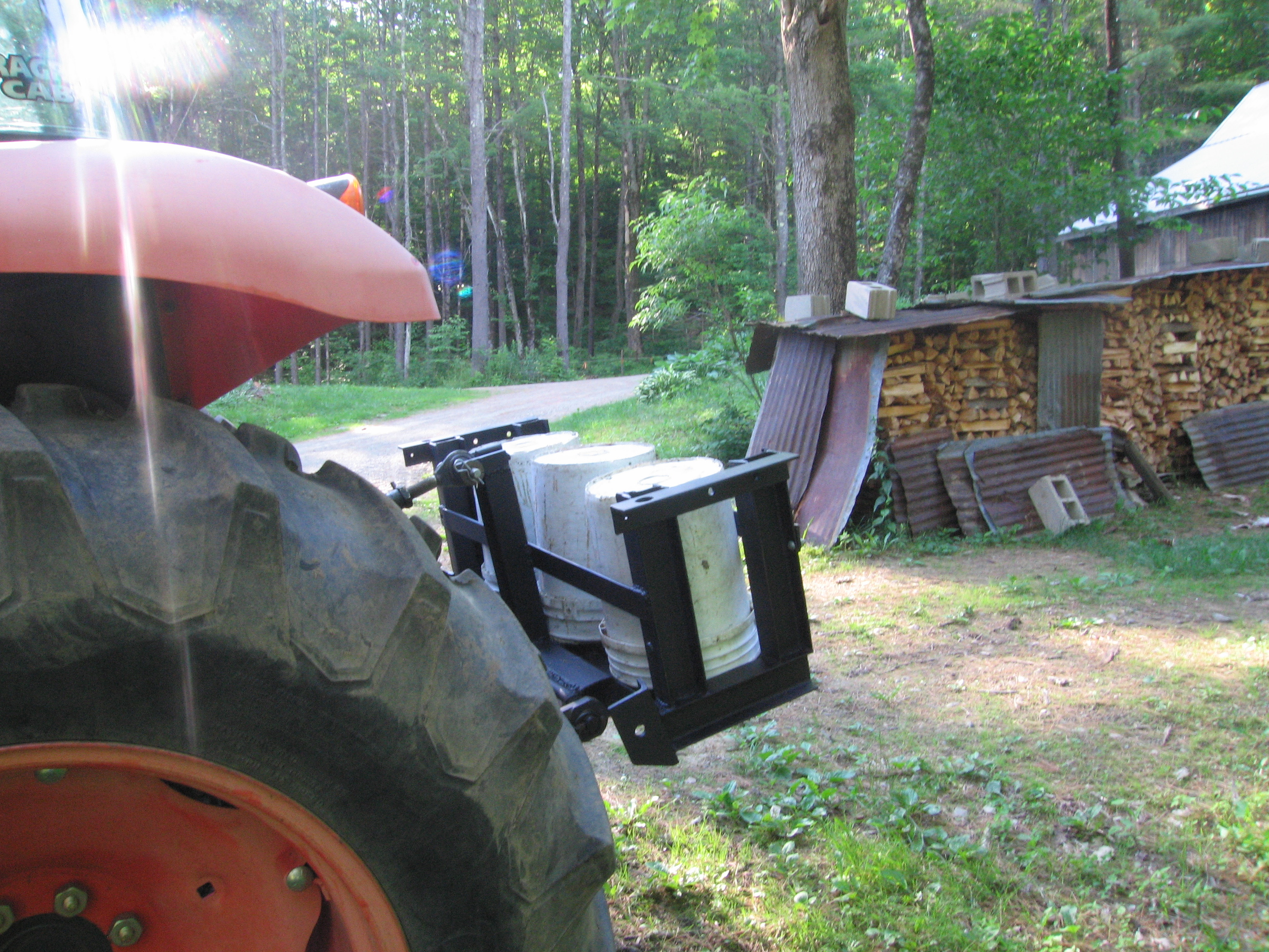

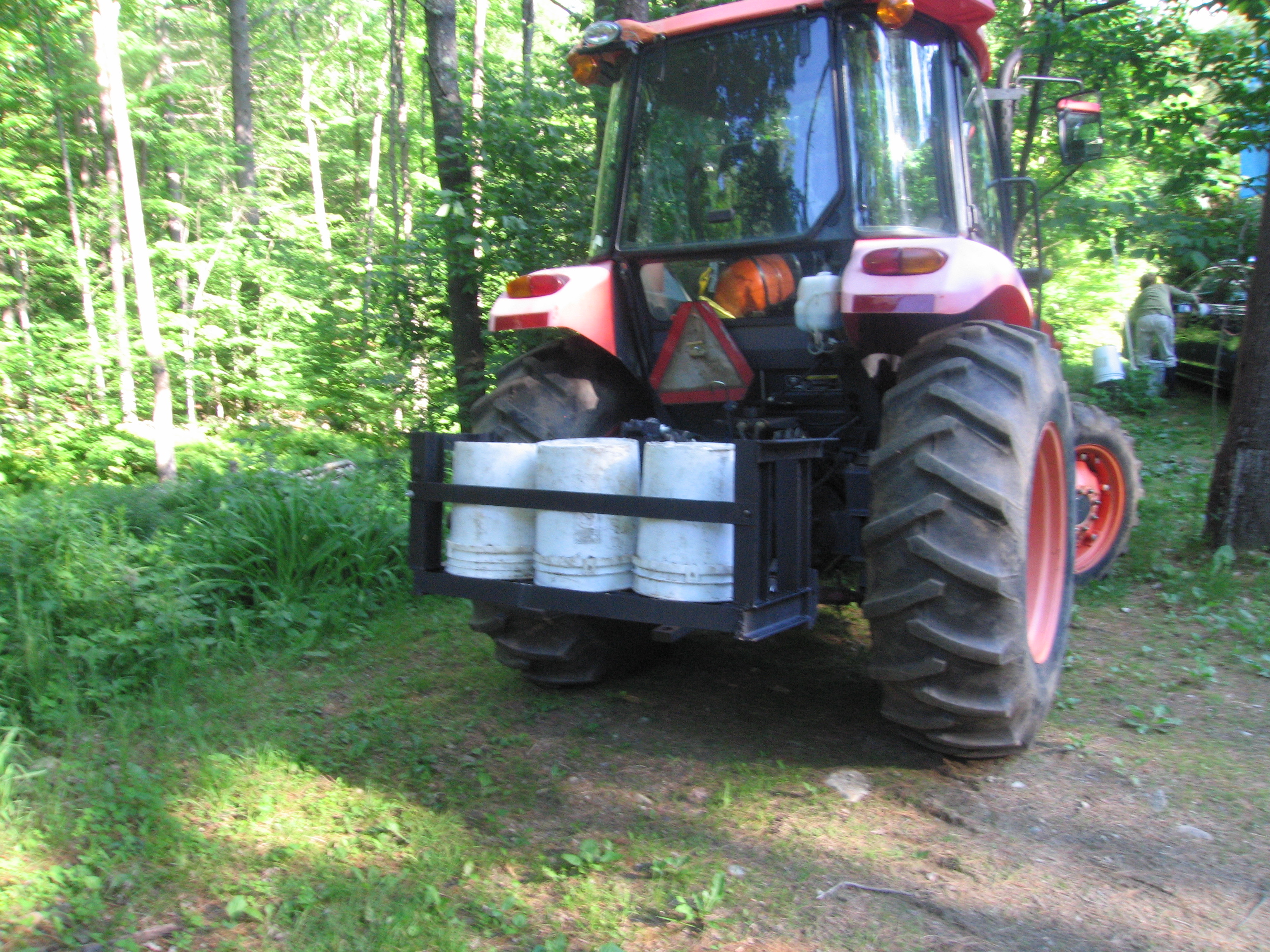

I was using my BB as a counterweight but wanted a more compact setup so I did not have to constantly keep an eye behind so as not to whack things with the BB in tight conditions.
I built this unit from scrap steel and leftover concrete for next to nothing. Weighs around 400 lbs
Along with the loaded tires, I can lift a full bucket of wet sand with no tipping and it is much more maneuverableView attachment 614085View attachment 614086

Using a rear blade for weight is a real maneuvering nuisance.

This is a low profile cb. A box blade sticks way out. I have work to do perpendicular to the roads in tight spaces, a low profile cb is the ticket. An mx5200 with a bush hog or box blade sticking out the back isn't nearly as short as a 55 gallon drum tucked in the 3 pt.

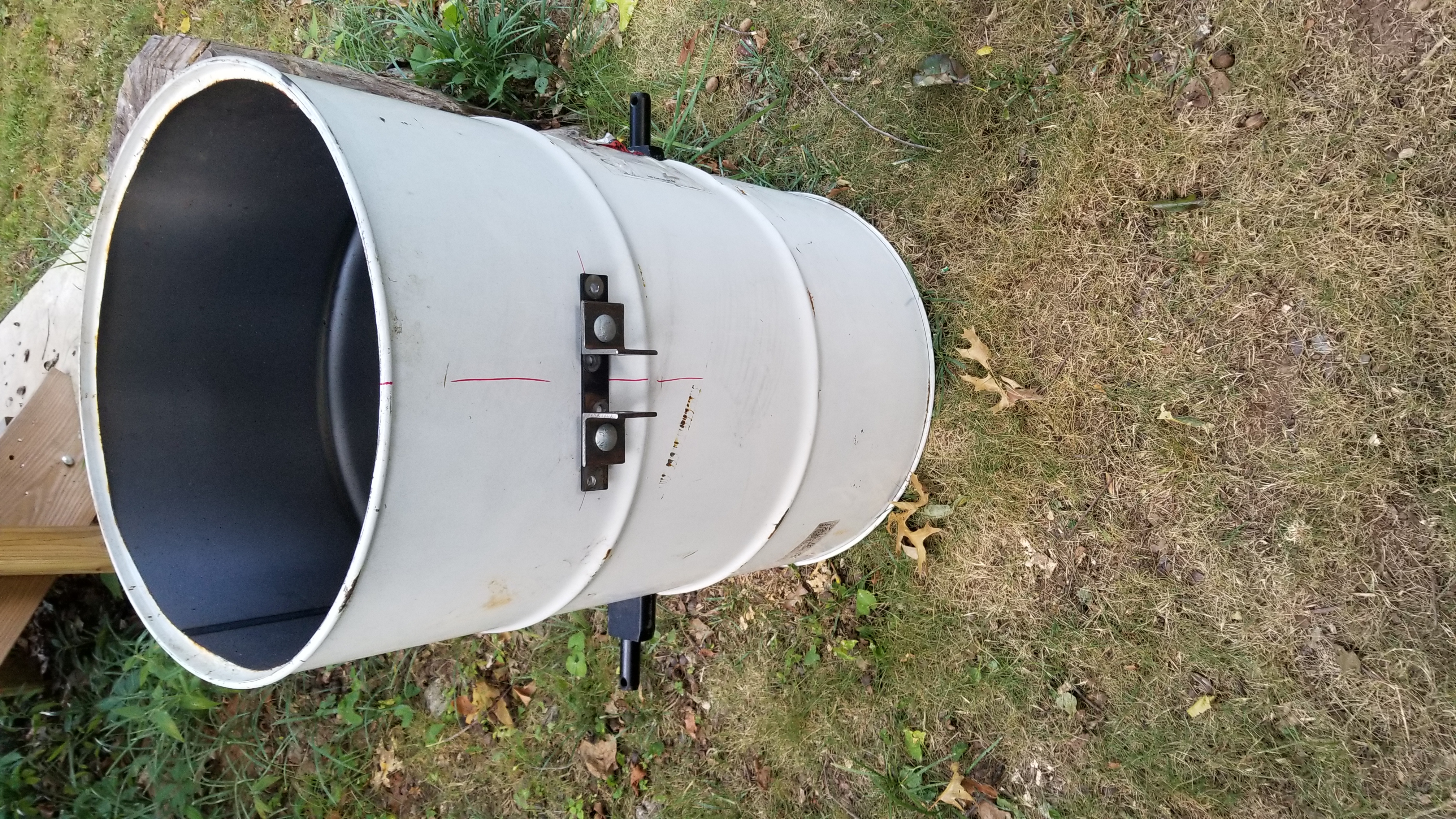

So I have a new mx5200 with filled tires and 100lb wheel weights on each rear wheel. I will be using the weight for a small profile counterbalance for mainly gravel and clay dirt fel counterbalance. My initial idea was to put as much scrap metal in the 55 gallon drum as I could fit, and then pour concrete over it to attain 1500lbs. It would be much less expensive and much less hassle to simply fill it will concrete and just get about 800-1000lbs counterbalance.
Knowing what I have and what I plan on doing, will a simple concrete counterbalance work? Or should I go the extra mile and increase the weight with scrap metal at 20 cents a pound?
Here is the beginning;

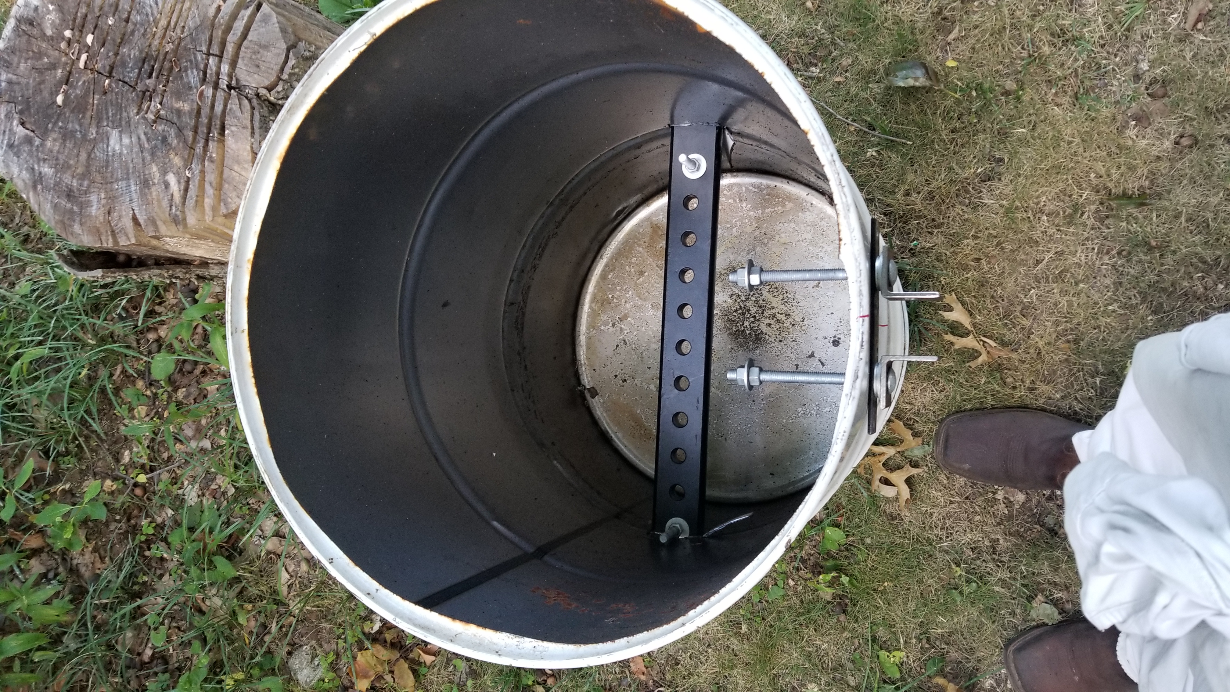

I would suggest putting bigger bolts in the top-link bracket and bolt a piece of steel between the bolts on the inside to keep the bolts from possibly pulling out of the concrete.
   / Making a counterbalance for my mx5200...give me your opinions...please #20
Bigger bolts? Those look like at least 5/16" bolts to me, maybe bigger. If they are 5/16 and they are only grade 2 they have a clamp load rating of 2175 lb each. That's enough for either to support the whole 1500 lb weight if they were actually holding it up, but they aren't. They just keep it from rolling as the machine moves, maybe help keep it upright depending on how high it's filled. The weight is pretty well balanced on the crossbar, so there's no real weight on the top link.
