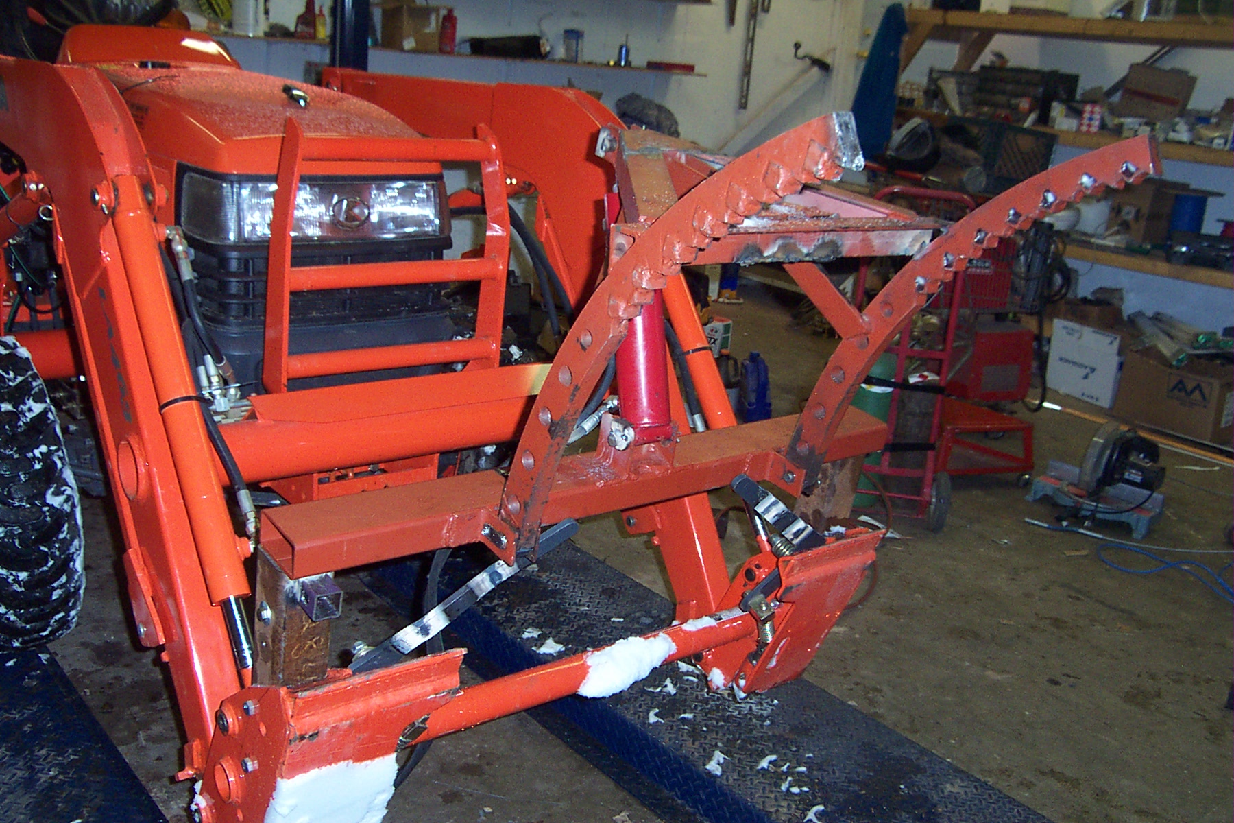

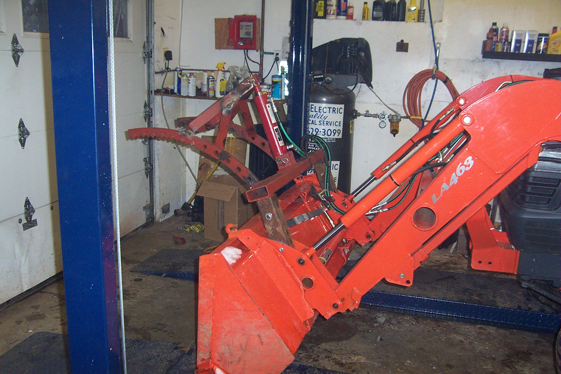

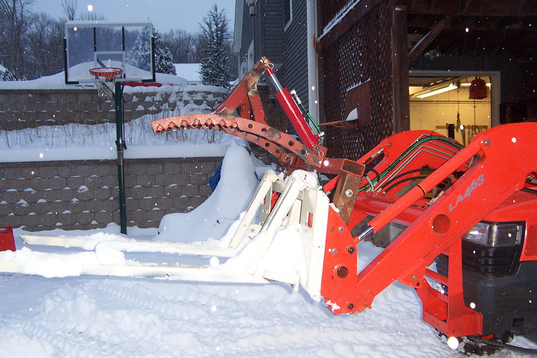

I been looking at the grapples that attach to buckets, but I have a quick attach bucket on my Kubota L3400. Drop the bucket and put on forks. None of the grapples were made to do what I needed, so I made my own.

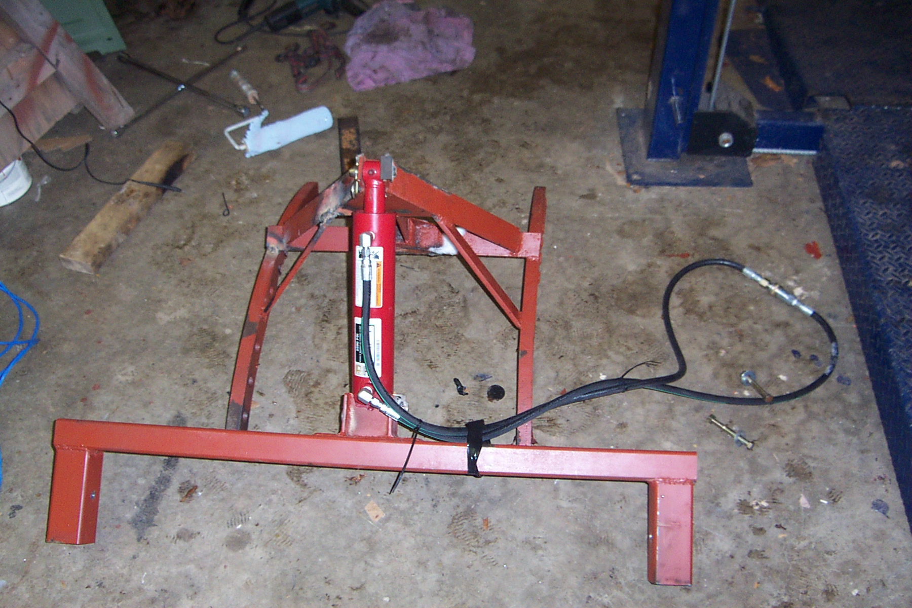

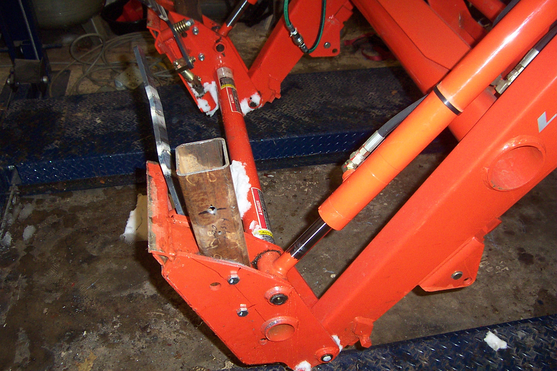

I bolted square tubing to my loaded arms, The grapple slides into these square tubing and locks in with bolts. The grapple is independent of the forks or bucket.

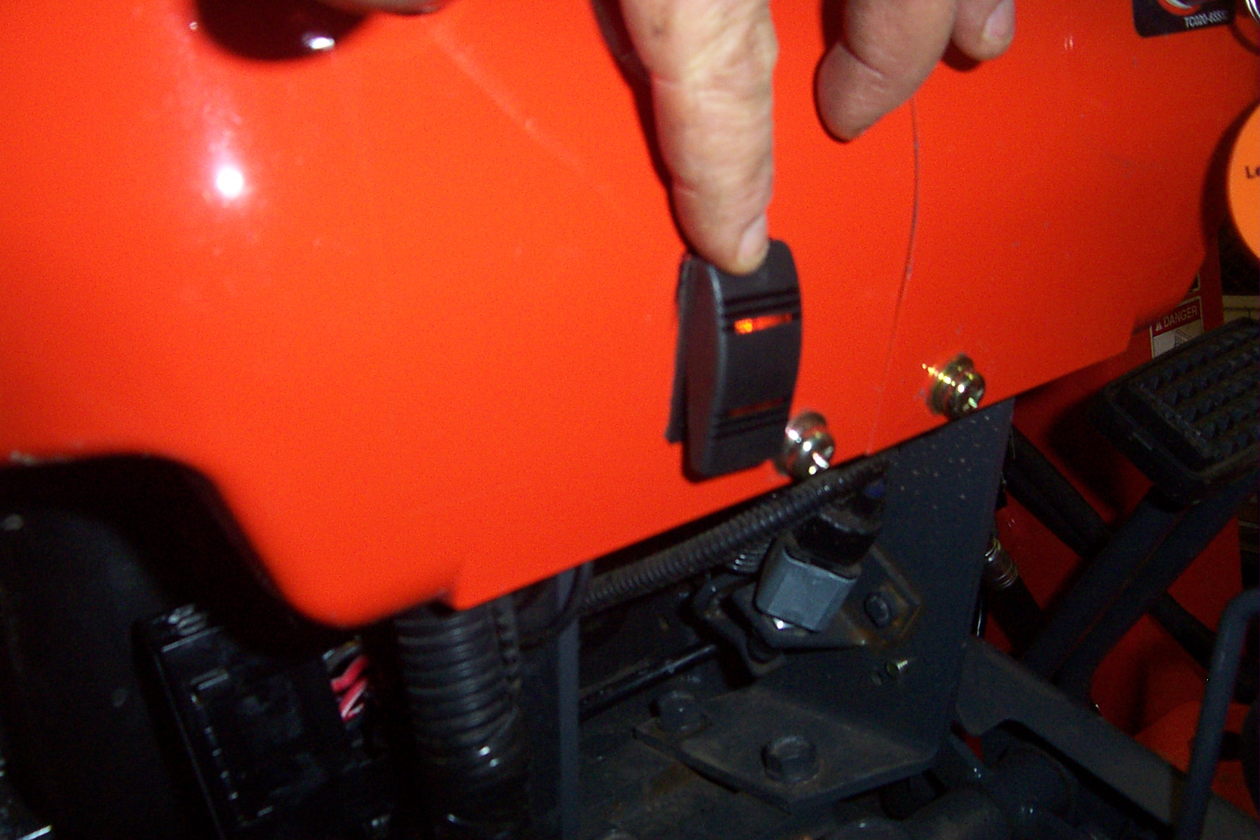

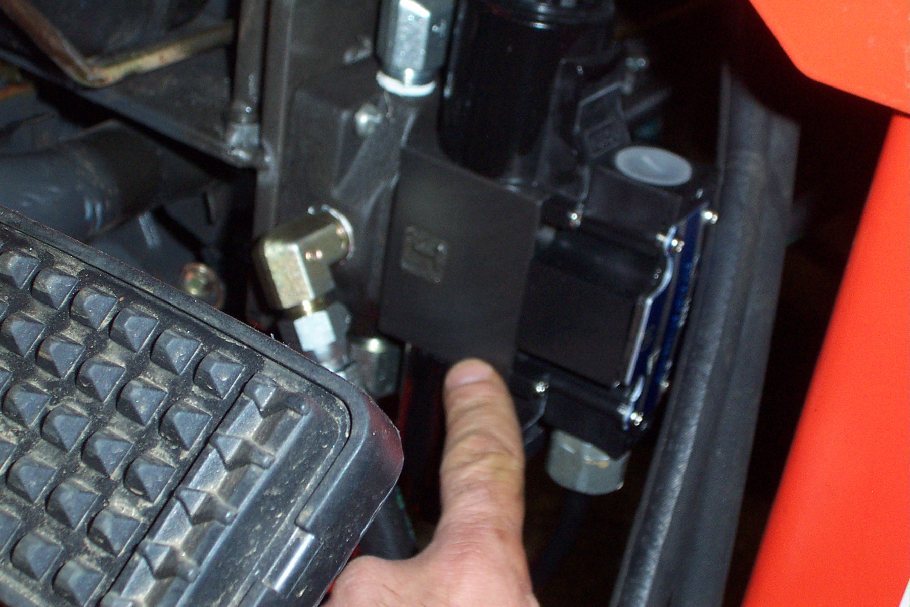

I used a electric over hydraulic valve which made the hoses clean looking and I put a lighted rocker switch on the dash to control the grapple

   / Making a different grapple for forks or bucket (pics)
I tested it and it works great with no flexing. I was able to pick up a pile of debris and crushed a garbage can in the process.
I will clean up welds, make it look good, then paint it.

Not much calculations, just looked at other grapples, found a 2.5x 8" cylinder on ebay.

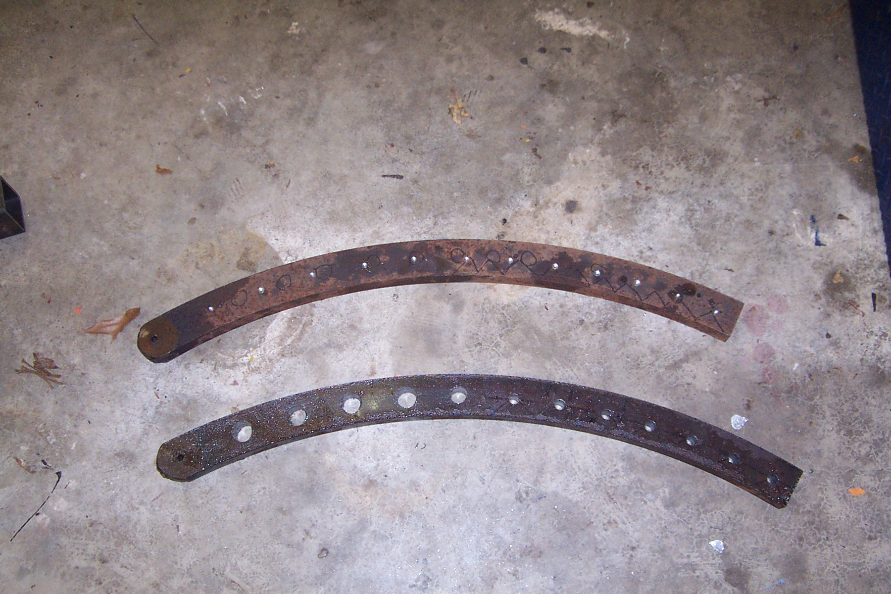

The arms I found at a machine shop (They made big round fixtures to hold jet engines.)
To make the cylinder stroke length, pivot angles, I used two different size PVC pipes so one could slide inside the other. Then played around with clamping different angles. I wanted this grapple to open wide, out of the way.
I had to cut the welds once and tweak it in. I wanted the fork option because I wanted to grab tree logs, then switch to a bucket for general use. Two bolts and a quick disconnect for hydraulics and I could pull off this grapple. But it will most likely stay on the loader arms and work with each attachment.
The square tubing that went into the arms fits tight and the bolts just hold it from moving out of position.
anyone needs measurements, let me know.
