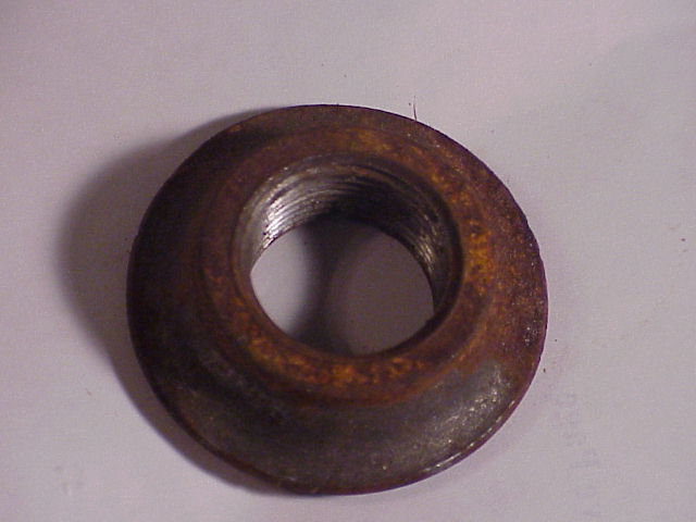

Picture of top........

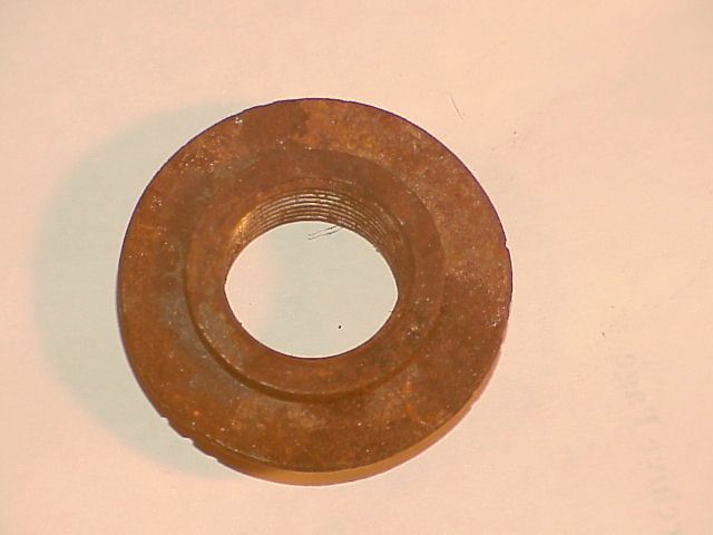

   / Making a hydraulic reservoir #12
Picture of bottom....... note the lip that goes into a drilled hole...

Hey you guys are great. This is exactly the information that I was hoping for. I will build it out of some bare 10 ga sheet metal that I already have. I’ll post a picture and let you know how it turned out later in the week.
Junkman. I have printed out one of your pictures and will hunt up one of those treaded bungs. Is that what they are really called? The dip stick suggestion is excellent. That would probably be better than dipping a stick in the breather cap hole.

They are called weldable bungs. As for the dip stick, you can also make it on the top with the same method. Either one will work. If you really want to get fancy, I can try to find the pictures of the sight glass device so you can see the oil and condition of the oil. I was involved in a truck body business at one time and learned a lot of the tricks of the trade. Only wish that I had learned to do more of the work, but that wasn't part of my job. I know theory, but sometimes it is the application of theory that I need to work on.... such as welding and painting.

don't use black iron fittings, anything but the pipe, will be cast iron.
you can buy steel couplings from plumbing supply houses.
the weldable bungs are not a big deal to weld in, keep most of your heat on the bung, and you won't have any penatration/burn through problems.
