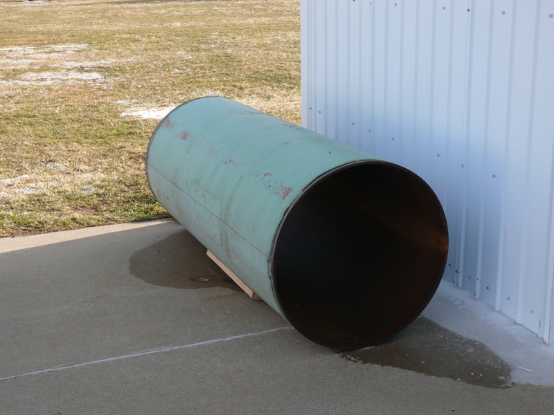

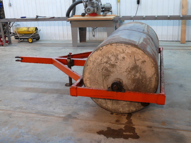

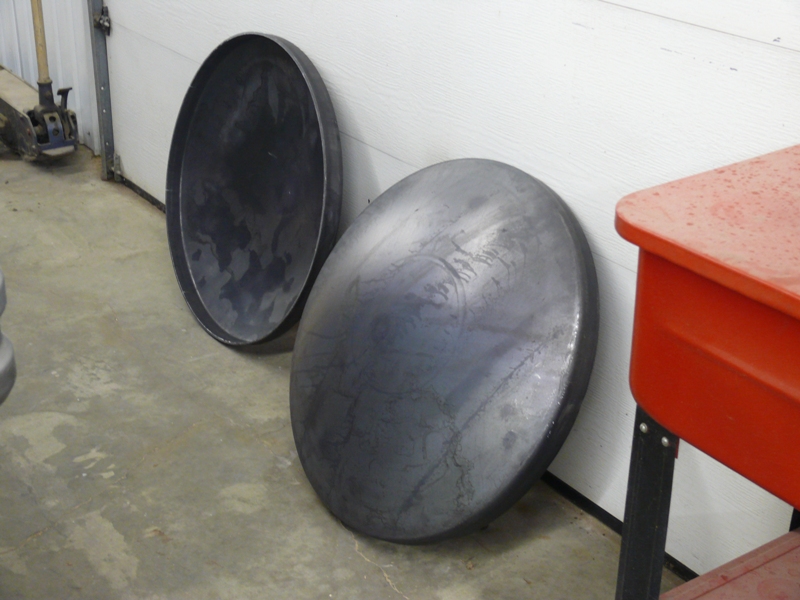

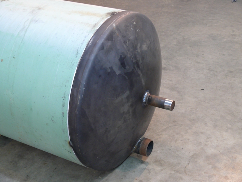

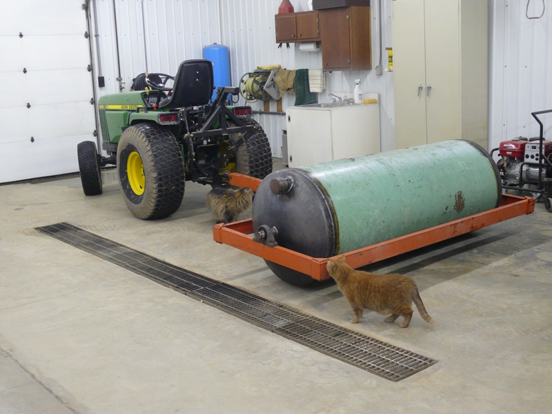

My first one was made from an old brine tank, 36" diameter x 7' long. I finally got tired of patching the rusty hulk and built a new one.
The old frame was re-used as was the axle and bearings. I made my own tank using a chunk of 30" dia x 1/2 wall steel pipe and purchased tank heads for the ends.
I've got 3 springtimes of use on it so far, couldn't be happier with it.
Ed

Got the heads from these guys. Tank Heads | Pressure Vessel Heads | Home | Commercial Metal Forming Good people to deal with, just remember they will probably ship truck freight. IIRC, the ones I got were 3/16" thick.
Yes, I fill it with water.
On a roller this big/heavy the shaft for the bearings needs to go all the way through the roller
Ed
