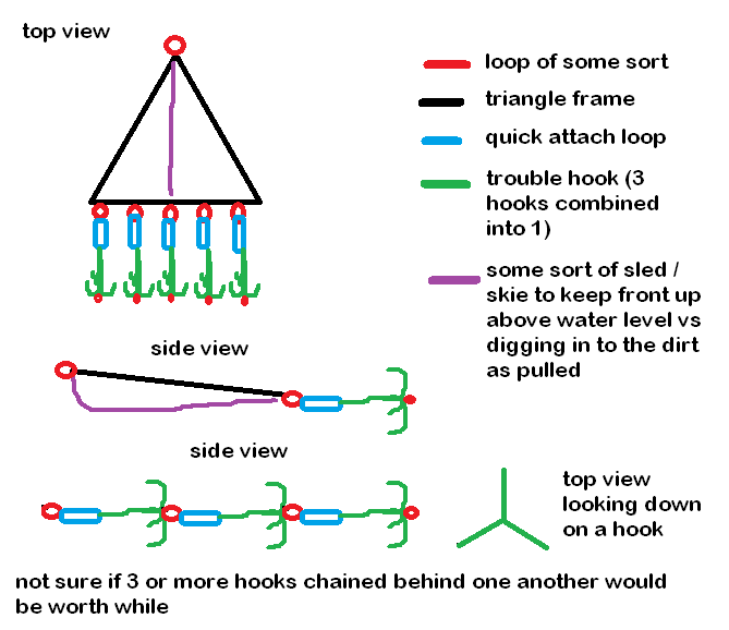

I have a pond in my yard it is stream fed always running,so I was thing of making a rake to clean the pond.I was thinking of attaching some steel pipe inside of each other bolting them together as long as I can then attaching a cheap lawn dethatcher from home depot and attaching it to my forks on my loader lift rake assembly go to edge dropped in and back up slowly with little of pressure on the dethatcher do you think this would work.
if i had a large enough cable winch, to wrap a few hundred feet of cable on it. that would of been awesome for me. granted winding up cable can be rather slow. but that is what worked for me. going to fast and i would skip areas of moss / weeds. going slow gives chance for the little tiny fish a chance to swim out of the moss.
--1/2" rebar bent and welded to a "trouble hook ( 3 fishing hooks put together for say catfish lures and like), purely guessing 2 feet long, then end bent into 1 to 1.5 foot diameter hook end.
--a triangle frame with a sled down the center, to keep the point up.
--the trouble hooks would need "quick connect loops" so i could undo a single hook and pull it out much easier if it got tangled up.
tossing the dethatchor out along with cable and everything was not an easy task. if you had a "boom pole" attached to FEL so you could some how attached it and drop it off out a foot or 2 off bank edge would help. maybe just a cable or rope, that was tied on to FEL, ran down to the thing, then back up to bucket. so ya not sinking in mud trying to unhook things.
last minute thought. maybe a couple extra hooks instead of 3 hooks combined into 1. maybe 5 to 6 hooks combined into one. the ) shape of the aluminu hooks i had. seemed to work great. if i was able to keep the thing pulling correctly. the very outer edges of hooks would cause the moss to build up in the center. and the outer edge hooks would just keep bring in more moss.
to note it. i did get to a point a few times were i just completely over loaded the setup i had with the de-thatcher and alumin hooks. and i just had to reel it in per say. clean the mess off. and then go back and toss it out again.
