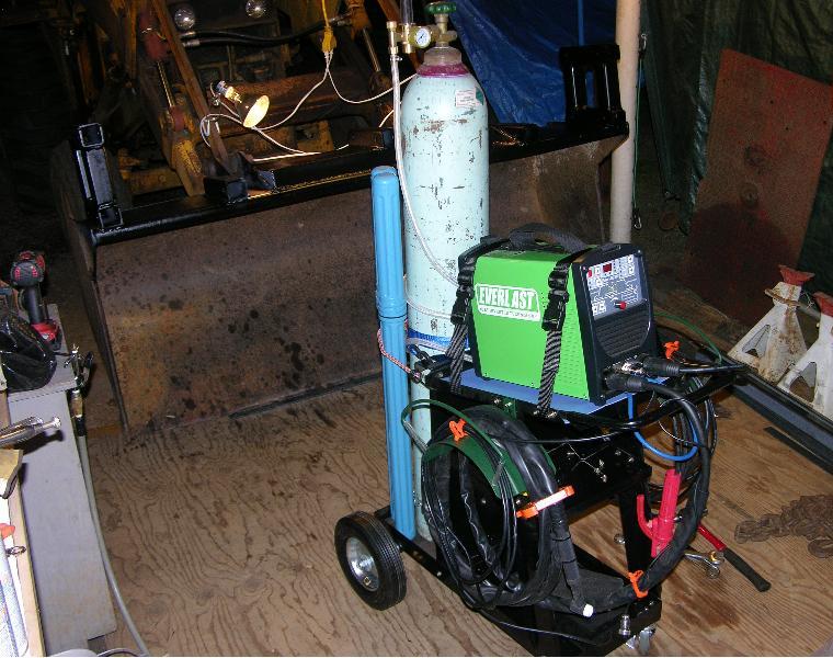

Yeah, all I really wanted was a tig, don't plan on doing aluminum any fancier than my 30A spool gun can do, so saved about half by not getting AC tig.
I was talking to Mark about the Power iTig200 (predecessor to mine) when he asked if I'd be interested in a deal on a demo machine - when I saw all the improvements I went for it. I figure the stick side is "free", but will be useful since I can run it out in the field on a genny (I have an 8 kw, which will NOT run my old transformer workhorse) - since one of my thousand-odd projects involves welded H braces and about 3/4 mile of new field fencing, it seemed like a good plan.
This new rig is so light, if it were smaller you could almost put it in your pocket ('course, the argon bottle might get a bit heavy :laughing:
Here's a shot after I put bigger solid tires and locking casters on the Amazon "hot max" cart, along with garden hose hangers both sides and some DIY hold-down straps... Steve
