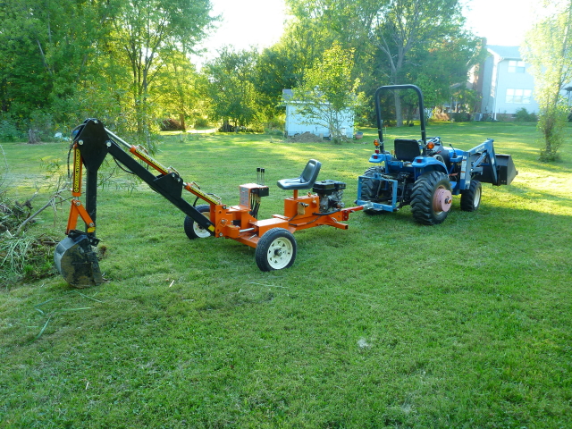

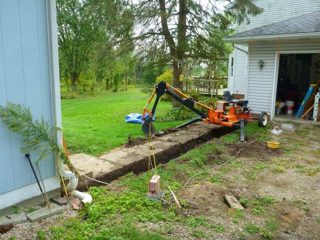

I bought my HF backhoe in May 2008. I was in the process of making my own but that project kept getting stalled. So after about 3 years I broke down and ordered the HF from the local store (no shipping cost). They said I could return it in 30 days if I wasn't happy. To my surprise it was probably better, heavier built than what I was building. I sold my "kit" of misc parts I had made.
You can search this forum for these units and get more comments. Some will dis-credit these units as not being a "real" machine but for small jobs that are too much to dig by hand or too small (or pricey) to hire out, mine has worked well. I have a very rural 2.5 acre yard. My HF trencher has done some serious work...although not as fast as a full backhoe. I've dug up and replaced a couple of drain pipes. Dug out old fence posts. Dug/pulled out numerous small trees. We have a small pond and I use it to remove the small willows and ditch lillies that invaded the banks. I recently dug a 25 foot x 18" deep trench for an electric conduit to the pole building that was all broken bricks and tile.
The HF looks to be a longer machine and maybe has a longer reach than the Jansen? I'm not familiar with that unit. With this type of machine you cannot lift a heavy load UP well unless you have the outriggers firmly planted and are pulling against them. For light digging I often leave the wheels on the front and have the hitch end attached to the tractor. This makes for easy and quicker manuvering. Moving with the outriggers is a slow "crab" like manuver. I usually add extra weight to the tractor hitch if using it that way because you WILL tend to lift the tractor if you try to lift too hard. I often use behind my 16 hp Cub Cadet but the New Holland TC-21 is a better (heavier) choice.
The only modification I have done is to extend the hitch out about 2 feet to allow easier manuvering when backing the unit around (less jack knifeing). I did add a small plastic bottle for a hydraulic tank overflow to catch an occasional squirk of oil out the vent hole. I have gotten pretty good with the single function controls so do not feel any need to alter.
If you intend to tow on the road you might want to take a hard look at the bearings, wheels, tires. The HF might not be rated for road speed. Also (depending on your state laws) in Ohio a single purpose trailer like a log splitter, cement mixer (or this bakchoe) does NOT need a licence OR lights. You might check into that.
