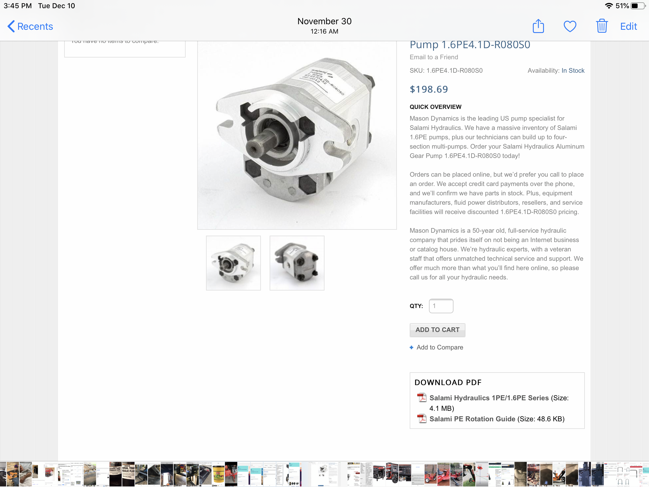

I will use mine for awhile and then I might upgrade to a 13hp motor and order a bigger pump locally, the 13 hp motor has electric start and goes on sale once in awhile for around 300.00 and then all you need to do is grind/oblong the 4 holes on the pump housing to fit the bigger motor, think each hole needs to be about a 1/8th inch longer on the housing that the pump mounts to.
Here is the motor.
And here is the high flow pump so you can use two controls at the same time and speeds the hoe up a bit.

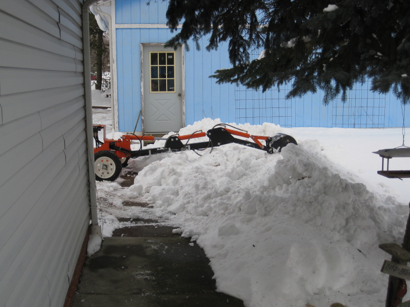

I got my "trencher" in 2010. The following winter we had a particularly heavy (for us) snow. With the Cub Cadet I always try to plow the snow down slope past the sidewalk between the house and pole building. I had a pretty good pile that froze down. I couldn't move it any further with the Cub and more snow was forecast. I did not yet have my New Holland with loader. But Hey!! I did have a backhoe. And I certainly needed practice! I had some fun breaking up the frozen snow pile and pushing/leveling out that pile of snow.:laughing:

if you want to get better with the hoe, practice just running the bucket just over the grass or snow, keeping the bucket teeth level to the ground. do this all the way extended out to fully retracted. good experience.
