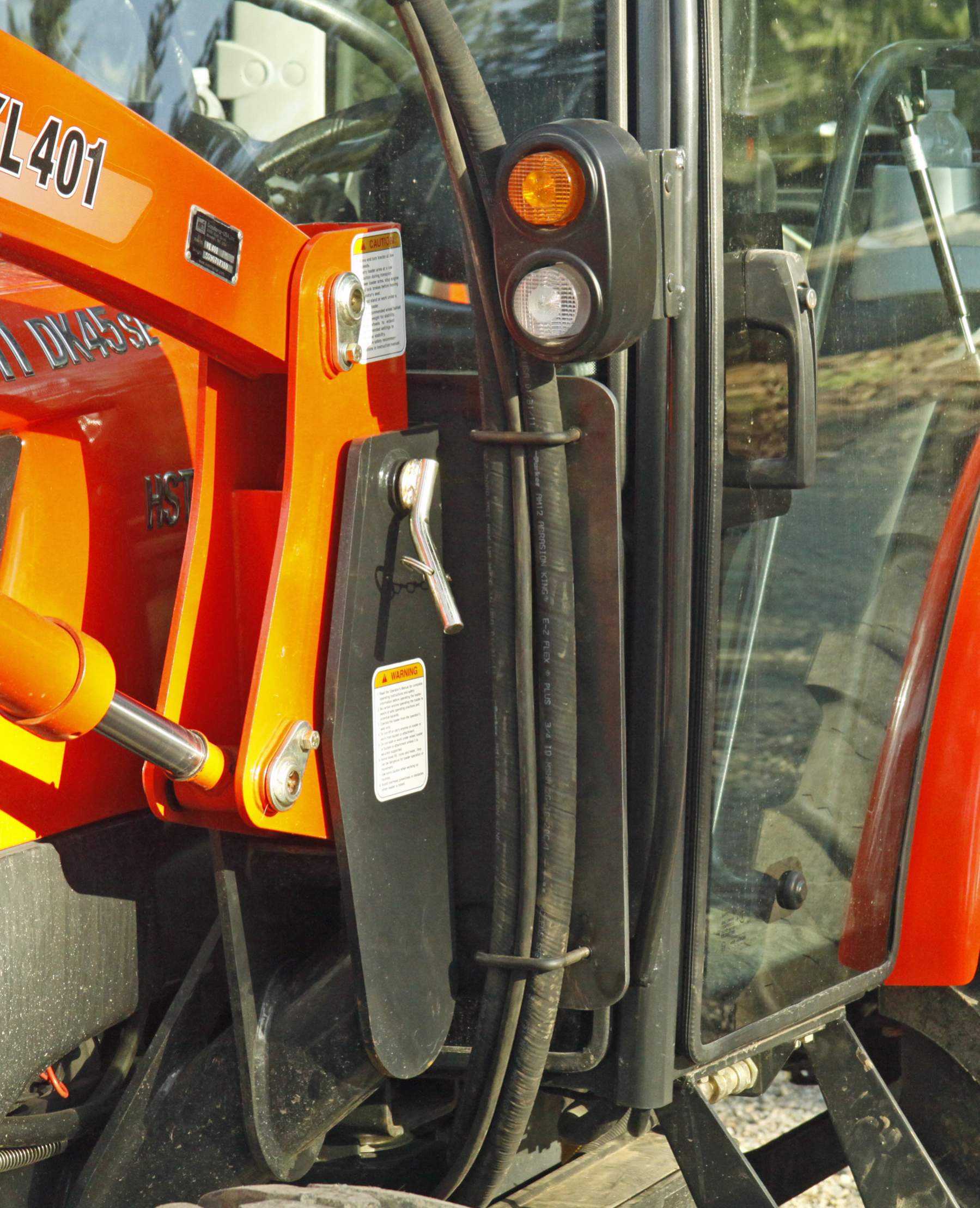

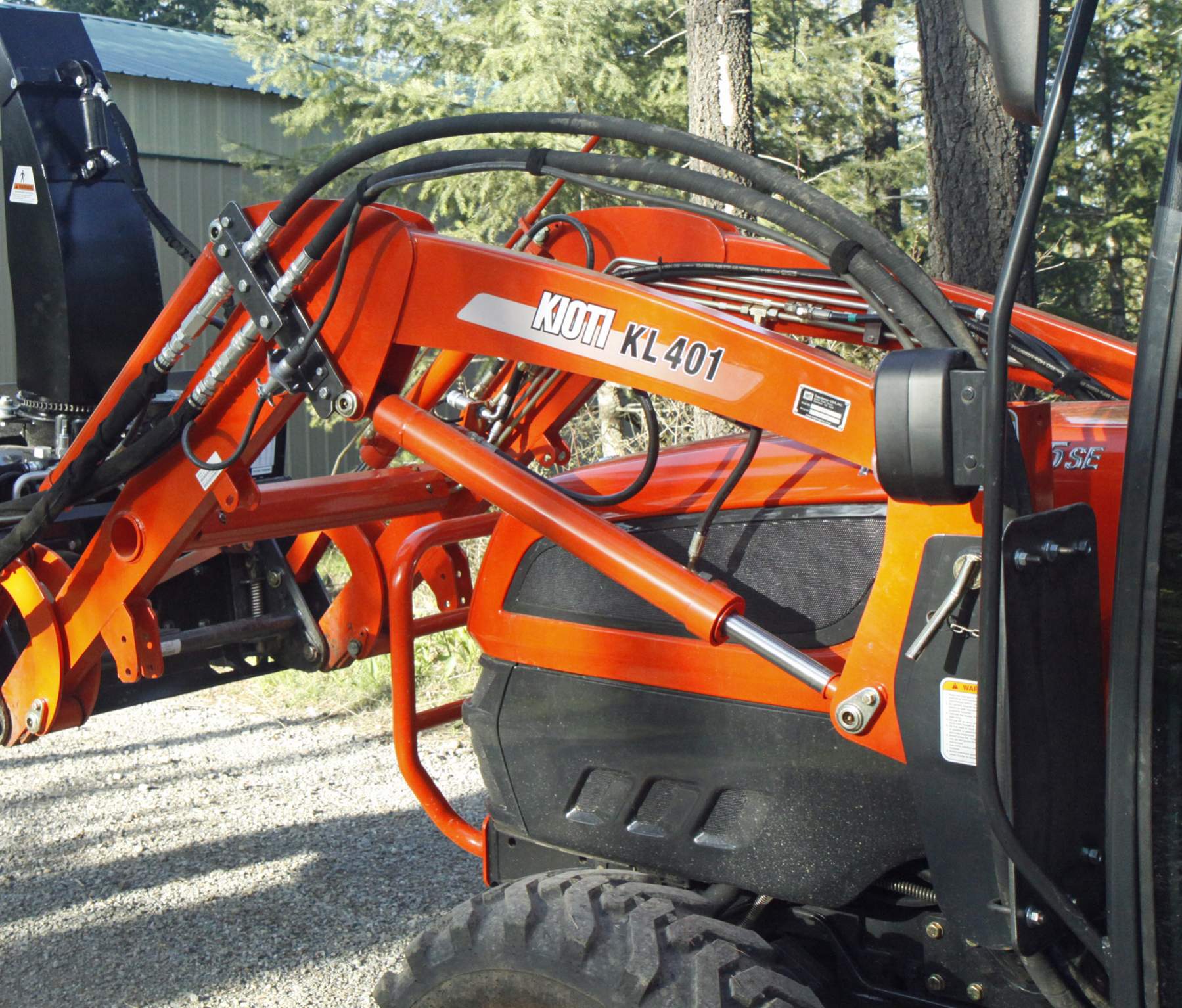

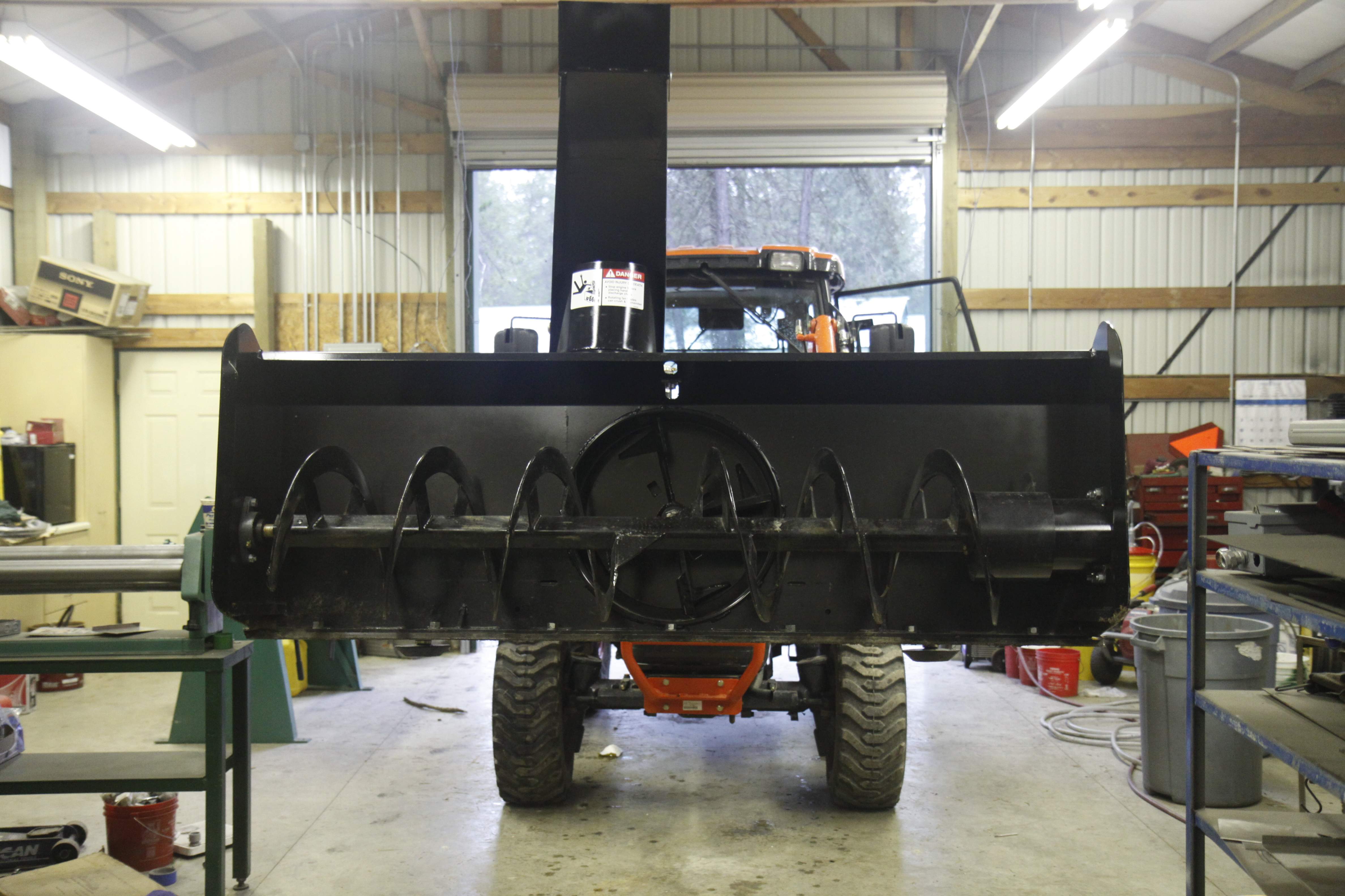

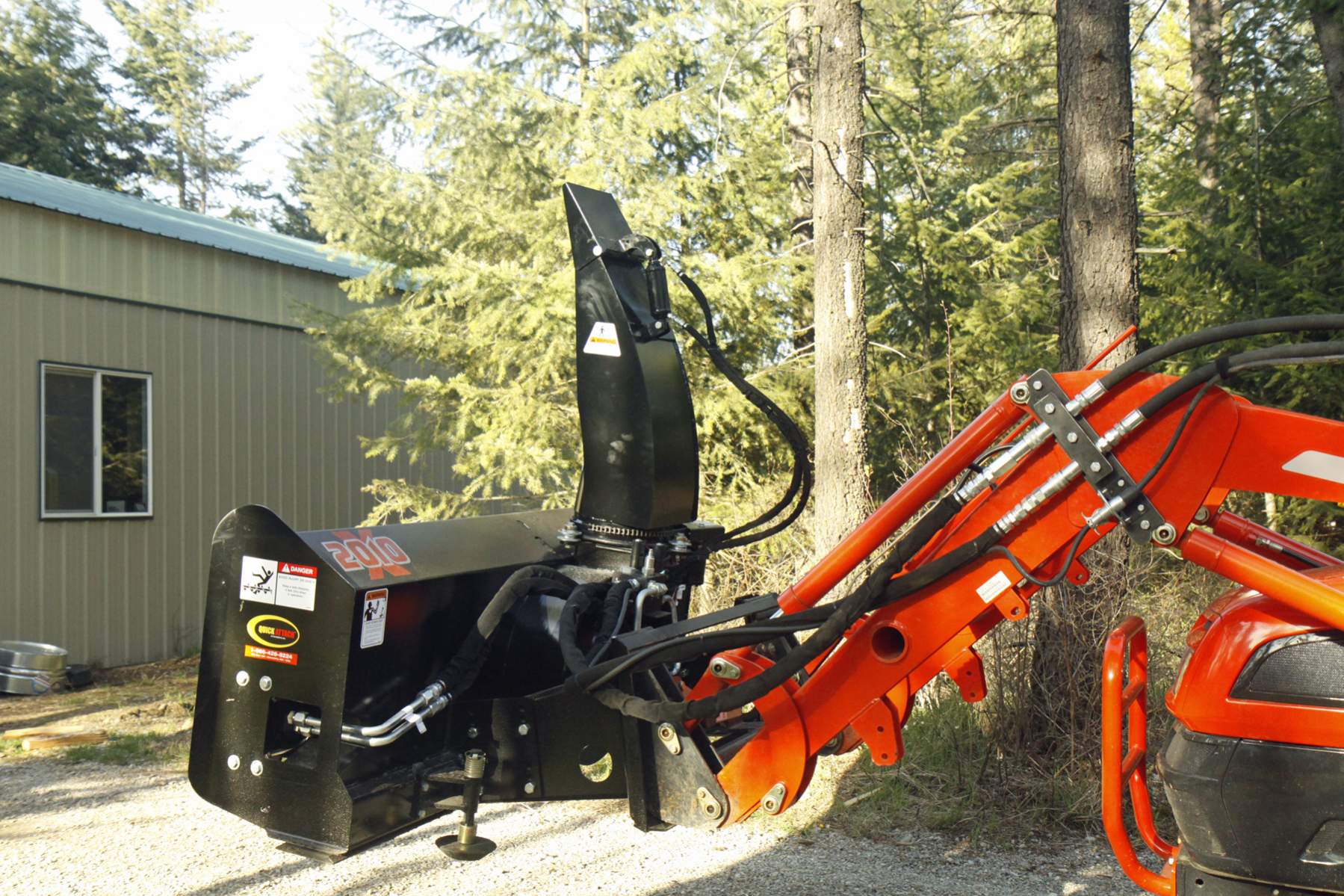

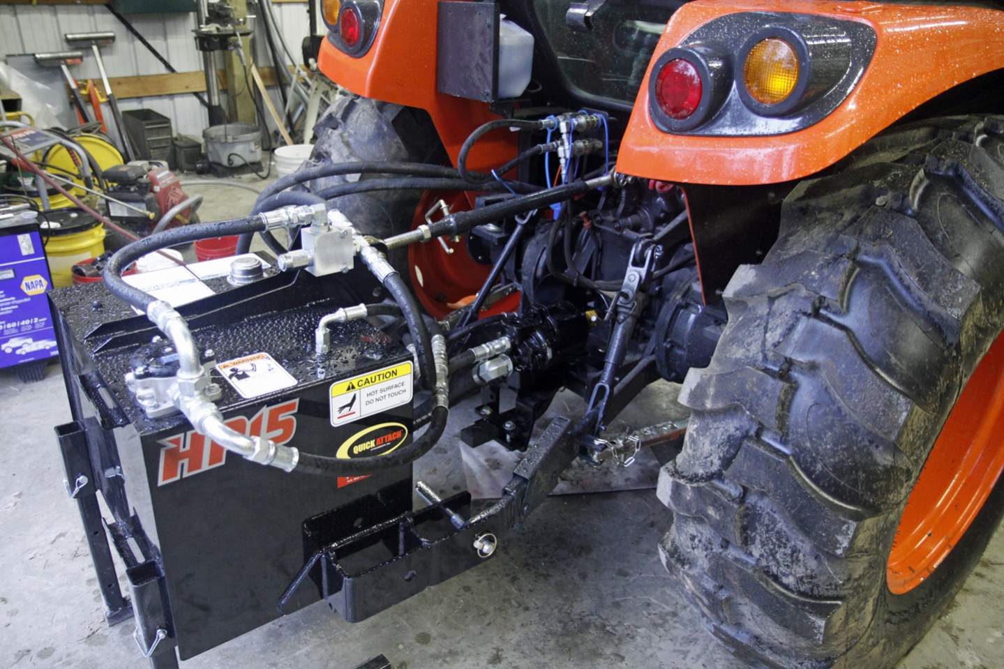

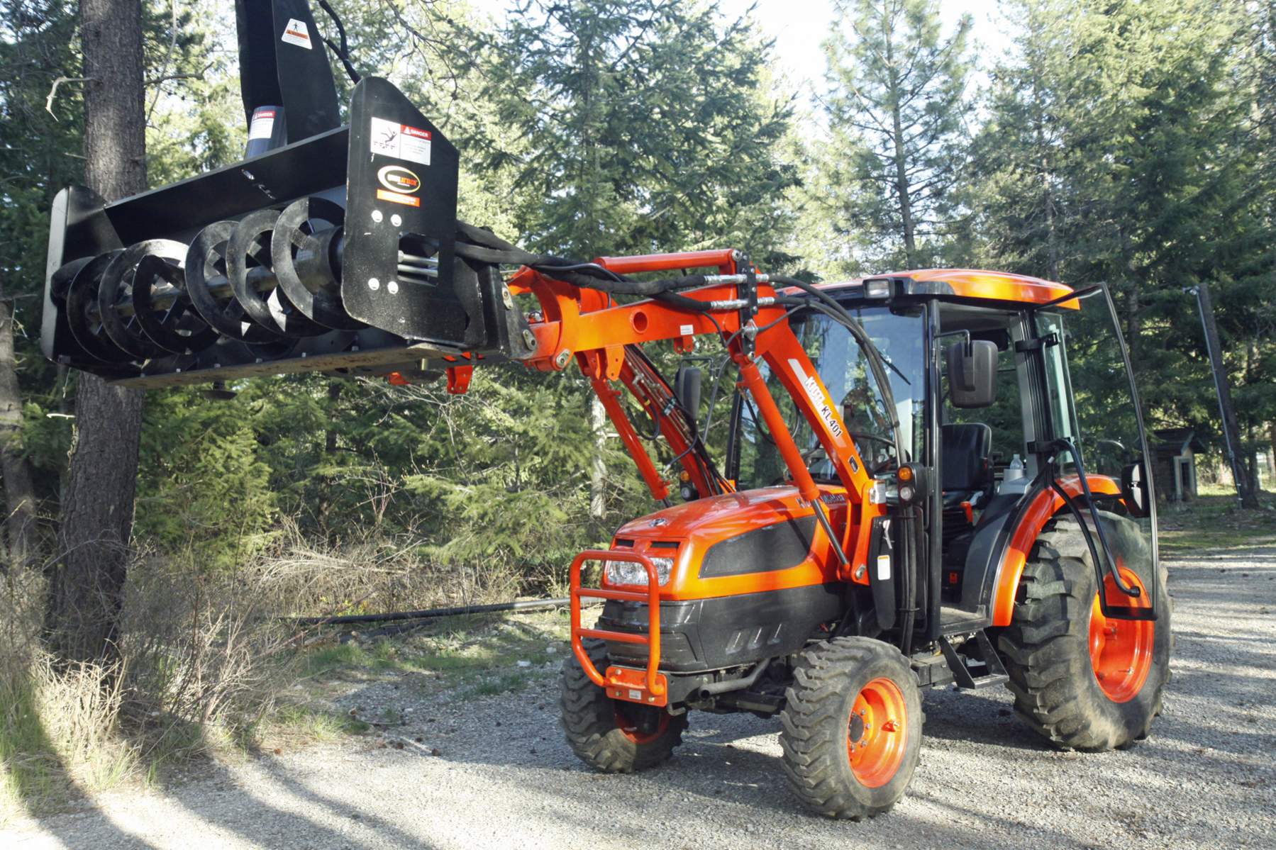

Not sure if anyone is even interested in this thread, but i have been pulling out the hair thats remaining in my head to try and make some removable brackets for threading the twin 3/4" supply hydraulic hoses to my "quick attach" brand loader mounted snowblower.
The manual just says to zip tie them to loader arm...but i don't think so. i really want the paint to remain for a few years at least.
I pondered long and hard and i think i came up with a good overall plan....ill see if it survives next winters snows.

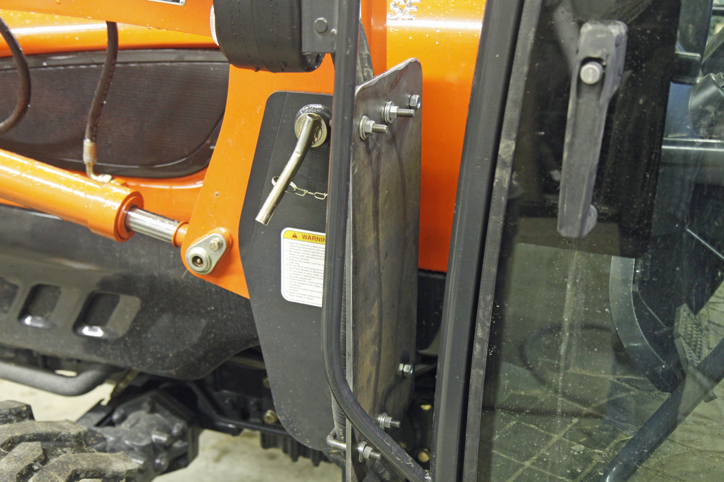

I drew up and plasma cut some 1/4" stock for support plates and found several places on the loader to install them. I had to thread some 3/8" round rod and heat bend the support brackets. I tried some pre-made round ones, but there was way too much slop in the hoses.

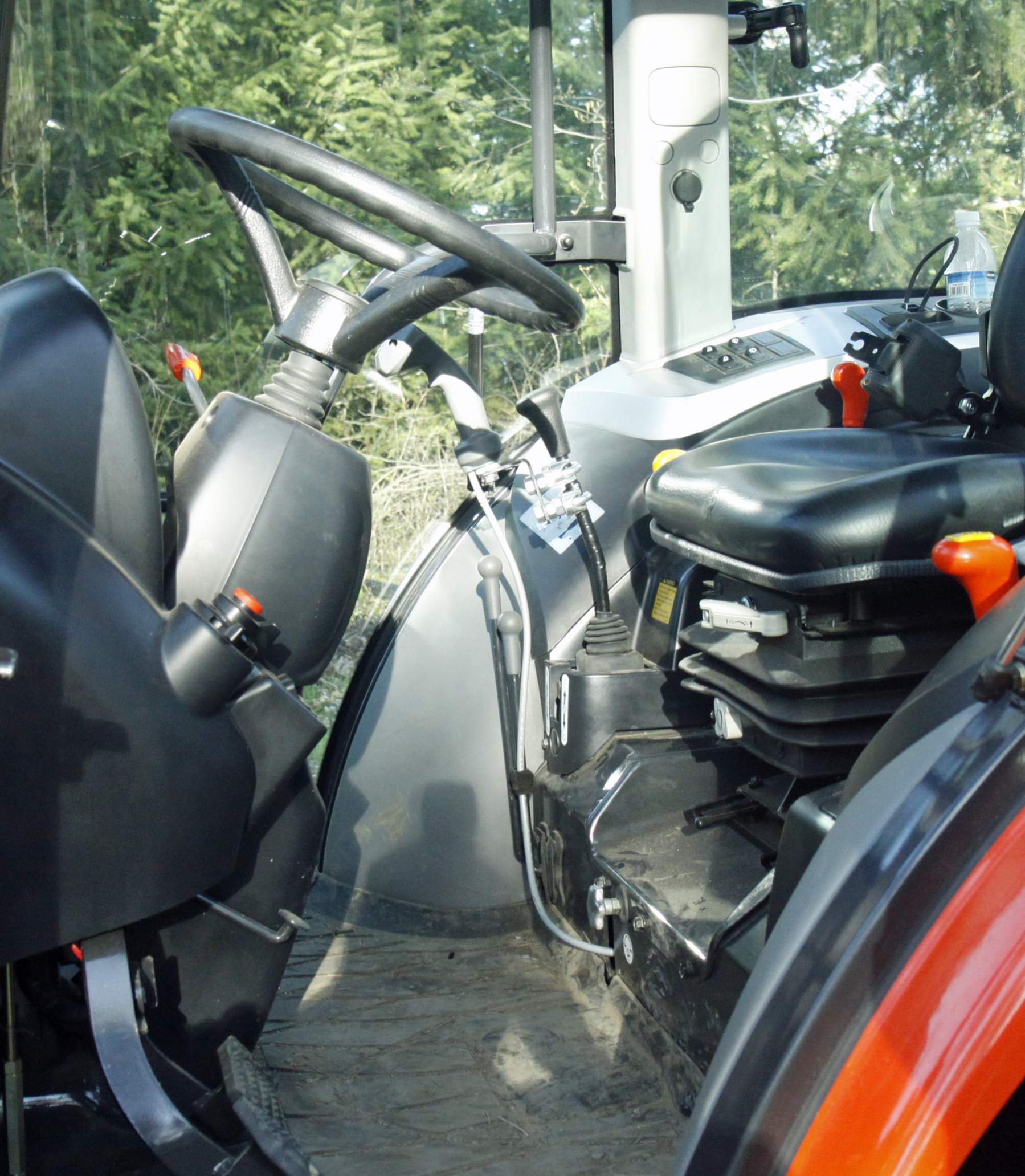

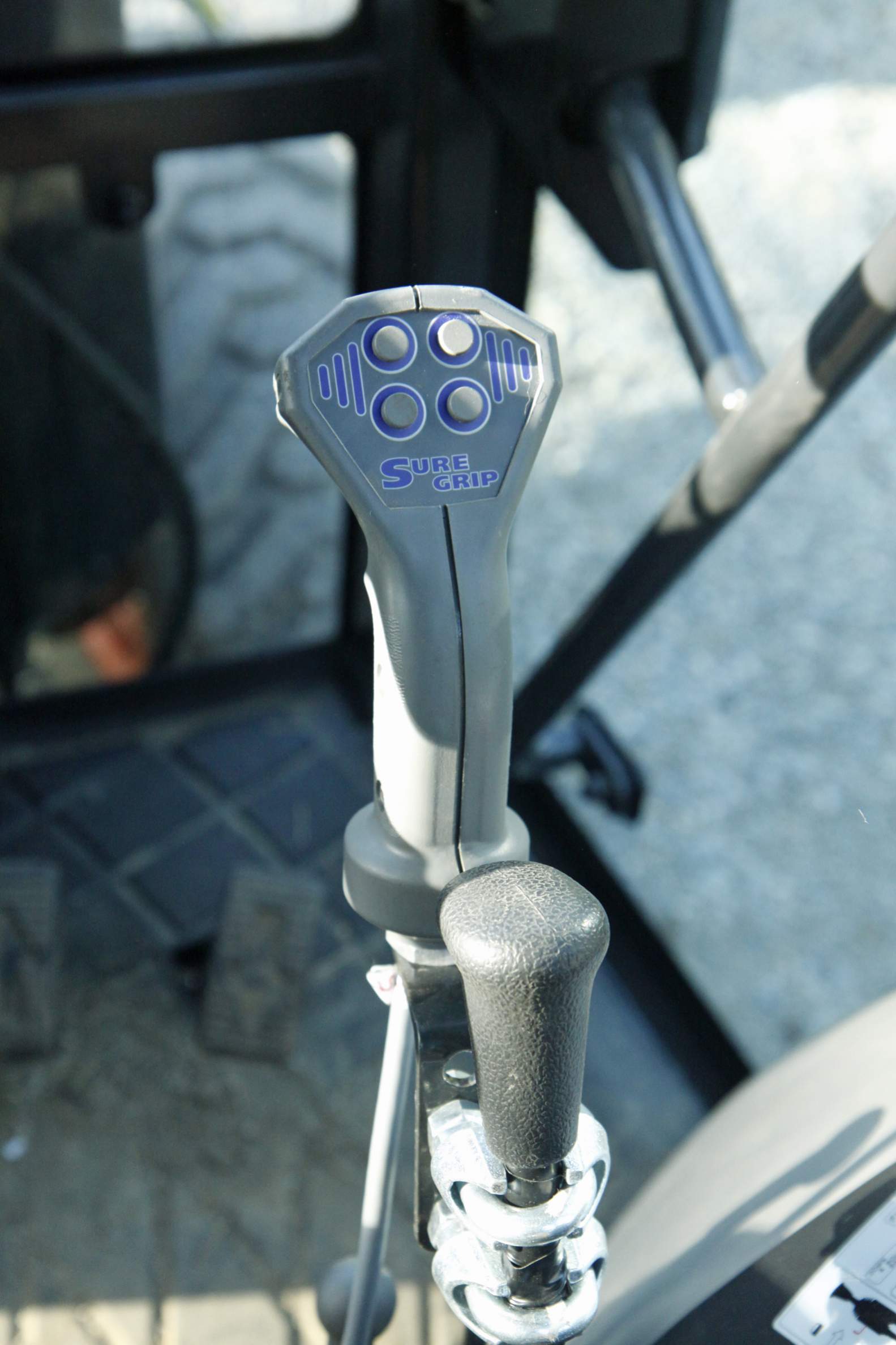

The unit has an electrical driven hand control for chute rotation and deflection. The electric current runs a servo that forces hydraulic fluid to move/deflect the snow. pretty clever design really. Operates very fast.

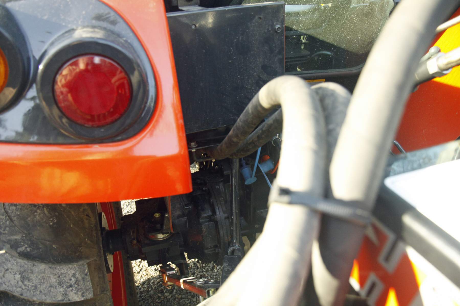

Routing the hoses around the rear tires and still allowing for rear tire chains was also a chore. i hope this takes care of it. Ive tested it thru full range of motion, and the hoses never touch anything......
the snowblower reaches high enough to snowblow my roof :laughing: :laughing: :laughing:

Thank you.....i tell you, its taken quite abit of work to design a way to do it. I just couldnt do the zip tie thing.
My back has taken a beating over the years...i just couldnt do it anymore
all the brackets are removable, including the inside control. All will be powder coated this week.

So, the PTO drives a hydraulic pump which, in turn drives the blower. And the controller clamps to the loader joystick?
That's a very nice rig!!!
How much PTO HP is required for the PTO pump?
And, if you don't mind me asking, how much did this rig cost you?
BTW, the link in your first post doesn't work...I assume it's supposed to be a link to another thread.

yeiks..im not sure what that link was doing there...i never placed a link in the post. but i removed it. Thank you
This particular pump has a minimum pto HP rating of 30 HP.
The controller is clamped to the joystick and is pistal grip style so i can control the blower with the grip. my hand rests on the rubber cap of the original control. I used some split bolts for easy removal off season.
The blower and powerpack ran $10,335 incl all hoses,electrical , powerpack and blower , quick attach hose ends and hardened skid shoes.
Before i got this unit, i was thinking of getting a 84" rear snowblower, but that ran almost $6,000....and i had to back up
