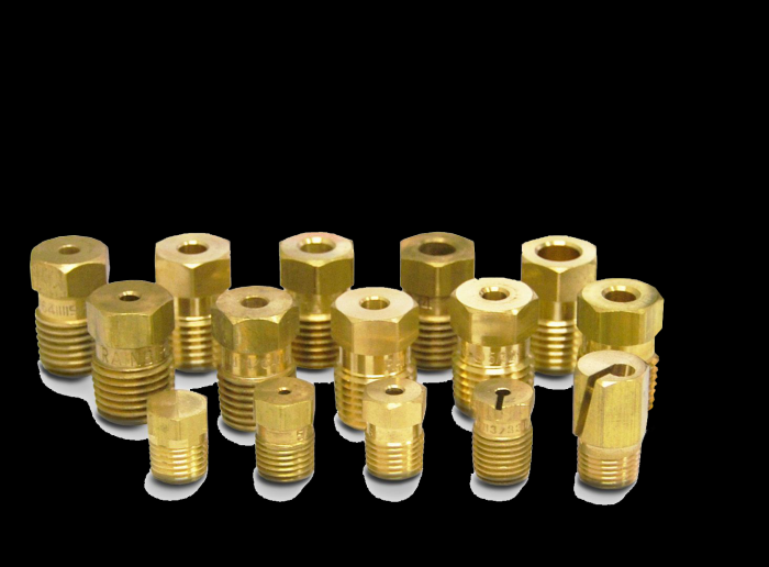

Interesting. So if these are standard - or as you say, "proper fire sprinkler heads"...there is probably information on coverage, pressure, flow rate and such. Do you have any tech specs you prefer?
I'm suprised that half inch copper is large enough, but that just shows how much I have to learn.
I'm thinking that it would make more sense for what I am doing on our property is not to try to put a fire out, but to simply making it more difficult for windblown embers to ignite a larger fire.

I am going to some effort - it seems worthwhile....and of course we all need projects.
My original idea was to run the pipe right along the peak - use sprinklers and let it just drain down the side of the roof and eaves. However, that means a lot of up high work for my aging old body. This all started when I did some tests years ago on the top grade of "fire resistant" asphalt shingles and was sadly disappointed. So this year when the time came for a new covering I put on steel. Now the roof covering itself is protected pretty well and I blocked in the soffits with concrete boad. That left the barn sides & large doors which are gradually becoming covered & trimmed with cement board.
The total length will only be about 150 feet. It's a smallish barn. I like the de-burrng idea to make a well to shape the spray. Wonder if that will work?
Next task will be to make up a section of pipe and play with the various well and whatever shapes. See if it can be made to spray.
The pop-in sprayers were my first choice, and if I can find some that seem decent quality then I'm going to make up a test section for that as well.
I hear you on the 1/2 " pipe not being large enough volume for the entire run. Good point. I'll put a Y manifold so I feed two lengths - and upsize the pipe too.
Thanks for all the good ideas,
rScotty
Consider 'Punching" the holes with a small screwdriver type bit. Aligned with the axis of the pipe they might spray a 'band' instead of a cone to wet the sides of the structure.

I am a retired firefighter who was the Fire Marshal for a large department.
I applaud your efforts, but application of water should be the last step in keeping your place safe. First and foremost is that if you are concerned about a grass fire being the ignition source you need to be proactive about keeping a clear space around your structures so the fuel is not close enough to ignite them. Even 20 feet of clear space will greatly lower the chances of fire spread. Look here for more tips: Wildfire preparedness tips
If you do want to add protection my suggestion would be to use what are known as "deluge" heads. These are open fire sprinkler heads that disperse a chosen water pattern. In your case you can choose a head that deflects the spray pattern down to wet the walls.
When water is sent to the supply pipes all of the heads will flow, kind of like what Hollywood typically pretends all fire sprinklers do. If you use regular heat activated heads the chances are that they will never activate since you have no way to trap the heat needed to open them.
There are many ways to activate the heads, but most are pretty expensive for this type of installation since you cannot use heat as the trigger. Things like ultra violet flame detection exist for situations like this, but they are way too expensive for what fire sprinkler professionals consider to be a low value risk. Frankly I'm stumped about how to open the water supply valve unless you manually do it. The obvious down side to that is you may not be home when protection is needed.

in hog barns we do similar to keep animals cool in summer.
The irrigation industry makes these little plastic jobs you could tap in or glue. (about 10 cents each)
In the barns we use brass ones. (about 70 cents each)
We use poly pipe as cheaper than copper but heck use what you have. Also metal better for heat / fire i'm sure.
