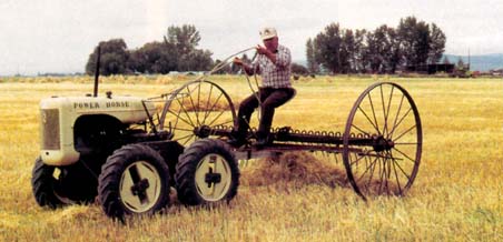

Another handy implement if you can get one for cheap is a dump rake. You pull them around the field collecting up the dribbles and bits you left behind while stacking. When the rake gets full you trip the dump leaving behind a neat pile. Then you can pick it up with the loader and add it to the stack. They generally have two steel wheels and a seat. Most were made to be pulled by a horse which explains the seat. Many have been converted to a trip rope that can be pulled to dump from the tractor. I have never seen on that was too worn out to use.
This picture is cute because the guy is pulling it with a 'remote control tractor'.!
Thinking about it with only a few acres to do you could easily do it all with a dump rake.

Those dump rakes are pretty much totally obsolete as a hay raking unit. While I agree that they will make hay windrows, albeit a slow way to make them, they are totally useless as a hay drying tool since there is no way to flip the windrows for better drying like a side delivery rake can do. Hay gets rained on and you can actually fix the damp mess and save the crop with a side delivery rake - no way of saving the crop with that thing as it is totally a 1-trick pony. Need to tedder the crop for better drying on humid days? An old side delivery can serve as an improvised tedder in a pinch and excels at flipping already existing windrows to dry the other side? Really, any of the old side delivery rakes are vast improvement over that style of dump rake in every way imaginable. A side delivery rake can simply serve more functions, while still doing the only function that the dump rake can manage much faster to boot.
Actually, that rake might be most useful as an improvised hay sweep for making large piles for shocking the hay but even that is a unlikely use that might prove more frustrating than rewarding. I think a homemade sweep on a tractor loader would be much preferable to that dump rake for gathering and piling hay.
Worse news though is those dump rakes usually sell for much more money than scrap iron price as people like them for yard art and pay ridiculous sums for them to use as decorations (at least in my area). So you pay more for one of those dump rakes over a side delivery rake and its capability is much less in regards to usefulness.
   / Making hay without a bailer #24
A dump rake isn't as bad as that. I've used one quite a bit with horses. You can flip a winrow by coming into it and dumping it again a few feet from where it was. The problem with using them with a tractor is that you need to hook up a rope to trip the dump mechanism that is a foot pedal to the left of the seat. If you use one try to always rake towards the heads of the grass as they fell from the mower as they pick up much better that way. A side delivery rake is of course much better if you can get one.

A little harsh on the dump rake rankrank. If you read my post I suggested it for cleanup and only as a sole rake if he only had a few acres. Now I was thinking like 5 or less. Maybe you were thinking a few is 50.

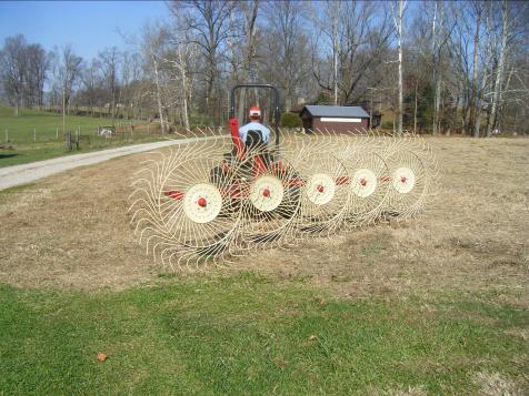

FWIW Those wheel rakes can be good or bad like you have now pictured. The old ones ain't worth spit and they do not work well. The newer ones work well and are fast. Only downside to them is that every piece of trash, stick, limb in your field ends up in your hay. More dirt ends up in your hay too as the tines rubbing on the ground powers them and that dirt has to end up somewhere. Regardless you ain't going to find a useable one of them for $100.
