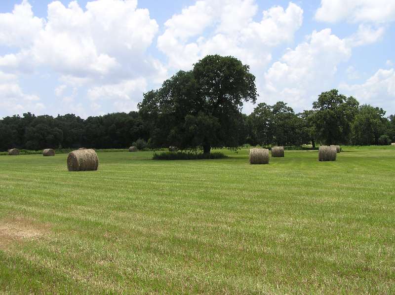

</font><font color="blue" class="small">( What kind of birds are those in pic3? )</font>
Here is a better picture of the birds.
We call them Cowbirds because they usually like being close to or sitting on top of a cow in anticipation of an insect being scared up out of the grass as the cow grazes. They may be called Cattle Egrets also.
That is also why they are here at hay making time, to eat the grasshoppers that are uncovered when the hay is racked and baled. I noticed their bills were usually open and their throats were pulsing in and out. I asked Dad if they were trying to make some sound, he said no, they are panting. /forums/images/graemlins/smile.gif It was VERY hot that day. He has also observed they prefer the green grasshoppers, Katydids, over the big yellow ones, and if one should be lucky enough to find a field mouse that they will fight over that. Guess they are a rare treat.
They weren’t always in Texas, at least in our area, but showed up 30 or so years ago. Seems like I heard they blew in with a hurricane from somewhere. Maybe someone else knows all the particulars.
