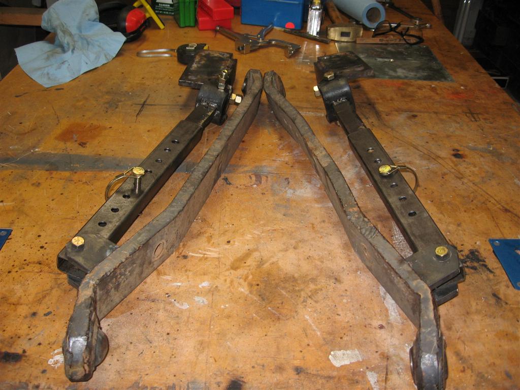

John, Rob thanks for the comments.
I sort of plan on laying out some holes after putting this on the tractor...BUT..
I'm not sure on the slot thing, just how much movement is needed? The slot on the factory ones looks like a couple inches. Seems like a lot of movement. I'm really not sure how to start noodling that part of project. Just mimic the OEM set up and let of go?
Regarding the U joints, the other night I bent some more of the 3/8 flat bar. I think I'm going to do the other side with that and see how it comes out. Generally I'm making things in pairs while I have everything out.

The slot is very helpful. not only when you use the slots on both sides to let implements "roam". But also when you pin one side tight and slot the other while picking up at odd angles, rusted pins, kicked as hard as you can and still wont line up, I use it quite a bit. Also weld a little pin holder, even though mine have chains to keep the pins close, I never leave them dangling, I always put them in a hole or in the holder, wich is just a little L bracket welded to the outside of the swaybars. As for a pin a T or an L is all you need, drop in from top no clips or retainers on the bottom and I have never had one pop out, even in rough use in the bushes.

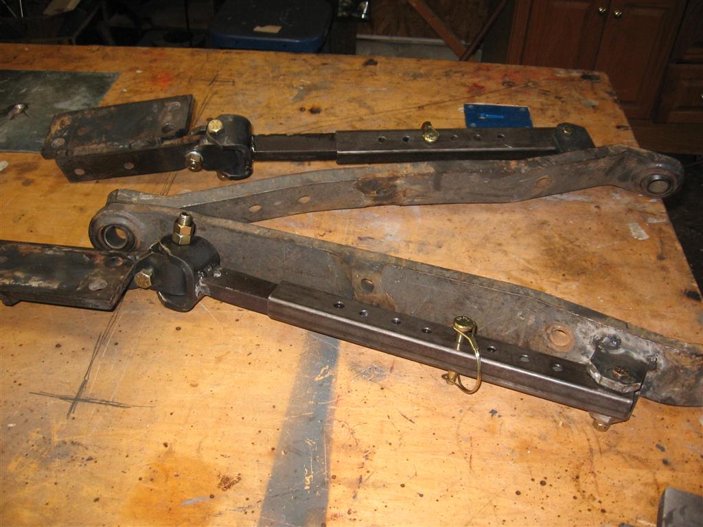

It is finished.....

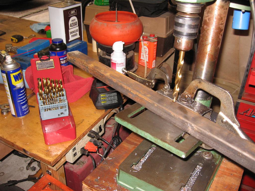

I removed the lighter 1/4" steel U joint and used the thicker 3/8" steel. So I have a spare set of those now. I was going to wait and drill the holes after the first install but had the time. Spaced the ones on the outside about 1.25", ones on the inside bar about 3/4". I'll figure out the slot later. I have a couple implements with odd widths so I may want to find some way to make all of them the same so I won't have to fuss with it all the time.
Hardest part this weekend was getting the holes to line up. I just clamped on a guide to my drill press. One hole slipped off when some shaving got behind it. All others are ok. Picked up the 3/8 pin to secure the, I drilled the hole one drill bit larger than 3/8...just in case. :D
BTW that red drill index came from HF, $9.95 for the set. It's a real good set. Been drilling all the metal from that set on this project. HEck of a deal for that price. I actually picked up 2 more sets at HF sidewalk sale this weekend.
NExt pic...on the tractor! I still have to weld everything solid. I might do that this week because all indications seems to point to it fitting ok.
Rob

It's funny, after first reading your thread a couple weeks ago, I just broke off my stabilizer bar...dang. I fixed it already, but mine are round and I really like your square ones. I was also thinking, if you have enough slop in those "U" joints, where there is some movement, maybe that could take the place of the slot? Otherwise just machine that last drilled hole on the outer tube (nearest the "U" joint) to be a 1" or so long slot. That would give you the opportunity to pin the 2 sliding pieces together using that slot when needed, or without using the slot by pinning in another set of holes.

Just a little play in the U joints, I tighten them up as much as possible. I even welded a couple beads on the tip of the ROPS bracket to tighten them up. We'll see how it works. I like the idea of locking the arms in place when nothing is attached. Mine will swing out and hit the tire.
