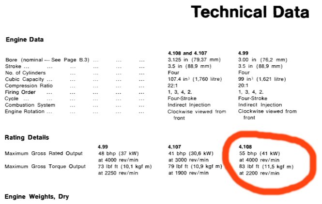

Your 55 HP rating on the Perkins 4108 might be a bit optimistic.
I bought an older Bobcat skidsteer that had that engine in it. The head was cracked and I had a tough time even locating one. They were use in the US in Gehl skidsteer, some Bobcat skidsteers, but mostly used in sail boats. Around here finding a sail boat large enough to need an engine .....isn't. Good that you found the parts you needed. Trying to import the engine is now impossible because it does not meet EPA requirements.
Anyways, all the info I found indicated the HP in the 38HP range, obviously determined by RPM. Their history says they usually last a long time, and known as oil leakers. Those reefer engines are a breed of their own! Take good care of it, and have fun with your project.

Maybe...the manual says 55 Brake Horse Power but I have not done the bore and stroke calculations to see what it is. It does kind of suck that this is a high speed engine instead of slow speed (4000 rpm at full power instead of 1800 rpm), but it is what it is, and I got what I got. Not really ideal for a Genset, except that it is designed to go to 30,000 hours.
