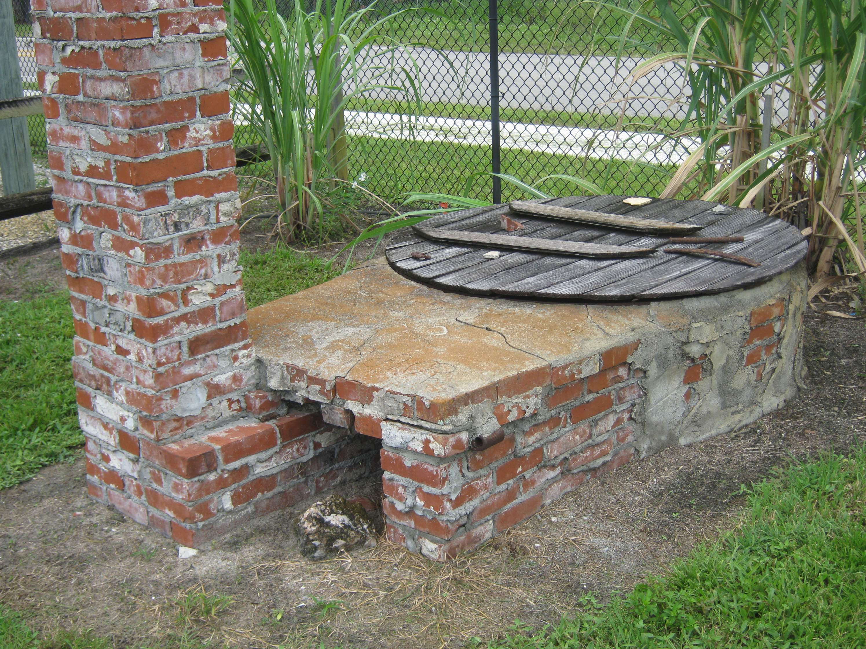

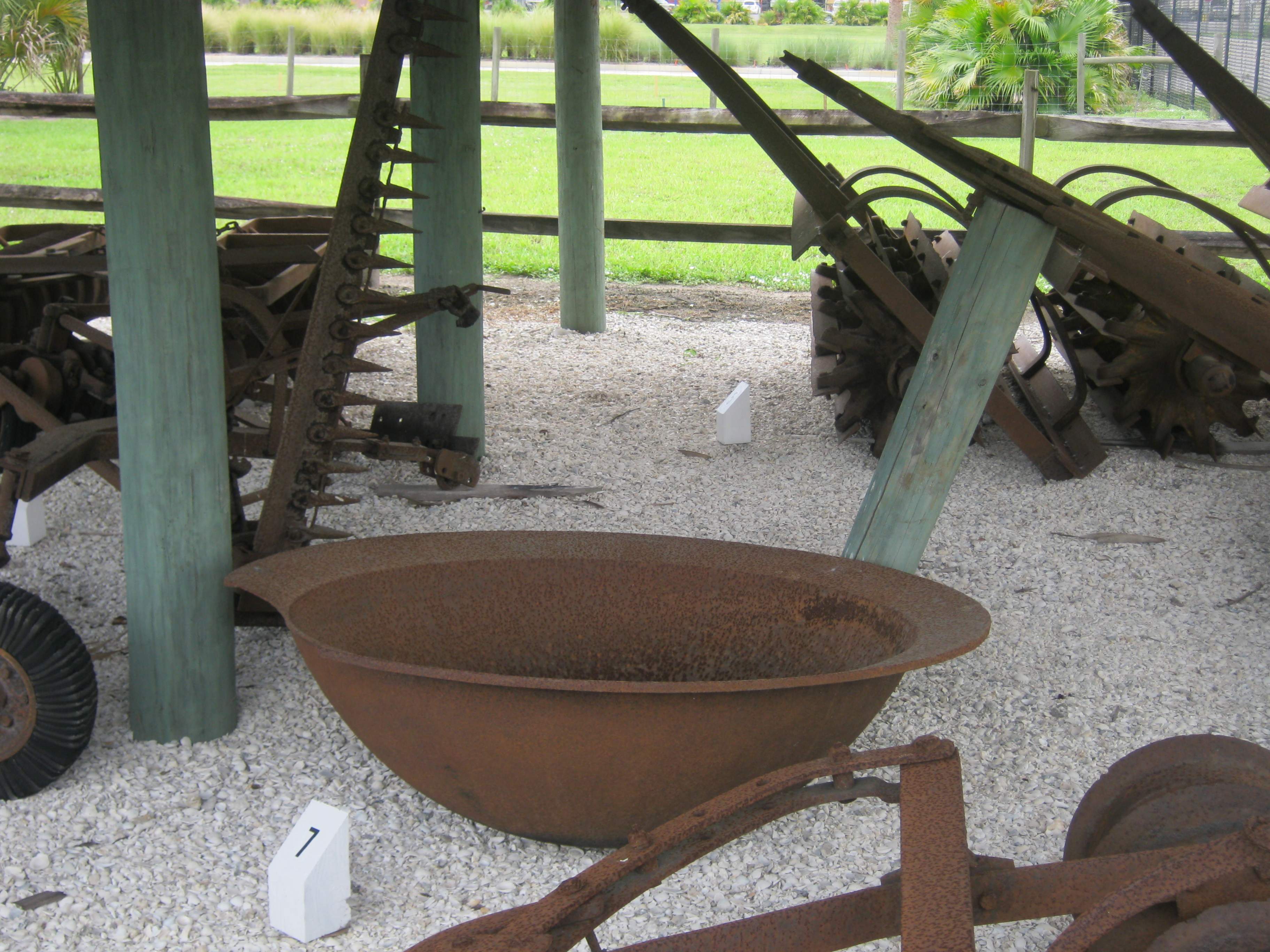

There are two types of cooking methods that I am aware of. One is a kettle and the other is a big rectangular pan with divisions that make the juice zig-zag down the pan to the final section where it is tapped into a cooling barrel and then bottled. My uncle designed his own pan and had it built. There are several internet sources for the kettle type and dimensions.
Cane syrup is different from maple syrup in that the ratio of juice to syrup is a lot less for cane juice. Off the top of my head, I'd say the ratio is no more than 5:1 for cane syrup and probably closer to 3:1 depending on how much water is in the harvested cane. Cane juice boils for 3 hours to finished syrup. I believe most kettles are 100 gallon and make 30 gallons of syrup.

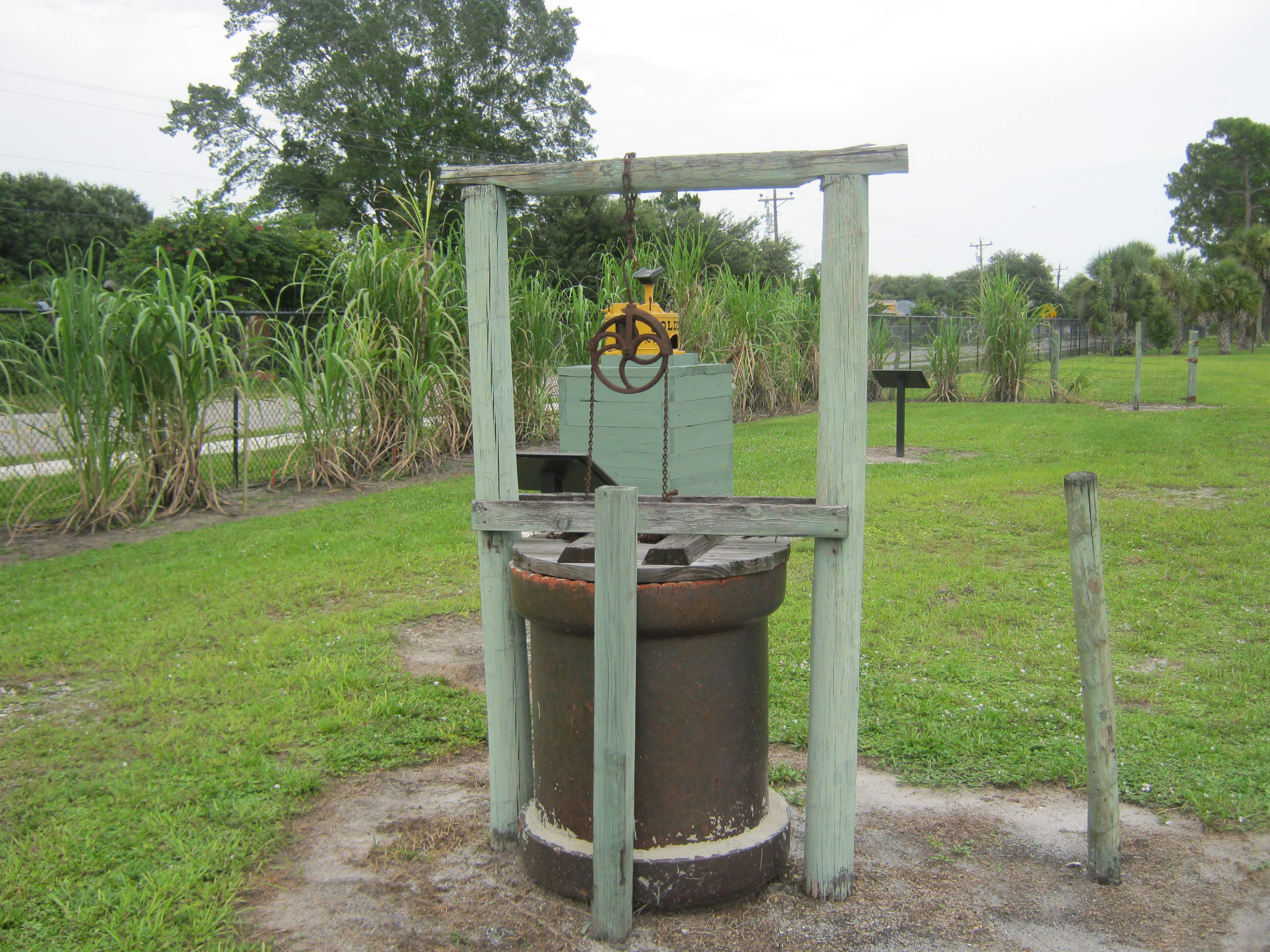

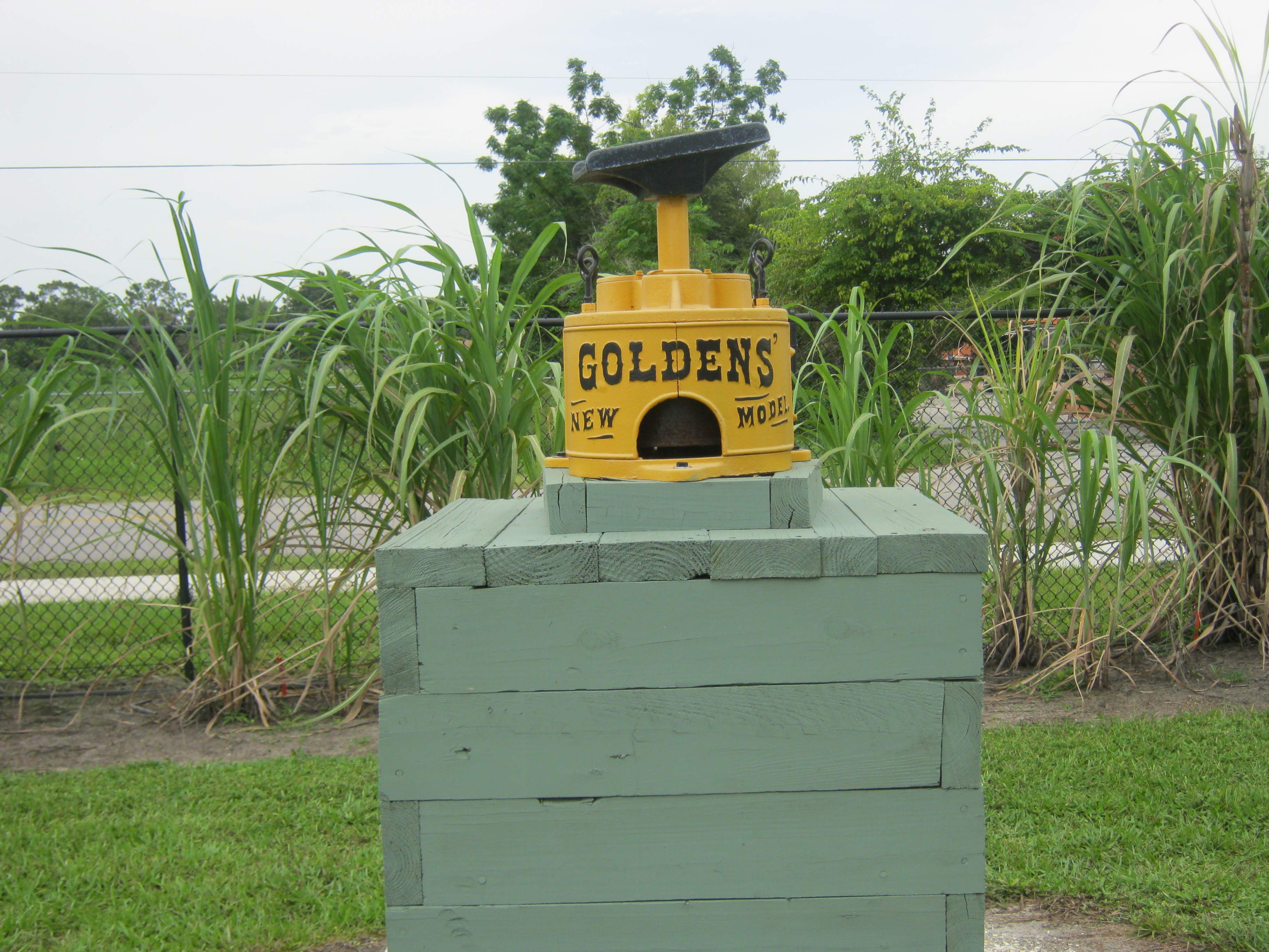

I've posted these pic's before from pioneer museum maybe 20 miles + north of me.
