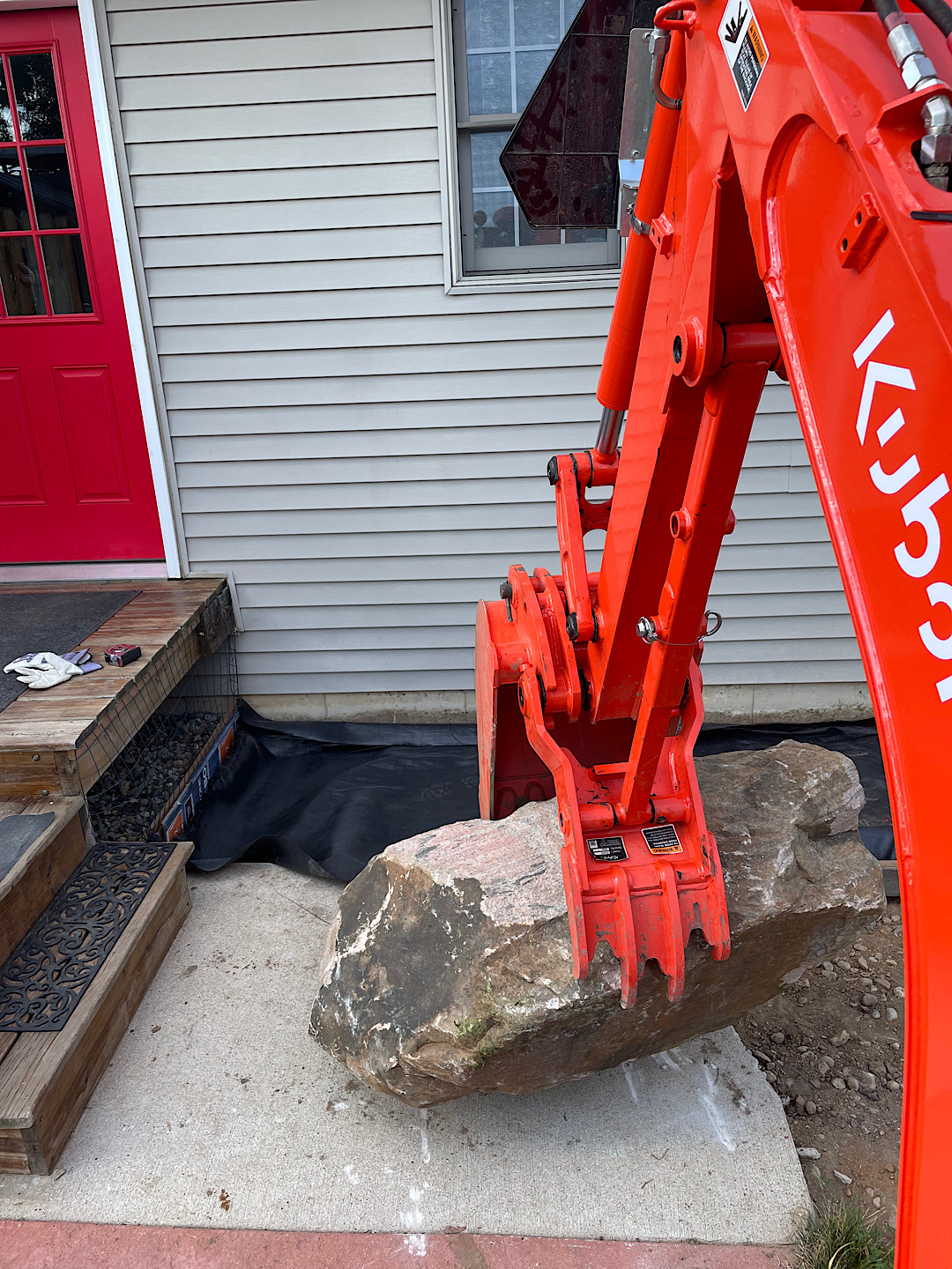

Welcome to the MX club. I just hit 100 hours on my 5400; what a great machine. I went with gear drive on mine. What dealer did you go with?

This one came from Beverage Tractor.

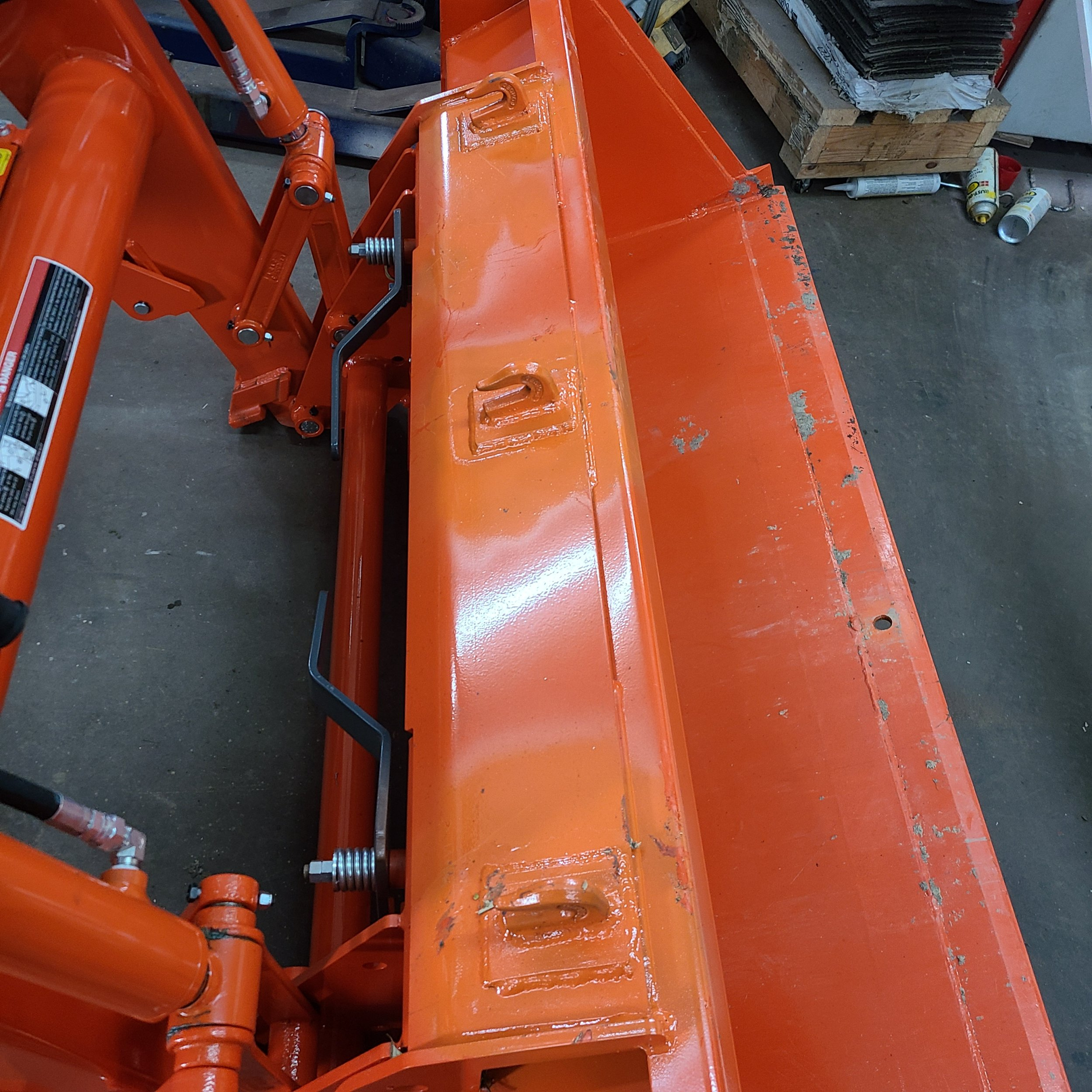

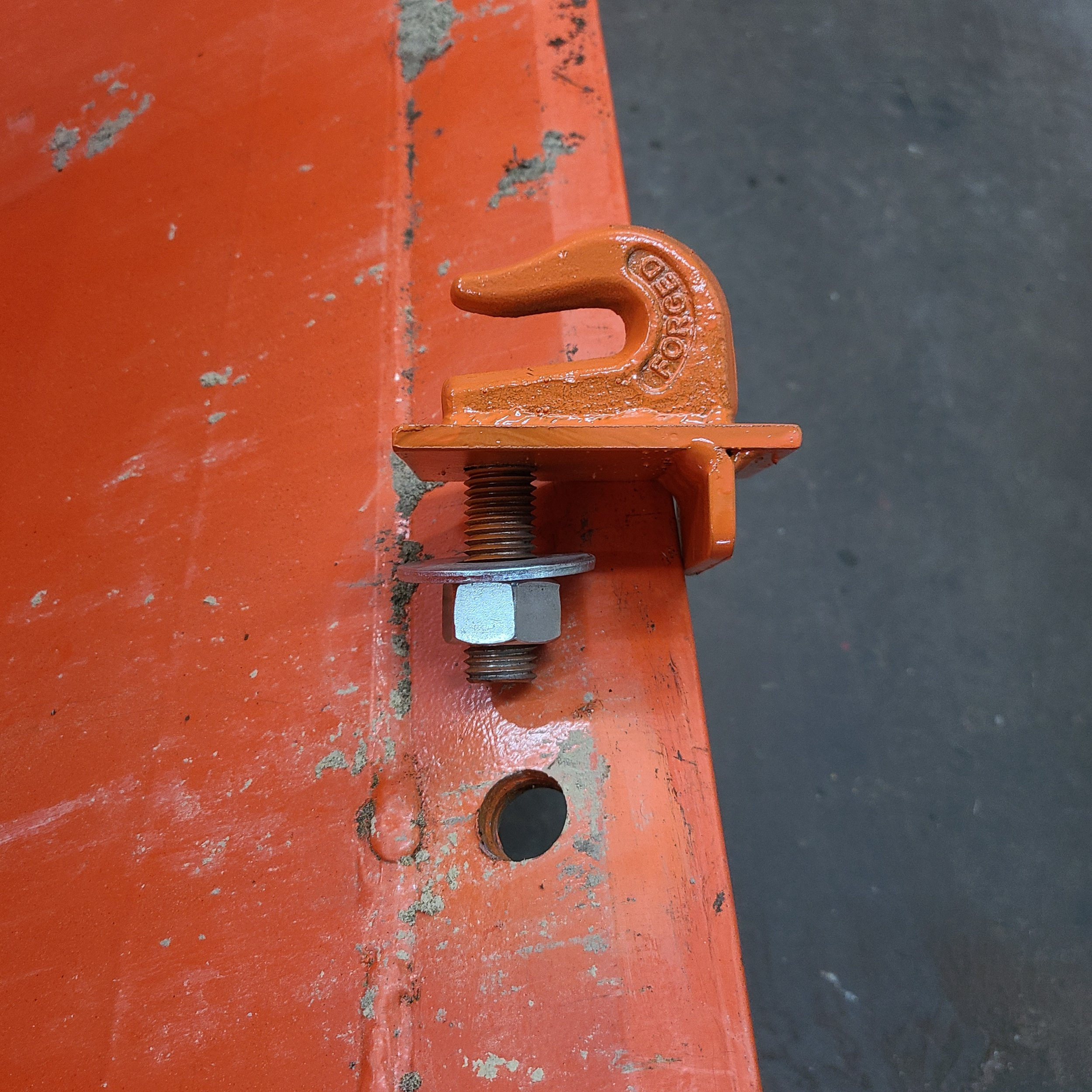

Made the first mods to the new machine today. I welded on some chain hooks on top of the bucket. I also drilled a hole in the leading edge. I did this on my old machine so I could stick a hitch ball in there. It is really hand for moving trailers around on the property. While I was at it I went ahead and fabbed a chain hook that would mount there as well if I wanted to lift from bottom edge of bucket instead of top. I also found out there apparently is a big shortage of equipment matched paint right now. No Kubota orange to be found around here at least. So for now I painted with Rustoleum orange. It is a lighter orange but will do to prevent rust until I get some to match. Pics attached.

Nice, 3 hooks are the way to go and the hole for a hitch ball is good idea.
