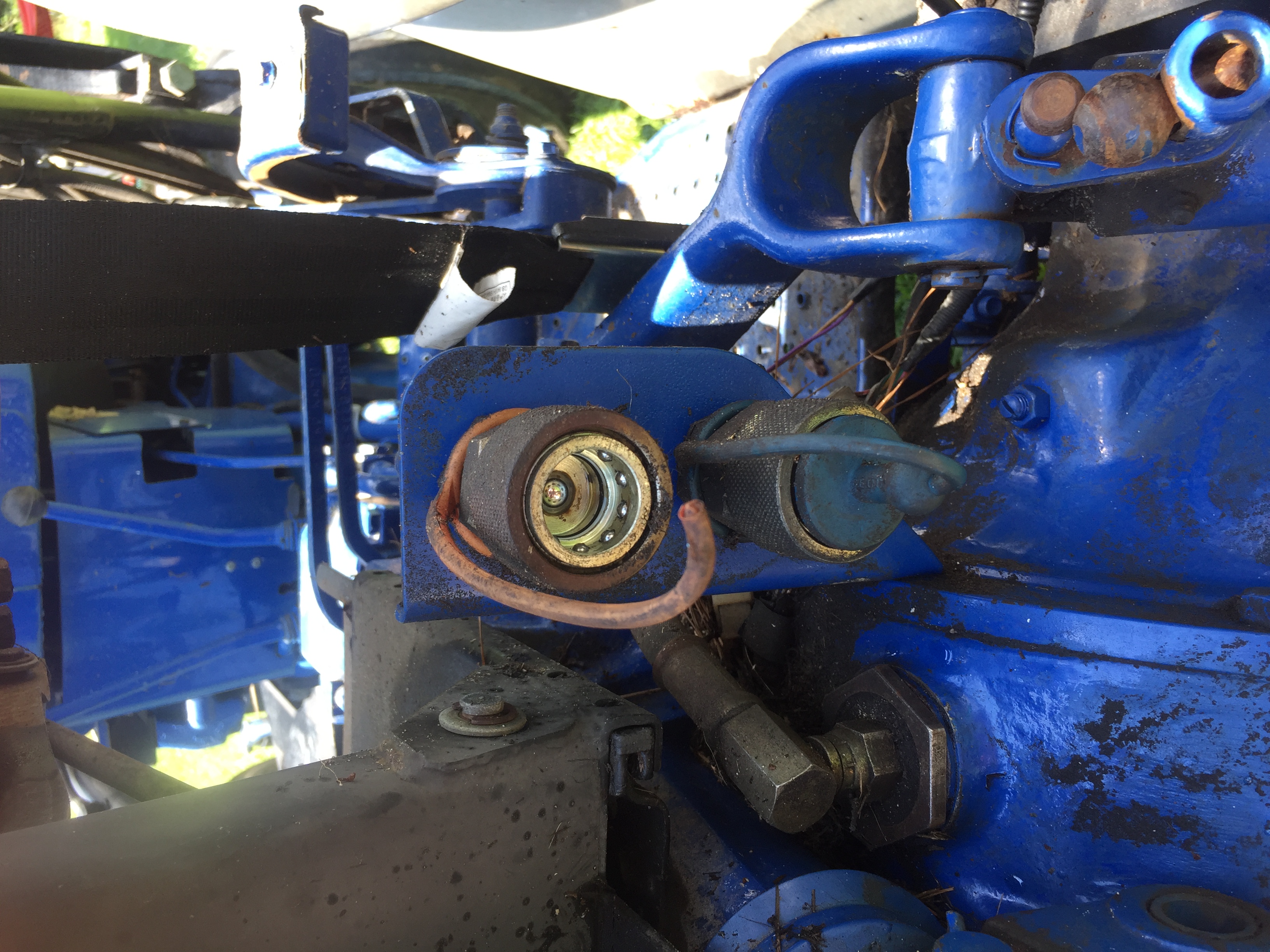

What size/type of male fitting do I need for a Farmtrac 60 hydraulic remote?
I just purchased a Norwood Skid Winch which uses a capstan powered by a hydraulic motor. The hoses are 1/2 inch and the remote opening on a Farmtrac 60 inside diameter is .93" which converts to 23.6 mm. Attached is a photo of the remote opening.
What size type male quick release fitting are other farmtrac owners using?

Well I still don't know exactly but I now have my remotes hooked up and my little Norwood Skid Winch works great. I took off one of the female quick link couplers and then went to the hydraulic shop that rebuilt my power steering ram. The owner searched through his bins of male connectors until he found one that fit. Boom. Works great.
