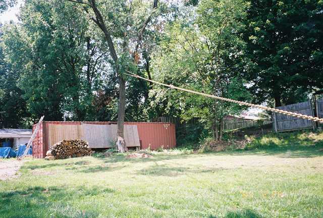

Post #1 of 7) I do (I think) understand your point. And I'm not suggesting you're wrong. And this forum IS about safety. But my options in getting this down were to climb the thing, attach pulley to higher limbs and cut the larger laterals and lower to ground (or on top of container next to it). I could have used a hydraulic ram against the tree pushing against the container.
Anyway, I digitized the photos of taking it down and am posting for comment. This pic shows prior to any cutting. If you look at lower part you will see a stump which is 1/2 of tree that already has ceen cut. It was leaning in the right direction - it's always easy enough to cut something leaning the was you want it to fall! However, this part was leaning slight the wrong direction.

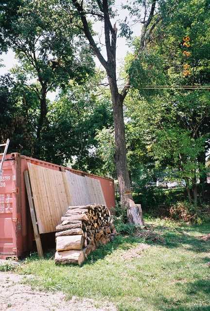

Post #2 of 7) This one shows view toward the tractor with chain & rope back towards the tree

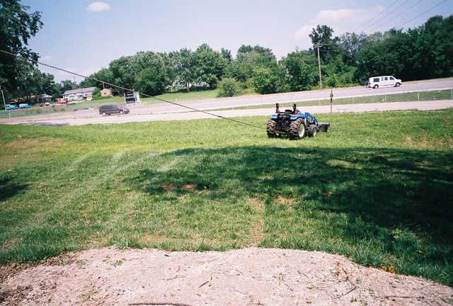

Post #3 of 7) This shows view from tractor back towards the tree. Small felling cut was made and small relieving cut. Then force applied. Then additional small cuts made. It went of (cracking the hinge/picot) from force applied by tractor after the third cut. I understand this could be dangerous if I had cut too far and it started falling the wrong way on its own.

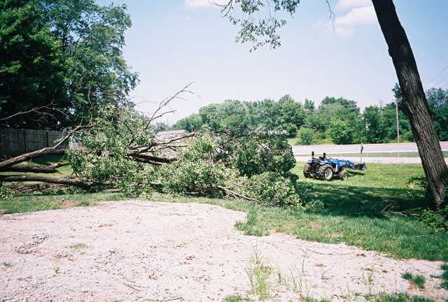

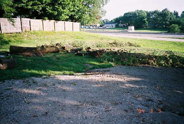

Post #4 of 7) Whew. Tree down. This view shows the upper part of the tree. The chain and rope totaled 90' and the top of the tree was about 15'-20' from back of tractor, so tree was 70'-75' in height which was close to what I had estimated. You can get a sense of the size from the scale of the tractor to the tree (tractor is a NH TC40)
