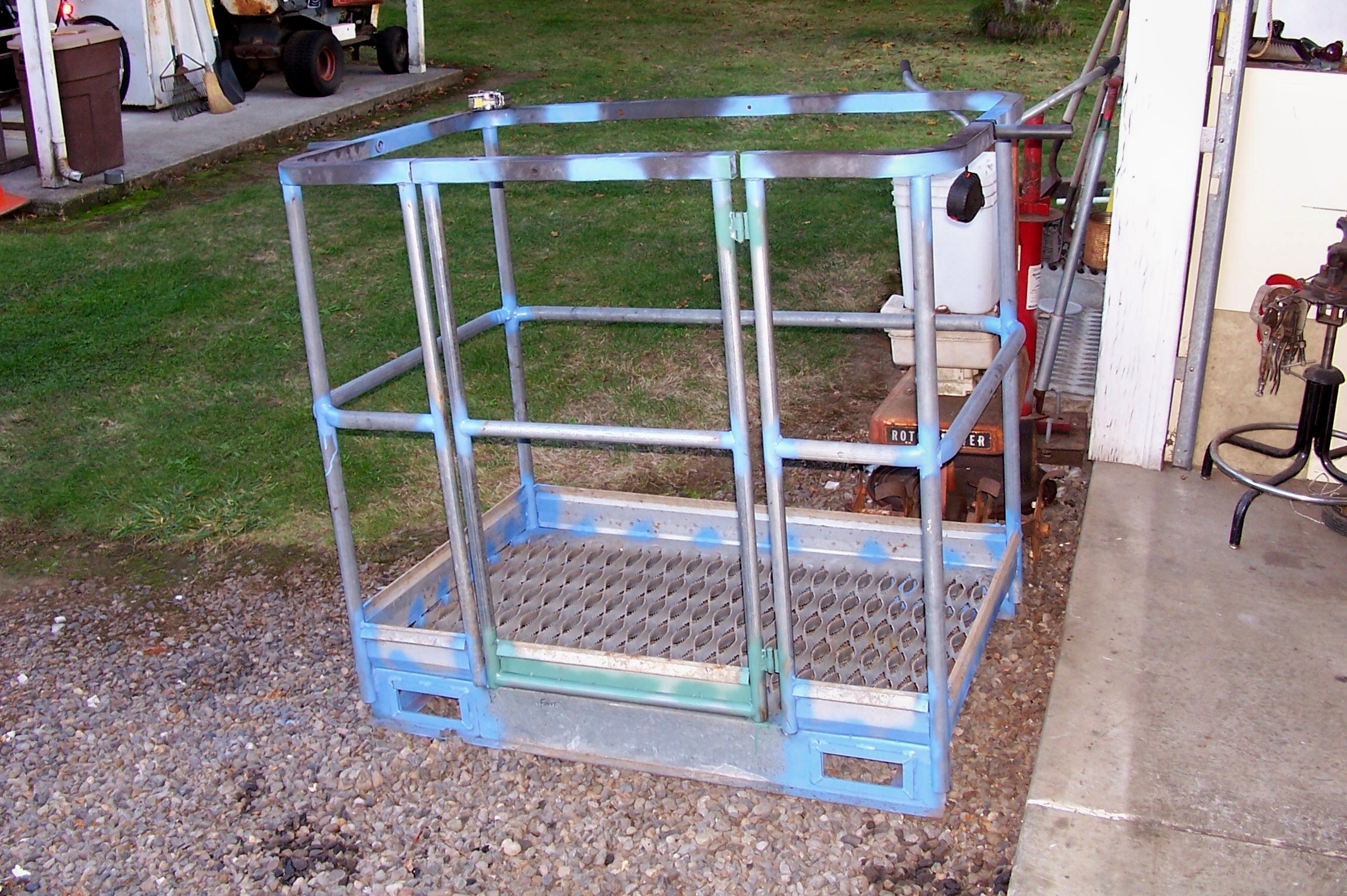

I built a basket a while back out of salvaged material I had laying around. The 4' chunk of catwalk was ideal for the base, the square top was from an old home gym that was by the road with a free sign on it, the 1.375 toprail was from a neighbor's fence I helped take down, the hinges are cut down house door hinges. Boxed the fork pockets with some old flat bar and tied the bottom together with a couple angle irons from a bed frame. Oh, and the toe rail is about 4" trim off some galvanized roofing that I kept; it's surprisingly rigid when tacked in. Painted the welds with some nearly empty rattle cans so it won't rust too bad. I have holes in the fork tips for a trailer ball and a hook, so those will prevent it coming off while in use.

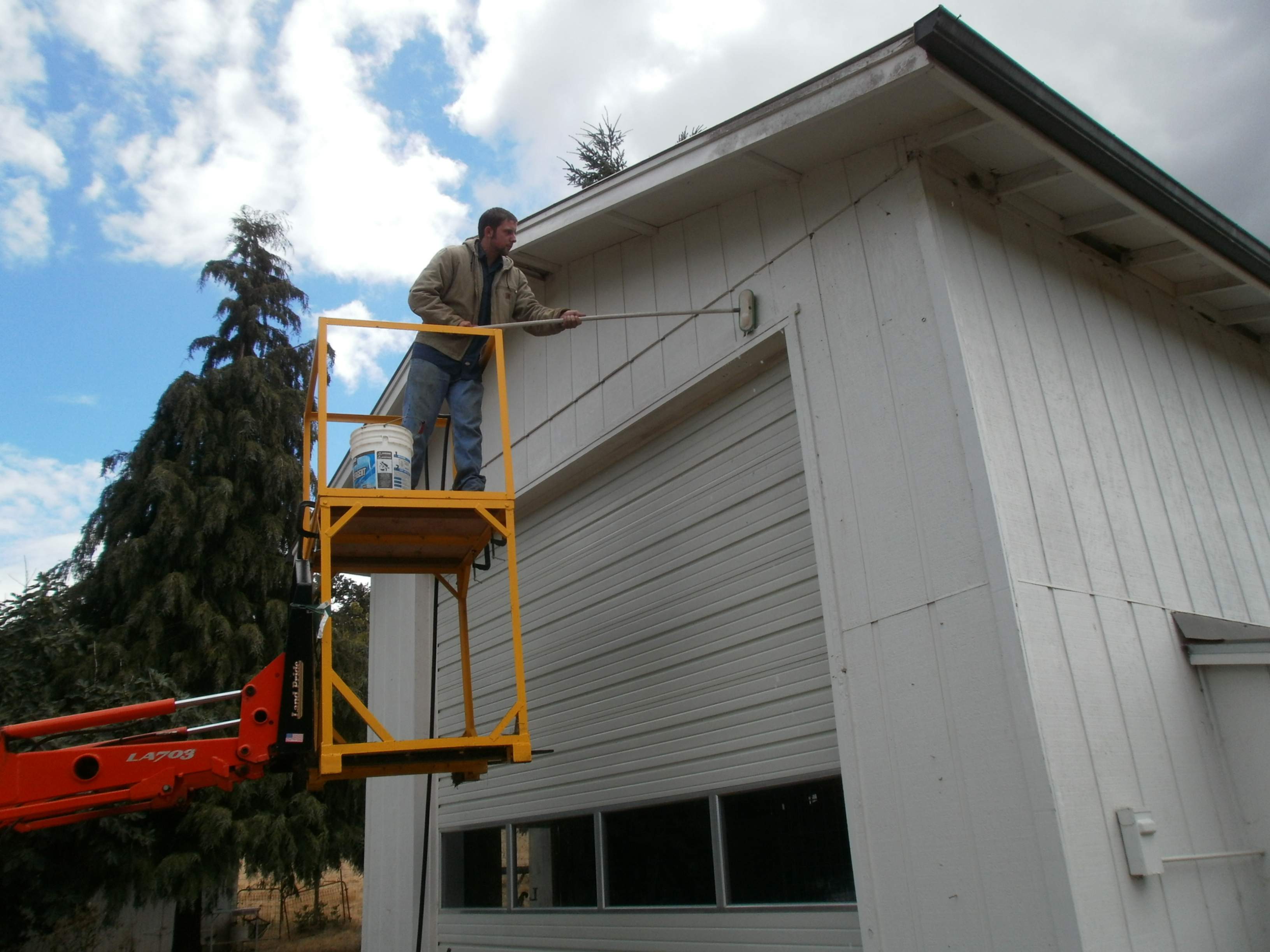

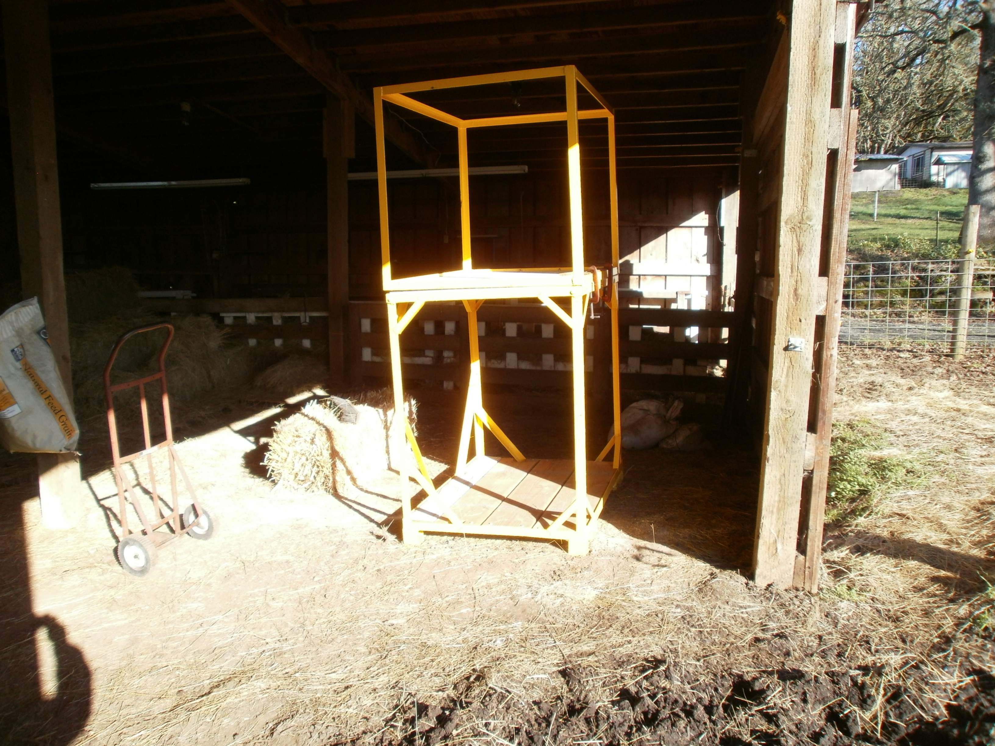

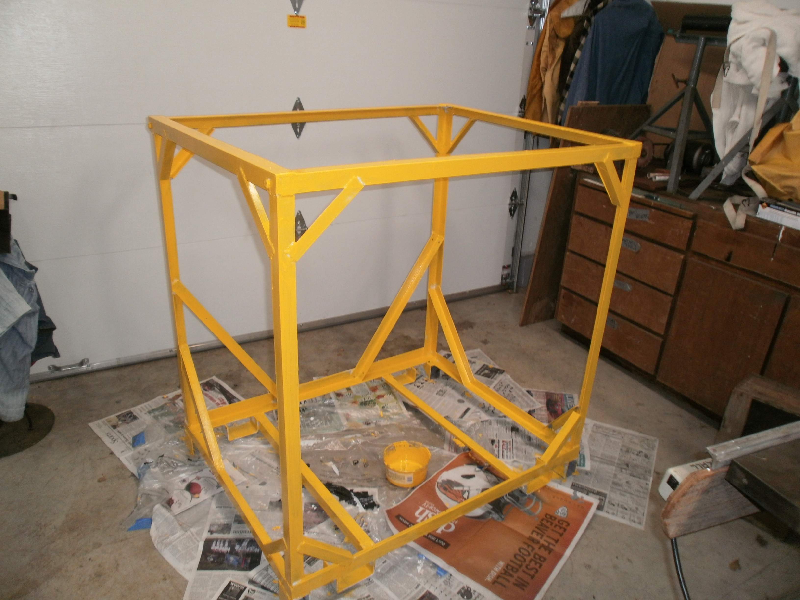

I had to offer mine... it is a double decker, I have it so I can reach a bit higher or lower which ever I need. Second level is held tightly with four c clamps. I hold the hold thing against my ssqa land pride assembly with ratchet web straps. The bottom began as being part of the frame of Woodmaxx chipper pallet. I added the rectangular tubing for the forks for a better and safer fit. It really works just great for us

Man baskets are only as safe as the guys wife who's running the FEL controls lol.
Good luck! Fred
   / Man Lift revisited
#15
That's a fact, jack
So Fred, I'm dead.
Safety harness on the way.
I wonder if she will get in it?
   / Man Lift revisited #16
My wonderful wife hates to run the tractor but when shoveling off the roof in the dead of Winter I make her cart my lazy butt around the buildings in my man-made thingee while I pull the snow off with a rake. She learned fast that small inputs to the FEL controls mean a working husband after dinner! Happy wife happy life.
