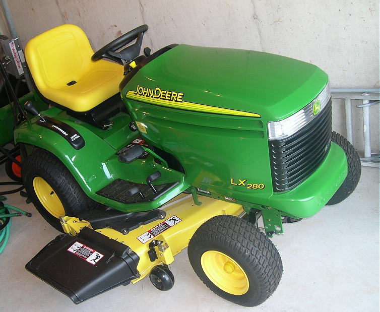

that's a really nice garden tractor and doing a thorough maintenance on it to set up a baseline for the future is really helpful, particularly on equipment with hour meters.
We have almost identical experiences, but my JD LX280 had only .6 hours when I got it, eight years after it left the dealer, for the exact same reason you mention, except my friend never turned the thing on after he put it into his garage. I went through all this process, plus engine fogging and yes changed everything, but waited on the hydro fluid until now, 50 hours later in my case.
In a garage without windows, the tires on my tractor were perfect, which amazed me. The picture below is as I found it, after the tarp had been removed. I expect some tire cracking soon, but I doused them in Napa Protectant, which I recommend highly for rubber, plastic and metal parts on
garden and farm machinery. So other than changing fluids in your unit, and maybe going over the plastic parts with some preservative, your unit should operate like new. I'm assuming you have thoroughly lubed it, grease, oil, Kroil, WD40, whatever your pleasure is on the moving parts. Keep it well lubed and it will run quieter and longer for you.
Nice machine. Love mine, best mowing machine I have, and it's just one of many in the barn.
