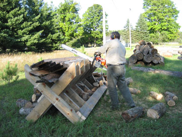

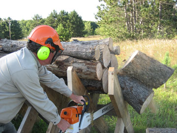

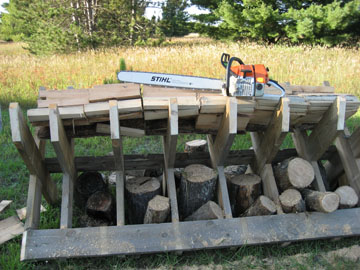

Also known as sawbucks. I finally made myself a set and they work really well for cutting up firewood logs and slabwood.

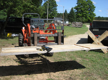

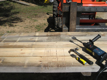

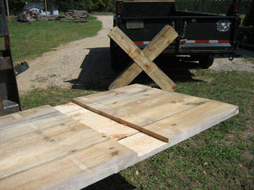

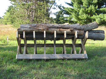

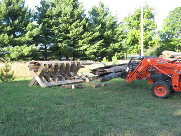

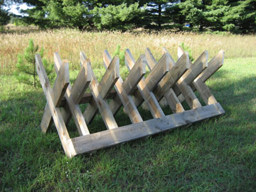

I used rough-sawn 2x8's with half-lap joints. The half-lap keeps the spacing (16" O.C.) the same on both sides of the sawbucks. The first pair (on left) are spaced at 8" o.c. The forks on the Kubota make a good workbench / sawhorses, as well as helping to load the sawbucks with wood.

Why did you 16 o.c. instead of 24 with 2x8's.

Xmoto - I used 16" centers because that's how long I want to cut my firewood. I can eyeball the sawbar halfway between two bucks pretty well and end up with 16" firewood (usually within + or - 1"). I used 2x8's because that's what I had handy, and I wanted to be able to drop the logs from the loader and thought the extra strength would hold up well.

Any design changes you would do. Just wonding before I make one.

Thank you to all for the positive comments and contributions.
Studor - Thanks for the link, that's a pretty slick in-woods system. I can't wait to try that one this fall.
Xmoto - I don't think I would change much, it works better than I had hoped for. BTW, I used 5' boards for the crosses (I cut 10'x2"x8"s in half). I plan on coating the "feet" with some West or System 3 epoxy to prevent the wood on the bottom from rotting due to ground contact - I'll let the top weather to gray.
I did think about making the top horizontal brace from hardwood and screwing it in. This would hold up better to the occasional cut and could be replaced if it got too chewed up. As it is, I just try to be careful and not drop the bar as I finish cutting at the bottom.
