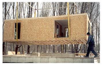

First of six modules ready to be placed on the foundation.

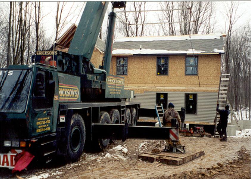

Here is a shot of the 150 ton crane that did most of the work that day. It didn't even break a sweat...

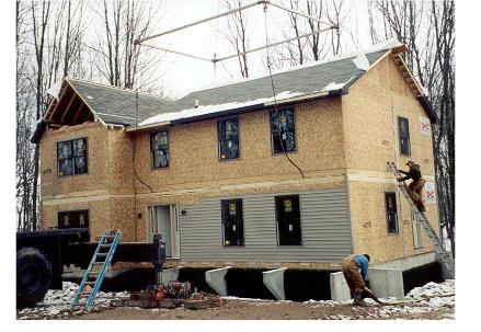

The sixth module has just been set...

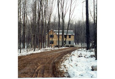

This is what it looked like less than eight hours later that same day. Pretty incredible what they can do these days.
This is my major project this year, I'll update with some more recent shots showing the progress to date. These particular shots were done almost a month ago.
Since then, a garage and covered front porch have been added along with more siding and shudders etc.
The house is through GHC (General Housing Corporation) out of Bay City. http://www.genhouse.com
They only work through licensed builders. I'm using Stanhope Homes out of Twin Lake, MI for this project.
It is their Plymouth plan reversed. It is 2632 finished sq. ft. sitting on top of a 1316 basement with walk-out. Four bedrooms in the upper story two and 1/2 baths throughout. I had the basement plumbed for another future full bath.

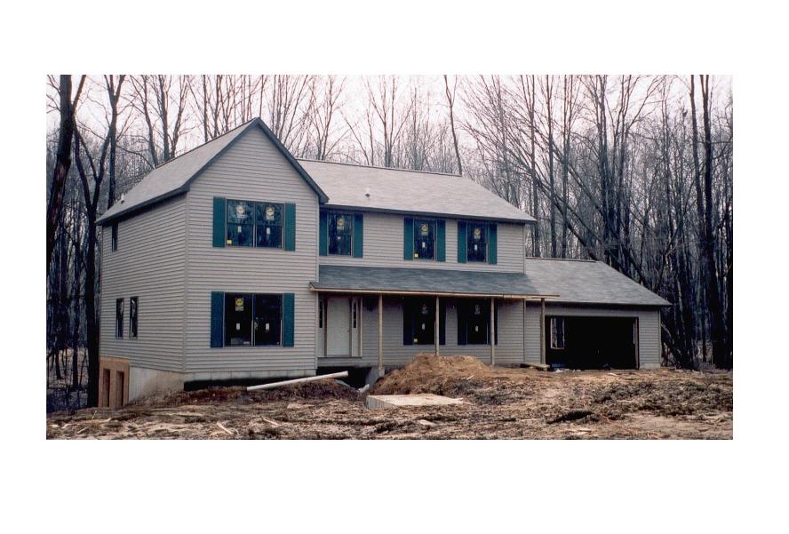

Progress report as of a week ago. As you can see the porch is on as well as the garage. Starting to look like a house.
