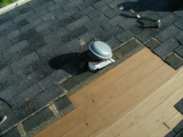

Kennedy.. I have been in construction all my life and I can tell you shingle install with staples would not pass building code in our area there simply not intended for that type of use... But maybe your water problem does not have to do with your shingles...I notice in one of your pics you get snow in your area (cold weather) your problem may be with the ventilating fan that's in the bathroom, go in the attic and check if your flexible venting pipe is insulated (this is similar to the one use in back of a clothes dryer) if it's not it will be fill with water, this occur with the bathroom condensation when taking a bath or shower.. I may be wrong but I seen this happen many times...cag
   / Manufatured housing roofing #13
I should have mention when the ventilating pipe is not insulated condensation builds up, water fills the pipe, freeze, and breaks the pipes then leaks true the ceiling, so I would also inspect closely the ventilating pipes for cracks if no water is present...cag

Update: Contractor was out on behalf of the mfr. These guys went right to town pulling off the shingles in the affected area and NAILED down a bundle of new ones. They were very sure of themselves and what they were doing and did an excellent job. They also did a better job of tar sealing the short flashing of the vent and ran the shingles down closer to the vent. I believe the mfr had a BIG cutout if memory serves. These guys ran the shingles right close to the stack and notched around it. In the attached pic you can see the tar line which is where the shingle was cut back square way above the stack where it would have lapped to the center of the stack or so. Possibly even had a tab removed.
Exposed staples were documented again, and we'll see where it goes from there...
