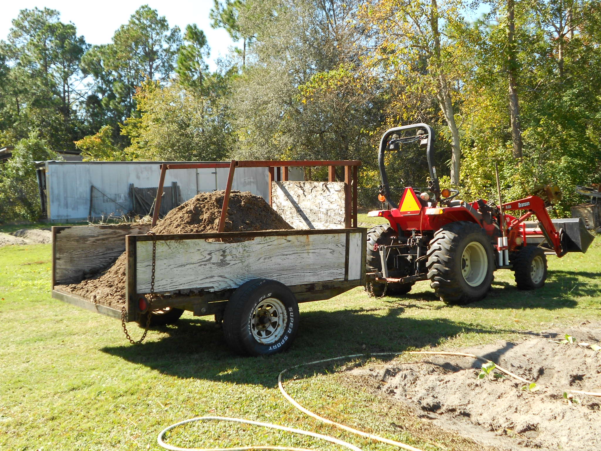

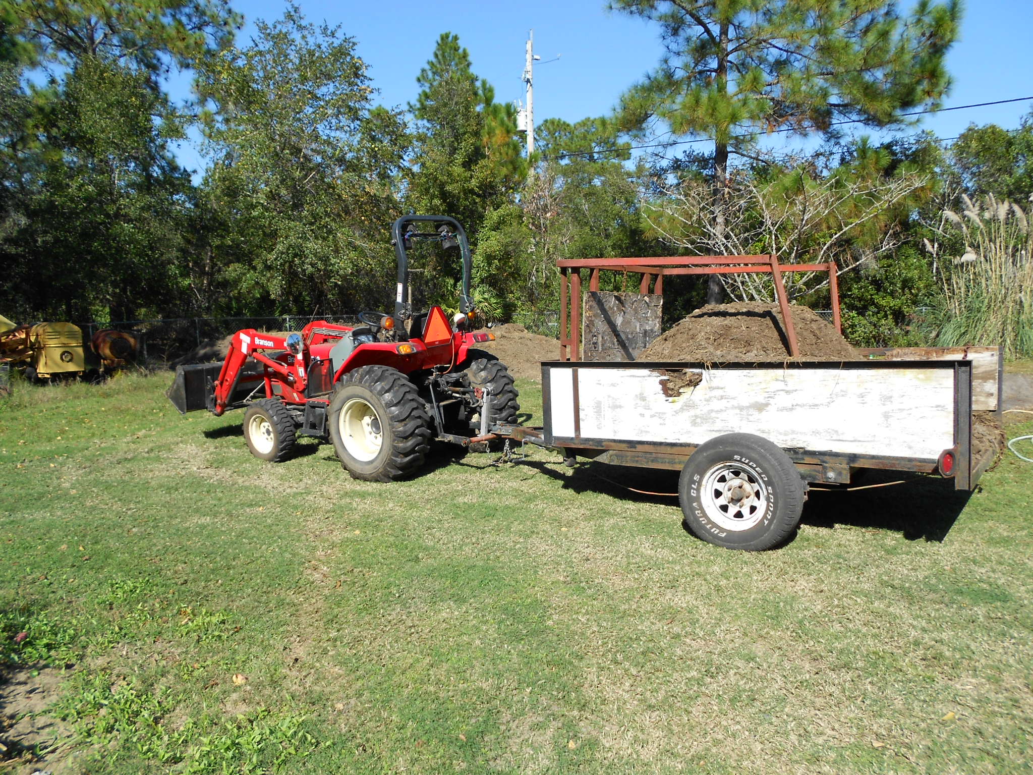

The pics are how I haul the squeeze from the stables down the road. The trailer won't dump very well so I put the frame in the bed. I have the chain attached to the frame and I hook the chain to a tree and drag the whole load out easily!
You can see the pile in the background, I keep it turned over.
