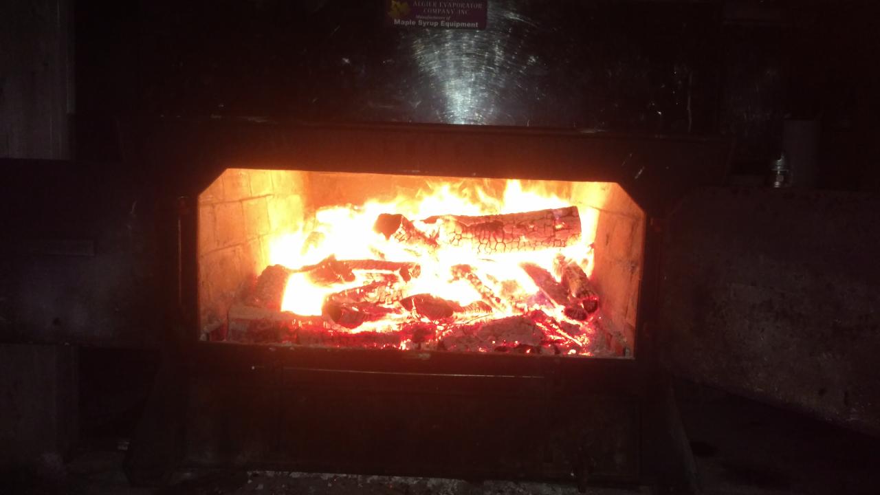

I tend to agree, though them be fighting words on the syrup forum. I will say that I don't think which type of wood makes any difference. Personally I prefer softwood. It doesn't fill the firebox with coals and it burns hot and fast, which is what I want. Also, it's a good way to use that kind of wood. I like oak, all, maple, hickory, etc in my woodstove, but I gotta use up the poplar, basswood, pine, box elder, etc somewhere. Might as well put it to use. Here's my cooker, by the way. It'll burn a full cord of soft wood in 3 hours :).

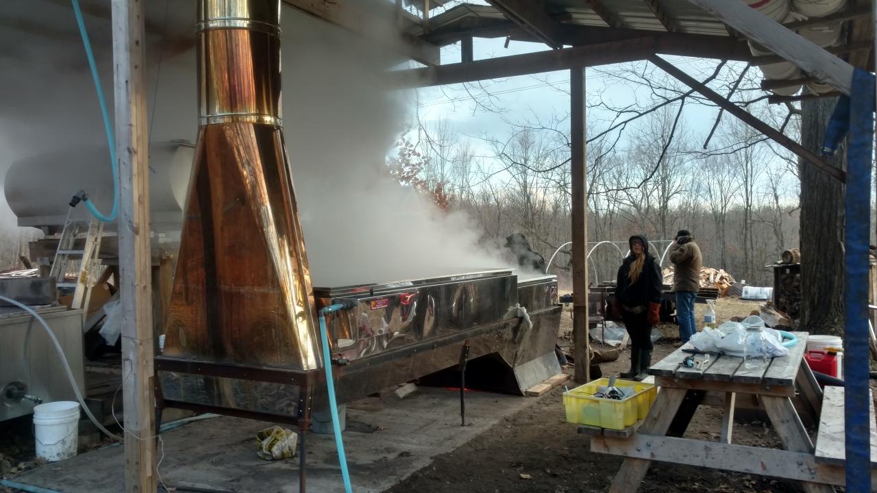

It ran pretty good here today. Not a huge run, but at least a gallon per tap. It started earlier in the day than it has been, so that helps a lot. Got my cooker fired up for the first time. Boiled about 800 gallons of sap in 4.5 hours. Used about 50% of a cord of wood. Drew off about 9 gallons of syrup towards the end of the day. The ratio of sap to syrup was much better than that, but the rest of the sugar is sitting in the pans now. I tested the sugar content at 2.5%, which isn't bad. rps20180317_224754_944.jpg

It has been a while. We stopped about twenty years ago. My earliest efforts were a 275 gallon oil tank cut about 1/3 off the top. I'd use an angle iron frame with a couple cross bars. I built a brake to bend pans. Mine were galvanized steel, it solders well to seal corners.
As we got more into it I built a 24 x 40 sugar house, and bought a 2 x 6 Lightning evaporator with 4' raised flue pan. That was a nice rig! We had 250 taps, but our sugar content was low. Made very high grade syrup mostly. Typical spring, we made 50 gallons.
