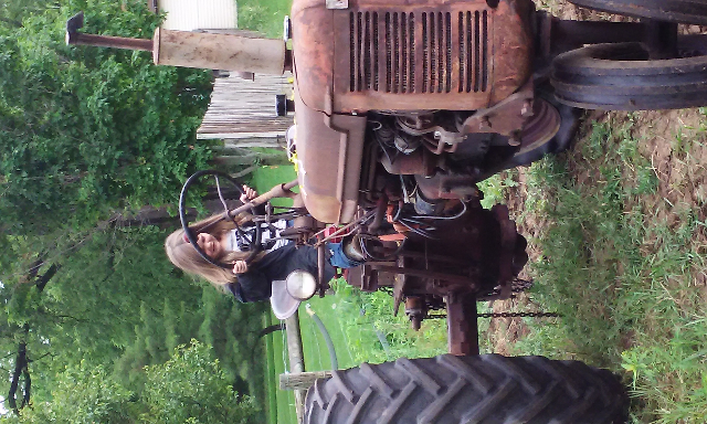

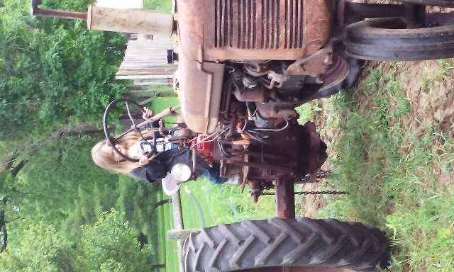

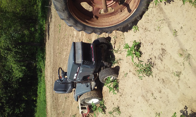

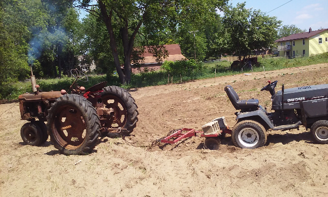

You will be perfectly fine how many acres you planting? Here is what i have and use garden tractors and a farmall C
That's my little sister pretending she's driving the tractor. I can get a pic of my garden in the morning in wanted
