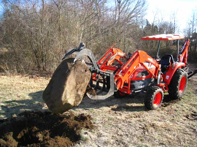

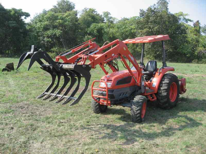

I finally got my hydraulic lines routed and the grapple hooked up to the new tractor. It's way to muddy out yet to try it out but it does look mean enough to scare the brush piles away. :)
Nice machine! Have fun!

that is a really impressive set-up. I have been thinking about adding a grapple to my Kubota M6800 with a LA1002 Kubota loader. The loader does not have a skid steer type quick connect. How does the grapple attach and what other controls, valves,etc. would I need or does Markham include all of that? If you don't mind, what should I expect to pay? I think the grapple is $1600 alone from Markham. What else would I need? I don't know anything about tractor hydraulics or quick connects (obviously!) Thanks!!!
You could get by with the lighter duty 48 or 60 inch Markham that cost significantly less. I use a 48 inch grapple (Millonzi...similar construction to the Markham) on my Kioti DK40se with a 2700lb lift capacity at pivot pins which is pretty close to the LA1002 in terms of power. My 280lb grapple has taken all sorts of abuse and works fine. The Markham 48 is a slightly heavier build and would I am quite sure meet your needs. Don't make the mistake of thinking that you need a grapple as wide as your primary bucket.
With a M class Kubota you must already have some rear remotes. You could control the grapple then simply by running a couple of long hydraulic hoses with appropriate fittings from the rear of the tractor to the grapple. Cost from an internet hydraulic discounter would be about $100, from a dealer maybe $200. Lots of people (including myself) have done this and are perfectly content. If you decide later to upgrade to a diverter valve or electric over hydraulic valve you can recycle the hose and fittings so there is almost no disadvantage to trying the rear remote first. The only practical thing you need is a rear remote controler that is conveniently located for you to reach with your right hand.

The loader does not have a skid steer type quick connect. Thanks!!!
Markham has just started (in the last 9 months) making two light duty grapples. But I haven't heard if they offer Kubota style hook ups. I know they have SSQA and I believe John Deere. Give them a call and see. I know I ended up switching my Koyker loader over to SSQA. Then I had to mod the bucket too.

Markham only offers the SSQA, JDQA, or a plain-backed version that can be adapted buy the purchaser.

I assumed I should get a 72" grapple, so what size do you think would be ideal? Would a narrower one be advantageous? Again, I've never even seen one used but after spending the summer picking up brush I chain-sawed from roads and shooting lanes, I can see that a grapple would really be great to have. I don't move much dirt, so it seems a grapple would be more useful than a bucket. Thanks for all of the replies and great info.

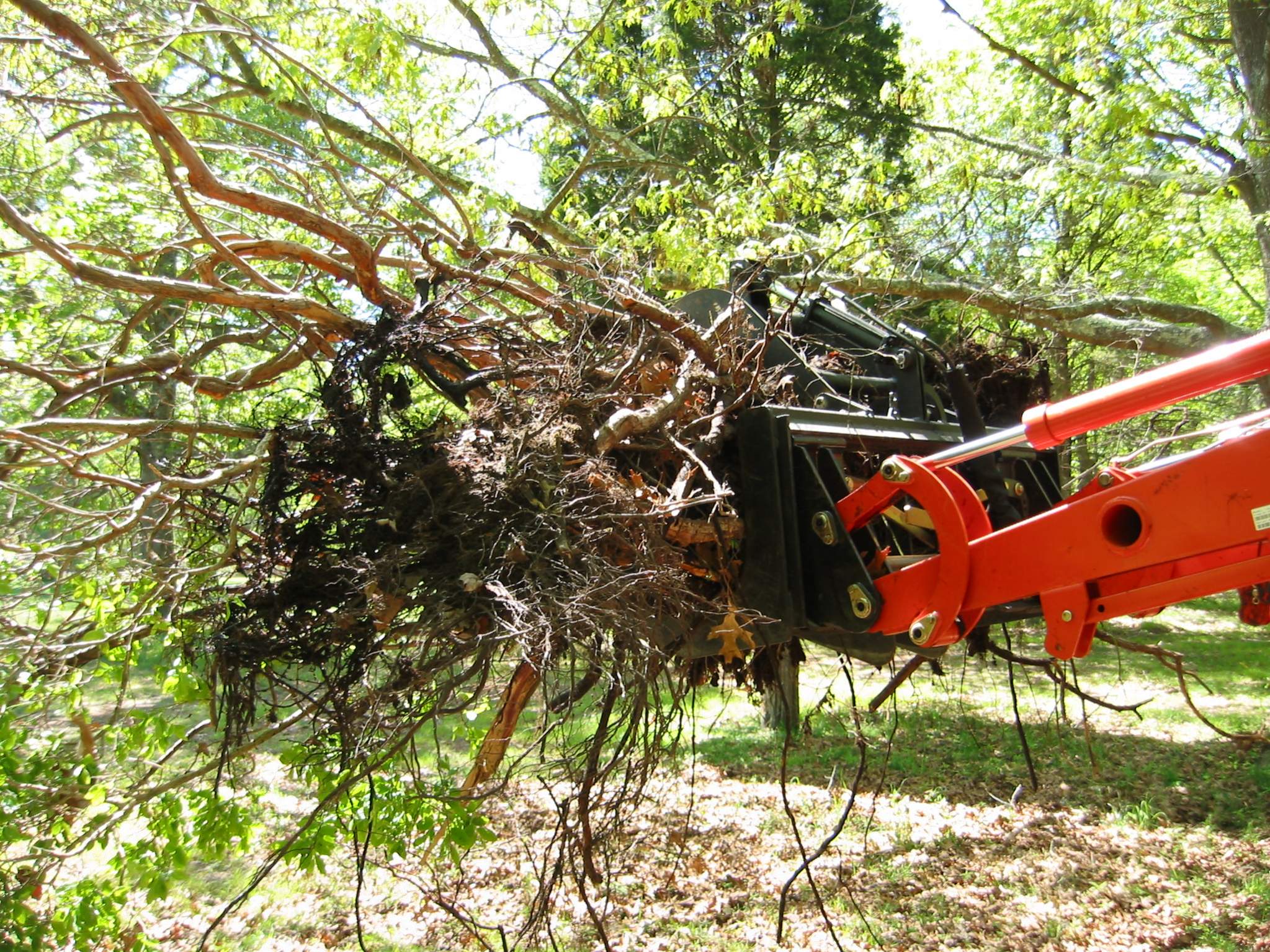

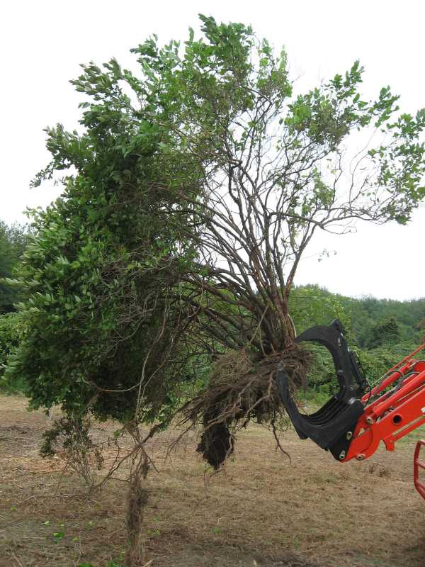

I have used a 48 inch grapple and done tons of the same sort of work you are describing. The advantages of a narrower grapple are that you have a lighter grapple which means more load capacity, you have a more manuverable grapple to get in between trees etc, you can focus your grapple ripping and pushing power in a smaller area so you can easily grab single bushes or trees or rocks and focus all your loaders strength on that small area, it takes up less storage space and lastly is much less expensive to purchase and ship. The main advantage of a wider grapple would be that if you were literally picking up sticks from the ground you could scrape up more in a single scoop. For cleaning up construction debris a wider grapple would also be helpful for the same reasons.
I don't know how different your loader is from mine but I use a light duty 48 inch grapple. I'd guess you could use either a 48 or a 60. The Markhams are currently the best value grapples and are well built. If I were in your shoes I'd probably stick with the 48 from Markham but either would be great.
