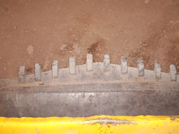

   / Markham Welding Tooth Bar ? #3
This /forums/images/graemlins/grin.gif??

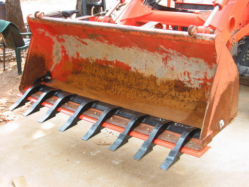

   / Markham Welding Tooth Bar ? #4
Or more like this?

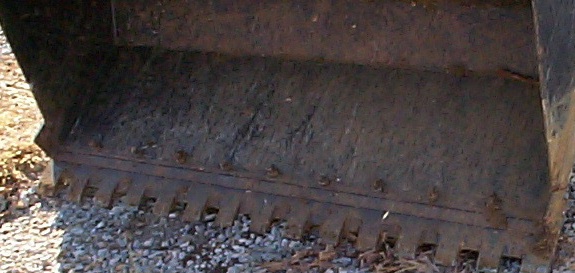

   / Markham Welding Tooth Bar ? #5
Or this?? /forums/images/graemlins/shocked.gif

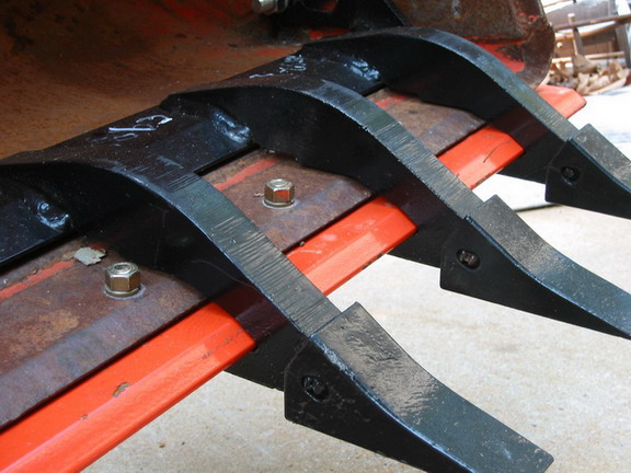

   / Markham Welding Tooth Bar ? #6
I have a toothbar on my HD bucket with a bolt on cutting edge. Mine is made by a company called FFC. It is "extra heavy duty".
My concerns were the same as yours. My bucket originally came with a bolt on edge, but it was among the missing when I purchased my tractor used. The weld on cutting edge is about 5"x9/16". The new bolt on edge is 5/8"x6". The bar of the toothbar is 3/4"x4" The bottom of my bucket is now very rigid.
   / Markham Welding Tooth Bar ? #7
I have no difficulty removing the toothbar even with the bolt on bolts. My bar is heavy, about 120 lbs. I remove the bolts, set the bucket on the ground and back up.
I believe there are 3-4 companies that make a toothbar that will fit a bucket with a bolt on edge. They will all make up the bar according to measurements you have taken of your bucket. As you can see, the shanks of my bar fit nicely on the bolt on cutting edge, then there is a step and the shank sits solidly on the weld on edge. The bar rests on the "wrap".
Toothbars for bolt on cutting edges will be more expensive than ones for a weld on edge. Hope this helps.
Pardon the orange. /forums/images/graemlins/wink.gif

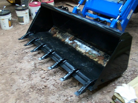

   / Markham Welding Tooth Bar ? #10
Deer hunter; I built my own just a carbon copy of the one IH3444 shows with 7 teeth. I bought the components ( teeth and shanks ) from the Cat dealer and a piece of 3/8 x 4" steel from a local steel yard. Total cost was less that $125.00 Weld with low hydrodgen rods. Two side bolts and the shank bottoms keep it in place. Weighs about #125. I figured the freight on a factory made bar would be close to the price of the materials involved. Two seasons old, no signs of stress.
