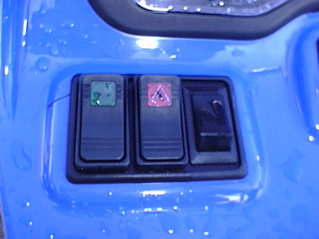

Re: Markie61\'s TC40D Photo Album
Switch for auxilliary lighting. Found at Lowe's for less than $4 and fits perfectly in knock-out. (It's the one on the right).

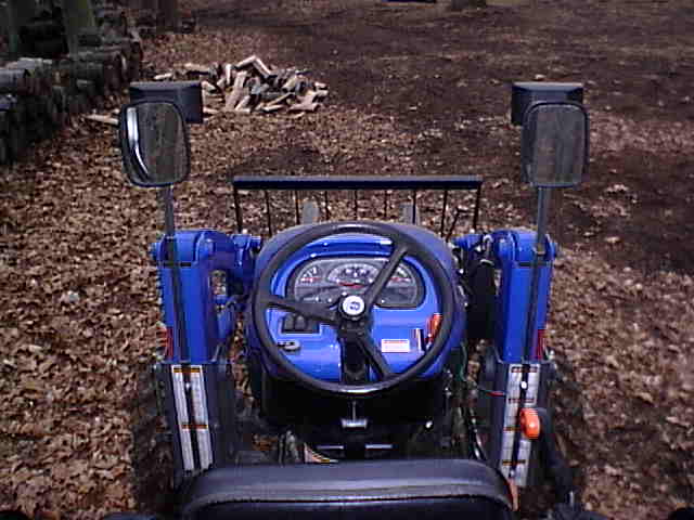

View of light/mirror stalks. 1" square tube mounted on loader uprights (holes already there).

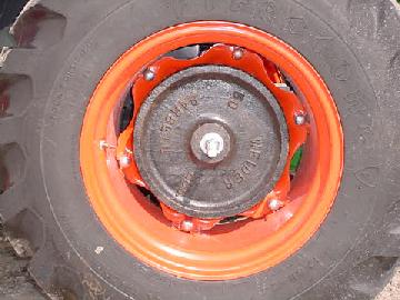

Markie:
I like your easyweights, they look just like the ones I made for my 5030. Of course I looked at the pictures of the easyweights before fabbing them.
They are a lot easier than factory weights since I take them off everytime I mow. I already have about 600lbs per tire of washer fluid. By removing the loader and weights, keeping my tire pressure to 15psi rear/16psi front, and taking it easy around corners I find that I am not tearing up the ground so much or leaving tire tracks.
Mark

</font><font color="blue" class="small">( They are a lot easier than factory weights since I take them off everytime I mow. I already have about 600lbs per tire of washer fluid. Mark )</font>
My owners manual for my TC33D says not to use both wheel weights and fluid filled tires at the same time. I know you have a bigger tractor but you may want to see what your manual says about using both.
Thanks. I checked before I added the EZWeights, but I checked again (once I hit 40, I don't remember everything like I used to .... /forums/images/graemlins/crazy.gif)
Manual says in bold print: "NOTE: Rear wheel weights can be used with liquid ballast."
Further, the charts say max wheel weight per wheel is 420lbs - I use 400lbs. So total ballast = appx. 1600lbs.

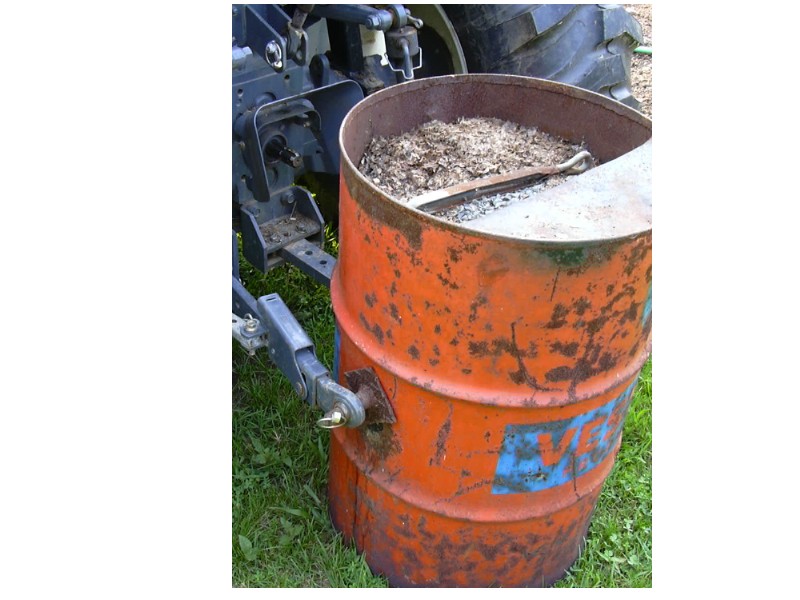

Here's a picture of the old counterweight. Just a drum with bluestone gravel in it. My father-in-law made it and it's been in the woods for years.....
Mark

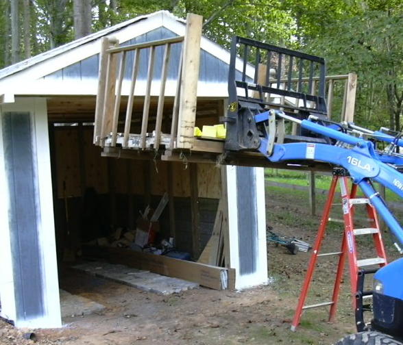

Had the camera out today and thought I'd add a couple pictures to my album. Here is the manlift I made to fit on my pallet forks. It's made from 2 pallets nailed together and some old porch railing, plus a new floor. I was using it to paint my new tractor shed. The base of the shed was an old sawdust pit - posts set in the ground with 3 walls of 2x10 nailed to them. I added uprights, a roof and walls.
Mark
